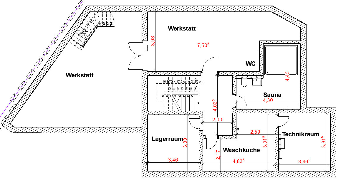

- Basement prepared for a possible sauna
- Large workshop

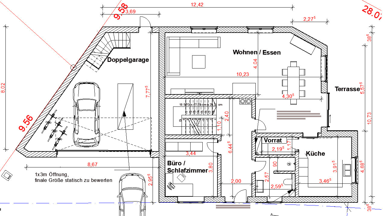

Hallway on the ground floor .. where should the coat rack for 4 to 5 people and possibly guests be located?
It is inconvenient to take bicycles out. Also, is it possible that the shared wall is longer than 9 m (30 feet)?
The garage staircase reduces the ground-level space in the garage for the lawnmower and similar items .. If the basement garage is also used as a workshop, isn’t it sufficient to access it from inside the house? Why is there such a large workshop space at all?
Ground floor office .. due to the door position, it is not very suitable as a proper bedroom.
Kitchen .. as mentioned, dimensions are missing, but I would definitely plan to include the window at the bottom of the plan.

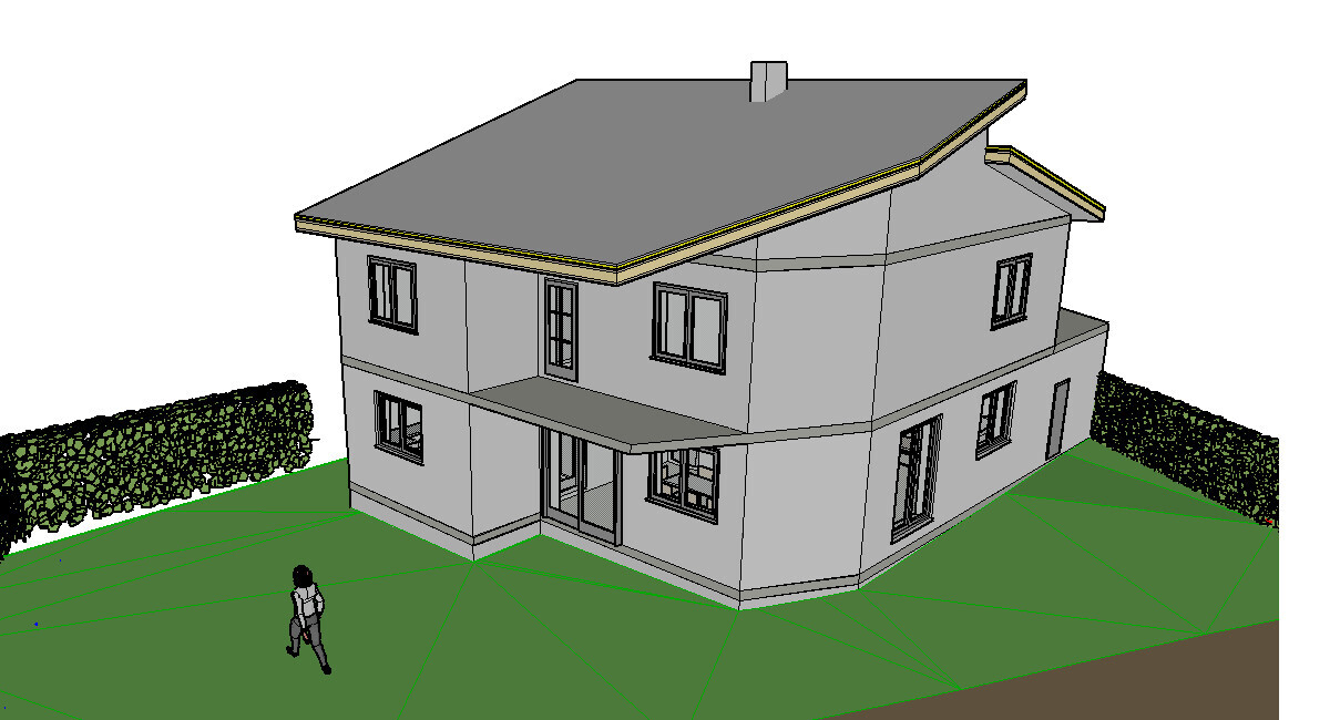

Why is there a chamfered (beveled) corner in the living area?
How is the roof supposed to look from the other side? Balcony and chamfered corner.

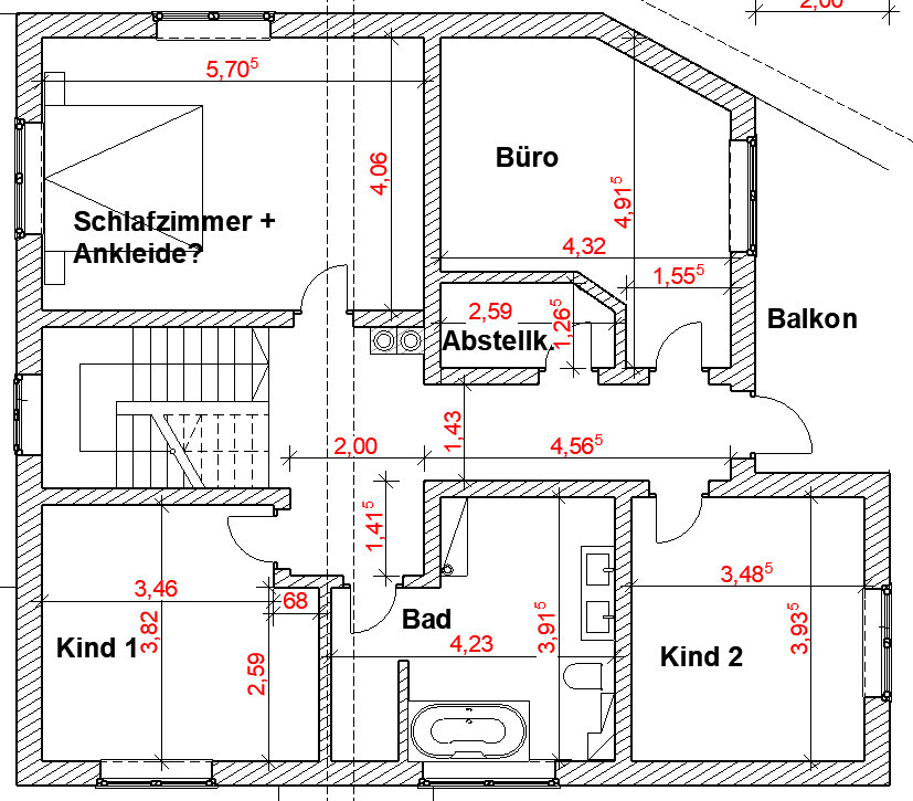

Bathroom on the upper floor .. it seems impractical to look directly into the shower niche when entering, and it could often be damp in front of it due to water coming out of the shower.

Furniture is not drawn to scale, at least the sofa, dining table, etc.

JKHandler10 Mar 2024 17:23kbt09 schrieb:
Unfortunately, interior wall dimensions are missing.
Hallway on the ground floor .. where should the wardrobe for 4 to 5 people and possibly guests go?Since the hallway is 2m (6.5 ft) wide, we planned to furnish it accordingly – or do you think this is too narrow?kbt09 schrieb:
It’s inconvenient to get the bicycles outside. And, could it be that the boundary wall is longer than 9m (29.5 ft)?We’ll take that into consideration, thanks!kbt09 schrieb:
The garage stairs reduce the ground-level space for lawnmower and similar equipment .. If the basement garage is a workshop, isn’t it enough to access it from inside the house? Why such a large workshop?There is quite a bit of workshop equipment to store and use. That’s why the garage was designed with a basement; otherwise, it wouldn’t make much sense. The stairs in the garage allow heavy items, tools, and materials to be brought into the workshop without having to go through the house.kbt09 schrieb:
Ground floor – office hardly suitable as a real bedroom due to door position.What would your suggestion be here? We thought to place the door as high as possible to separate it from the entrance/mudroom area.kbt09 schrieb:
Why the chamfered corner in the living area?To ensure a proper passage width between the north and south gardens. Otherwise, it would be too tight and disrupt the flow between these garden areas.kbt09 schrieb:
How should the roof look from the other side? Balcony and chamfered corner.Please see the attached pictures.kbt09 schrieb:
Bathroom upstairs .. rather impractical to look directly into the shower niche when entering; it might also often be damp in front due to stepping out of the shower.Thanks! We’ll take that into account.kbt09 schrieb:

Furniture is not drawn to scale, at least the sofa, dining table, etc.They should be to scale. The sofa is only shown as a large layout (2.5m x 3.5m (8 ft 2 in x 11 ft 6 in) drawn). The table length is 2.1m (6 ft 11 in) with chairs.Hmm ... how many square meters does that actually add up to? And what budget have you planned?
Regarding the kitchen... do you want it to run along the wall like that? And then the large opening in the middle?
The hallway might be 2 meters (6.6 feet) wide, but think about where you can realistically fit a 2-meter (6.6 feet) wardrobe in that space.

Since the hallway is 2m (6.5 feet) wide, we wanted to furnish it accordingly – or do you think that is too small?Again, no closet planned. Of course, a small dresser for handbags can be placed there.JKHandler schrieb:
It disrupts the flow between the north and south garden.There is no flow either. Not even with “abber” corner. I would rather call this a Feng Shui disaster; the partnership corner now has a flaw. But from the very beginning: Is there a reason why the budget hasn’t been disclosed? Do you not even know how much you can build? At least you set limits.JKHandler schrieb:
As small as possible, as large as necessaryI don’t see that anywhere: Almost everything could be somewhat smaller in relation to the mentioned “as large as necessary.” Somehow, nearly everything was planned not just slightly bigger. Or does that only apply to the hallways? The wall of the double garage exceeds the allowed 9-meter (30 feet) boundary building line; the hallway is exceptionally long, and there are two upstairs because one access route wasn’t possible in a kind of Tetris layout, which also resulted in a balcony. The living/dining area is very, very spacious at over 50 square meters (over 538 square feet), plus kitchen and utility room. The bedroom at over 24 square meters (over 258 square feet) could give up 10 square meters (about 108 square feet), and a properly laid out bathroom could be smaller than the children’s rooms.What is also noticeable: the utility rooms are just squeezed in. The office is a mutilated L-shape because a walk-in closet had to fit somewhere. On the ground floor, you have to walk around the pantry to enter it or reach the kitchen. Bathroom doors open into the shower. No access from the kitchen to the garden… These are the major flaws that make the house neither good nor functional. As for taste, for example, the wider side in relation to the house height or the emphasis on width through the roof angle, we don’t need to debate that. But it is quite obvious that “something wasn’t applied correctly” on the house facade.

The wall of the double garage is longer than the allowed 9 meters (30 feet) for boundary construction, the hallway is extraordinarily long; there are two upstairs because access wasn’t possible in the “Tetris” layout, which also resulted in a balcony.
The living/dining area is very generous at over 50 square meters (540 square feet), plus kitchen and utility room.
The bedroom, with over 24 square meters (260 square feet), could afford to give up 10 square meters (100 square feet), the bathroom could be smaller with a reasonable layout than the children’s rooms.
Another noticeable point: ancillary rooms are simply squeezed in. The office appears as a truncated L-shape because a storage room had to fit somewhere. On the ground floor, you have to walk around the pantry to access it or to reach the kitchen. Bathroom doors open into the shower. No direct access from the kitchen to the garden... These are the major flaws that make the house neither good nor functional.
