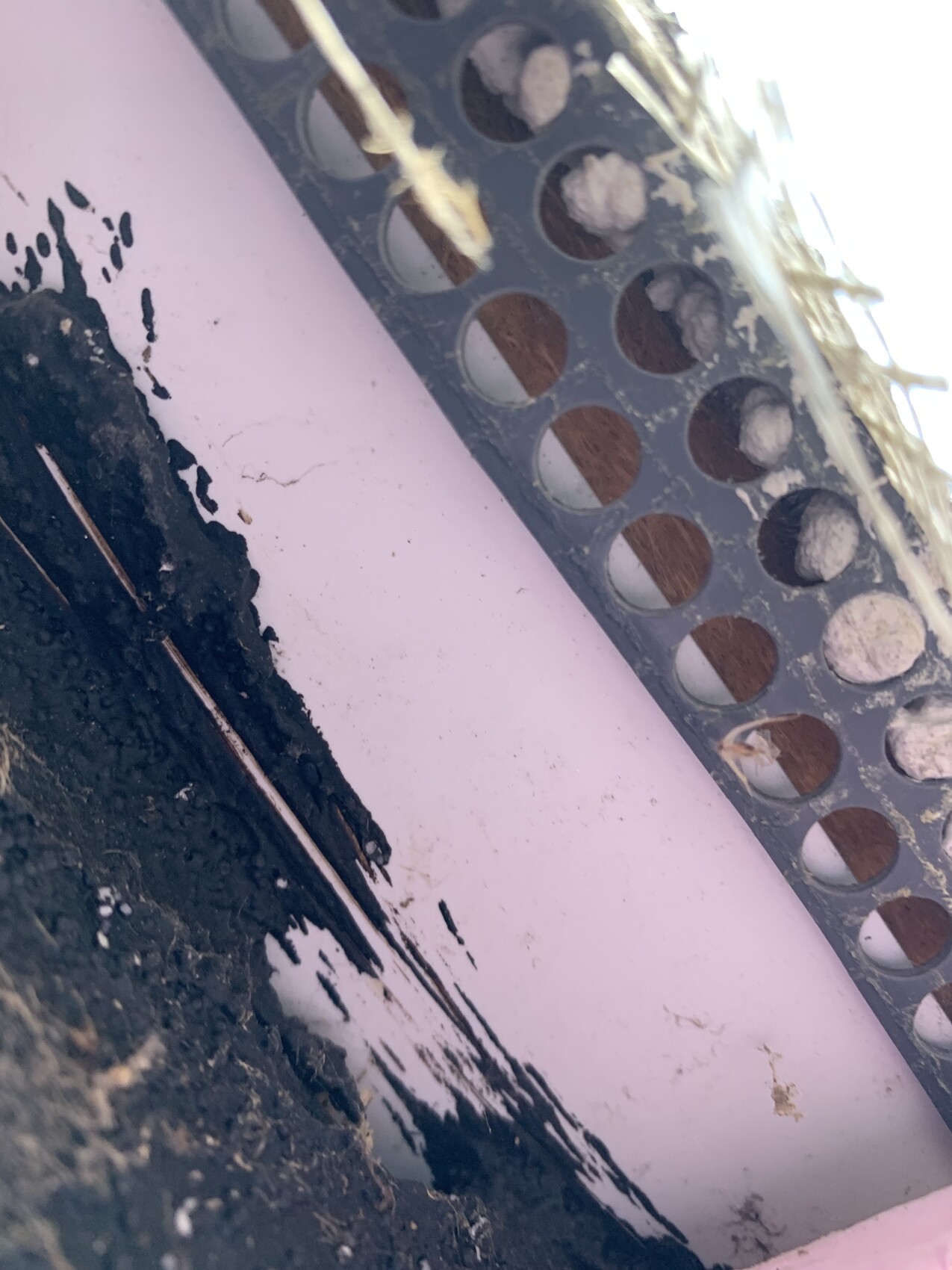

- The lower edge of the exterior wall is “open” – I am attaching a picture where I photographed upwards from the splash protection, showing the mesh at the lower edge before the rubber was installed. Behind the black rubber in the other pictures, this “openness” is still visible and from below the rubber is not sealed. I keep reading that the mesh wicks moisture capillary. So, it’s not just the gap between the foundation slab and the exterior wall, but also the lower edge of the exterior wall? If yes, how would one address this? I have read about base profiles, bitumen coating, or sealing tapes?
- Or does it have to remain open for ventilation, and is the rubber strip therefore actually wrong because it blocks air circulation?
- How can we solve this properly without constantly fearing that the wood fiber insulation behind the plaster will absorb moisture, rot, and ultimately damage the timber itself?

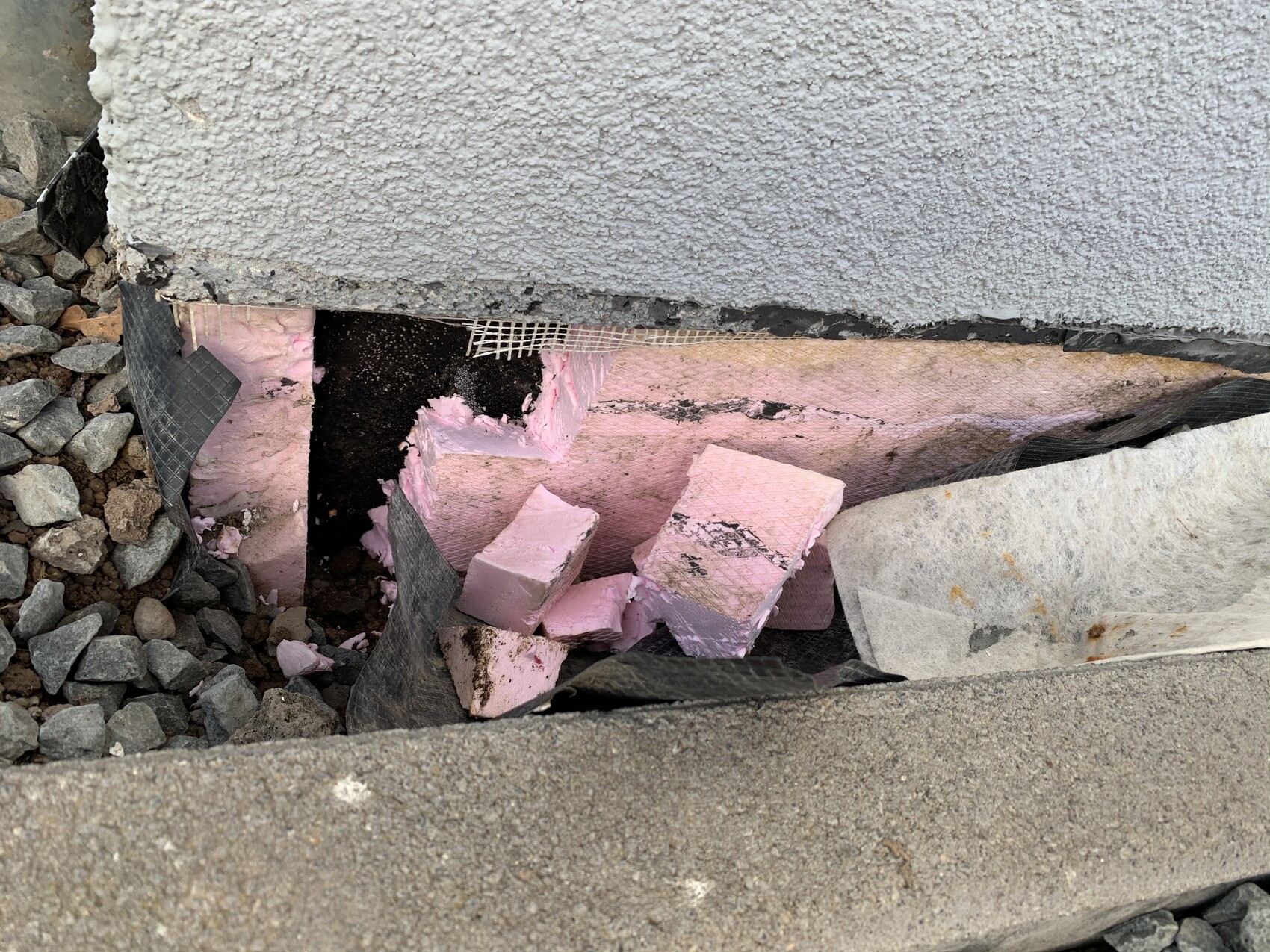

So the rubber only sticks on the top? That means it only protects against splash water. Ground moisture rising up at the base plate can still penetrate. That means the moisture protection near the base is missing (the exterior insulation and finish system should be coated with a moisture protection product from the manufacturer 5cm (2 inches) above the finished ground level).
You actually have two problems, both of which, in my opinion, are not solved by the curtain because it is not high enough. Also, bitumen is not UV resistant and therefore cannot be relied upon in direct sunlight.
The red board is already a type of Styrodur (extruded polystyrene).
If you remove the gravel strip and dismantle the curtain, then seal the gap well with Styrodur and coat everything with two layers of moisture protection, for example, a product called Flexyl from S T Obis, applied 5cm (2 inches) above the terrain—is that acceptable? This product can also be painted with facade paint, and every manufacturer offers similar products in their range.
Could this be a working but not overly expensive solution?
What do others think?
Of course, dismantling and reconstructing the base according to standards is the optimal solution, but we are looking for a practical compromise, right?

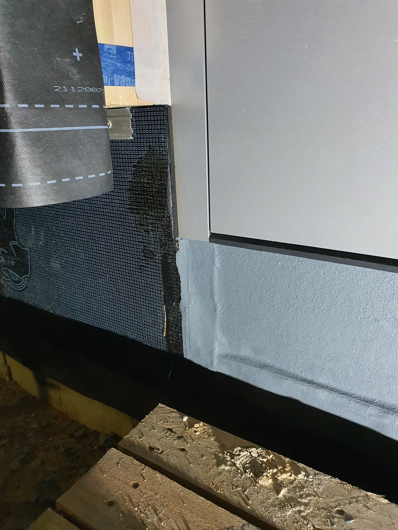

knalltüte25 Feb 2021 22:14Unfortunately, I can’t fully answer your question, but just today our roofer was here and sealed the perimeter area. The thing is, when you’re building a timber frame house with exterior wood/fiber insulation (ETICS), you’re not just building a wall back—you’re building the whole house back! That’s why a thorough moisture barrier is so important in this area. Of course, it starts with structural protection. The “feet” of the house shouldn’t be standing in “dirt.” Drainage plus a gravel bed around the base already helps a lot.
Here are some pictures from today. The lower black area visible in the first picture, from about the wooden batten down to the insulation underneath the bitumen membrane, will be insulated with 30cm (12 inches) XPS perimeter insulation, sealed again, and covered with base plaster. The thin black foil at the top is only a temporary weather protection for the facade until the plasterer arrives.

Emptying and lowering the splash guard on the terrain and removing the rubber strip hanging in front of it are definitely two things we will do in the short term.
When sealing, it would probably be best to remove the Styrodur insulation at the floor slab in order to better seal the transition between the floor slab and the exterior wall.
Our only concern is that if we seal it properly, it might actually be incorrect because it may need to be ventilated and could then become too airtight. However, the company Opitz, which provides the system, states that no ventilation is planned and that it is a closed system, although the external thermal insulation composite system (ETICS) is of course the builder’s responsibility...

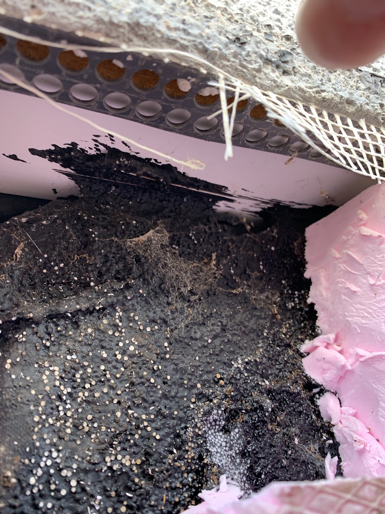

I also took a look behind the Styrodur at the floor slab yesterday. There you can see that at the bottom edge of the exterior wall there is first a white base strip (probably the bottom of the timber structure), then below that a wood fiber insulation board, a perforated strip, and the visible reinforcement mesh (where moisture probably enters and currently is nicely held like in a sauna by the rubber).
The biggest problem is really knowing: What is right and what is wrong? If we invest money now, we don’t want to regret it in 2-3 years and find out it was done incorrectly.

Why do people actually install ventilation grilles?That’s not a ventilation grille, is it? I see a corner bead with mesh there, which should have been covered with reinforcing mortar. It would be even better to have a profile with a drip edge installed.
