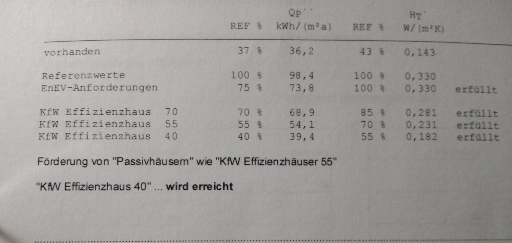

I received the thermal insulation certificate today... As mentioned, we ordered and requested KFW 55 on our side.
With the 80 mm (3 inch) Styrodur recommended by the builder underneath the slab, we are now achieving KFW 40.
Option A:
I now have the following choices: completely omit the Styrodur, receive a discount of almost €2200 for removing the originally offered 100 mm (4 inch) Styrodur beneath the slab, and possibly reach KFW 55 or slightly worse, accepting the resulting heating costs.
Option B:
I am happy with KFW 40 and correspondingly lower heating costs, as well as the price reduction for 80 mm (3 inch) Styrodur compared to 100 mm (4 inch) Styrodur – although I do not yet know the exact amount, which probably won’t be very impressive.
Option C:
I keep everything as originally planned with the 100 mm (4 inch) Styrodur, which will perform better than KFW 40, but I will never know exactly by how much (because a new thermal insulation certificate would need to be created, which nobody does for free), and I likely won’t notice any savings in heating costs since there is no comparison...
Option A:
Option B:
Option C:
I would also lean towards KfW40. Are you using the KfW program for financing? Then you would already have a €5000 (about $5350) higher repayment subsidy compared to KfW55. If a photovoltaic system is planned, it’s also worth considering KfW40+, which offers another €5000 (about $5350) extra, and the battery storage, which otherwise might not be very cost-effective, is almost paid for. Photovoltaics are generally worthwhile anyway.
