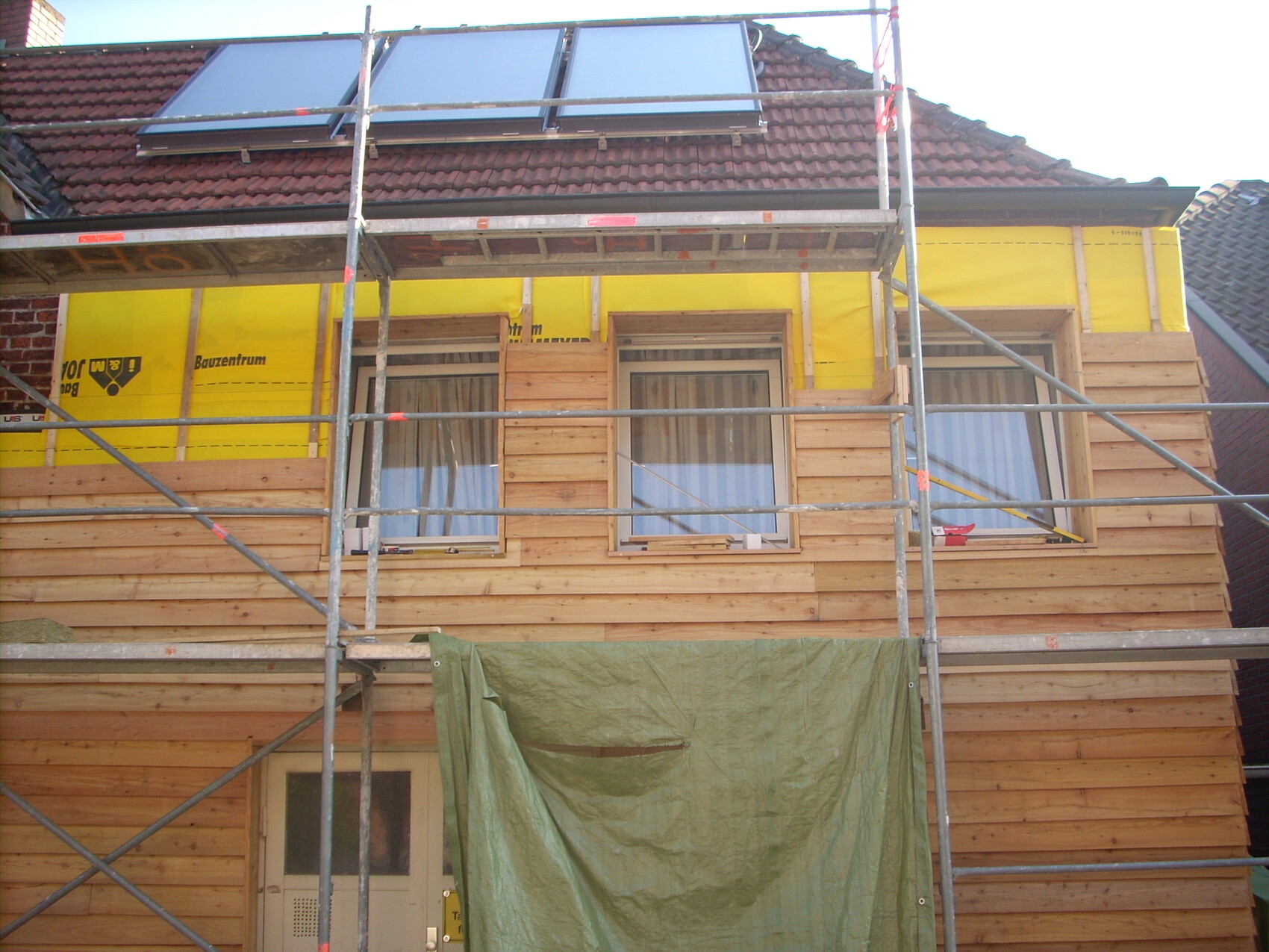

well, relatively happy. About 15 years ago, I installed a timber rainscreen facade myself. Approximately 100m² (1,076 sq ft) of facade area with larch clapboard siding. I mounted 10cm (4 inches) squared timber battens on partly soft-fired bricks (270-year-old house) and placed 10cm (4 inches) of mineral wool insulation in between. Above that, a facade membrane (roof underlay membrane?).
Since then, the facade has required no maintenance; the larch has weathered gracefully and still looks decent (it looked fantastic when new!).
For the window reveals (insulation), I used 5mm (0.2 inches) thick neoprene foam due to limited space. At the bottom, pest protection was installed using perforated aluminum sheet.
There should still be some pictures of this somewhere on the forum unless they were deleted.
Today, I would do it a bit more professionally (or hire someone to do so). Back then, it was barely affordable for me, using leftover or special-order battens, larch in exchange deals ;-), and insulation as offcuts (had to piece it together anyway due to the complicated facade).
If I were to do it today (like a gable on the same house), I would install vertical boarding as a base and top cladding instead of horizontal clapboards. I would provide better ventilation behind the facade and use slightly thicker insulation if possible. The facade membrane would be applied more precisely, and I might combine it with other measures (at the time, I also replaced a very old oil heating system with a condensing boiler, added solar thermal panels, and installed a separate solar storage tank). That used up most of my budget back then.
But ultimately, my somewhat amateurish facade still looks okay and works without any maintenance. I also expect it to remain largely unchanged for another 10 years, which doesn’t really matter to me since the house is sold as of December 15th.

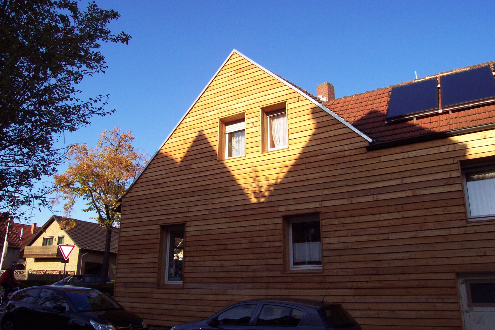

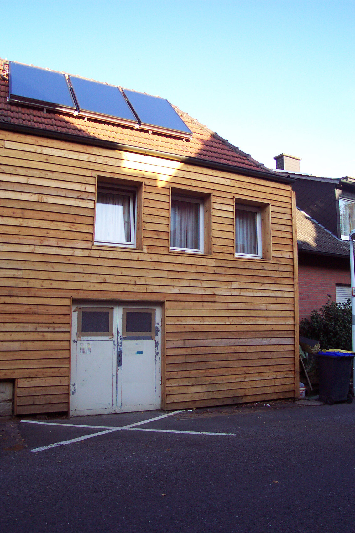

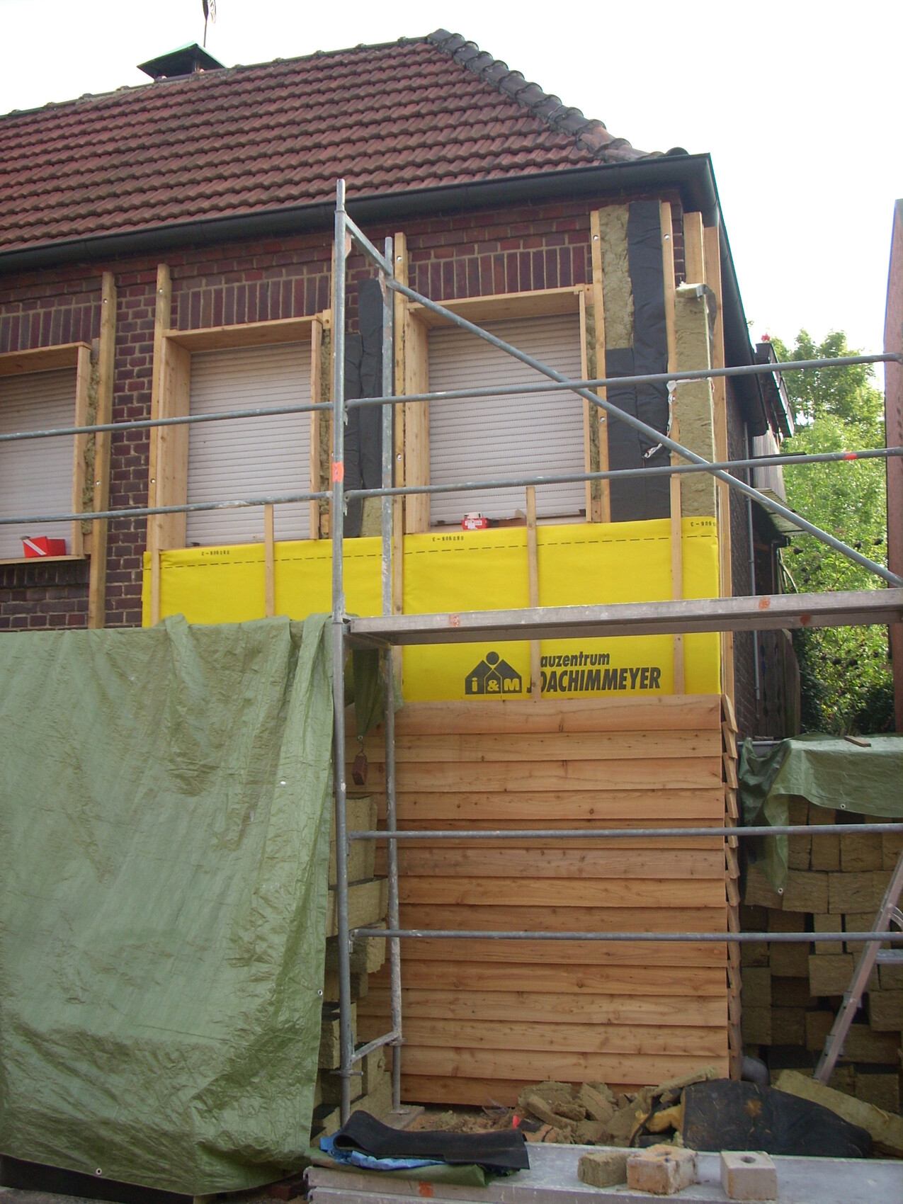

I just found the folder with the pictures ;-)
Maybe they’ll help you with your decision.
The last picture shows the freshly painted door...
Brutal work in the middle of summer wearing a full-body suit and mask.
Sweat and mineral wool fibers—well, you can imagine how well that goes together :-(
Usually handling each 5m (16 ft) long board alone, sliding it over an "Erika" tool to undercut it for the drip edge.
Installing from above was impossible for me due to severe fear of heights and was only doable with the support of family and friends (many thanks again!)

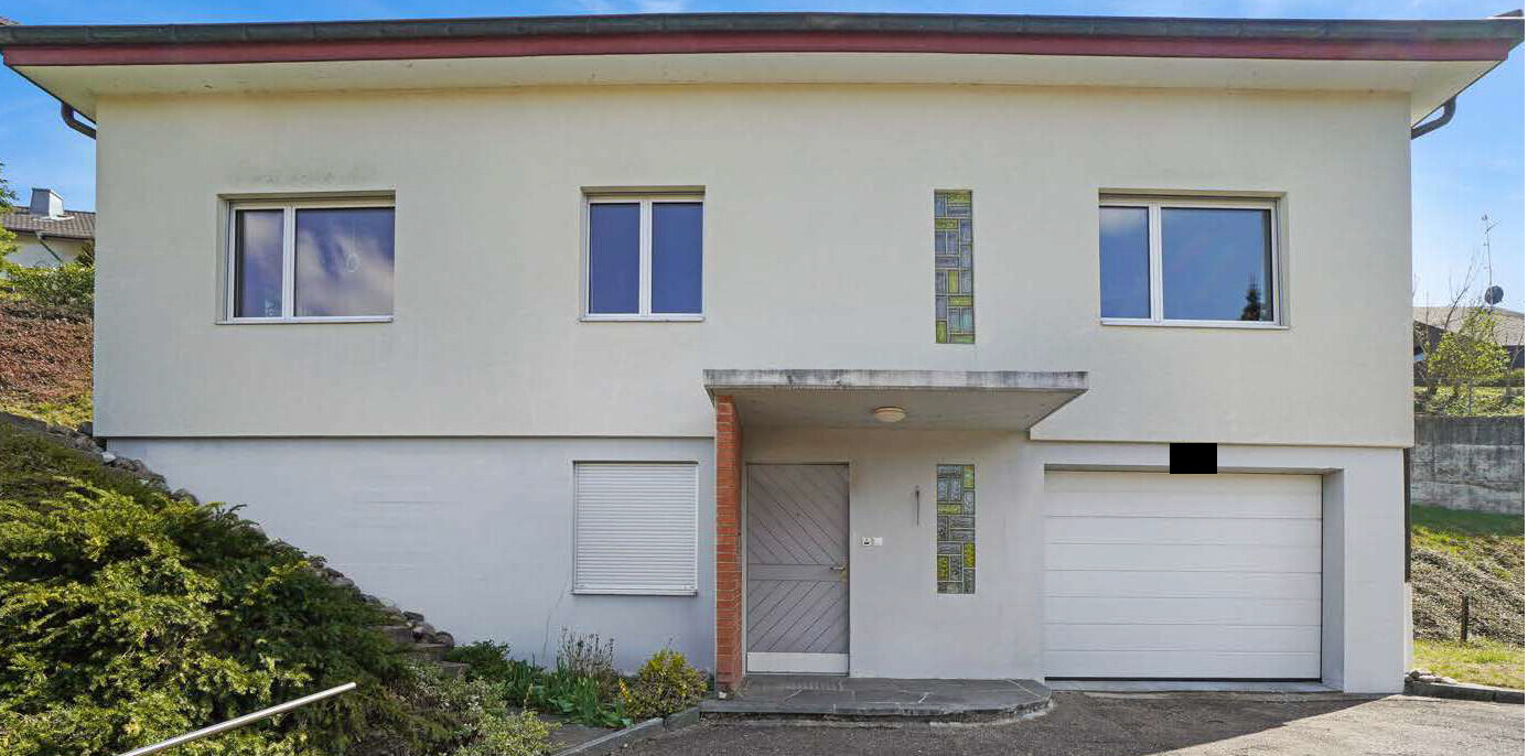

This is the west-facing front view / entrance area with the problematic construction spot, also known as the "thermal bridge" old porch roof.
The structure is reinforced, and cutting it out to replace it with a new aluminum porch roof is not easy and expensive. I have also been considering replacing the glass blocks with frosted glass or simply adding insulation over them, but then there would be no natural light in the stairwell.
The total facade area is about 200 m² (2,150 sq ft). The house is 12.8 m (42 feet) long (the west side is the longer side) and 9 m (30 feet) wide, with a strip foundation (basement level but no cellar).
