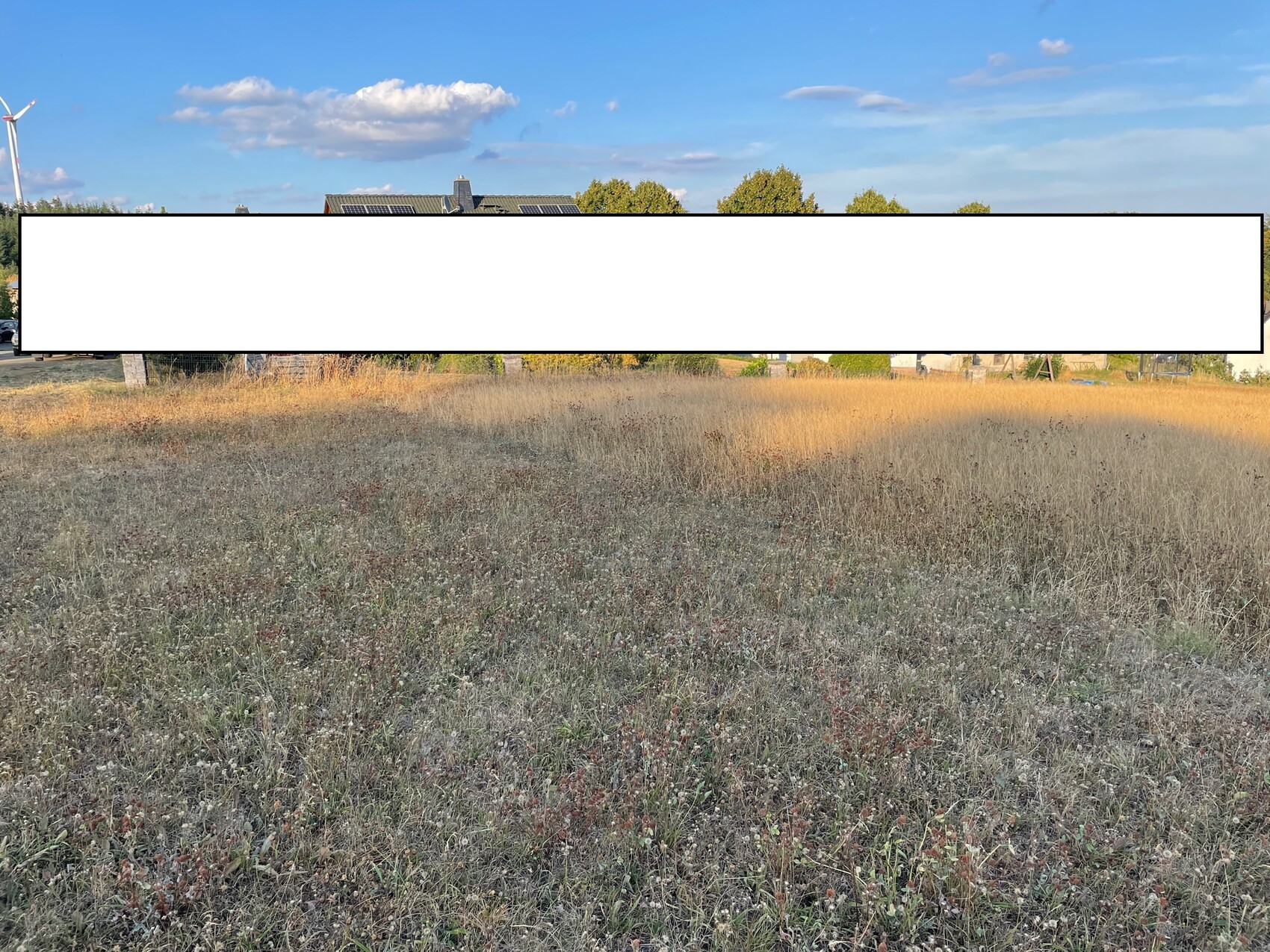

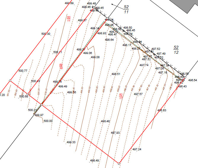

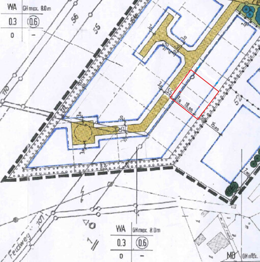

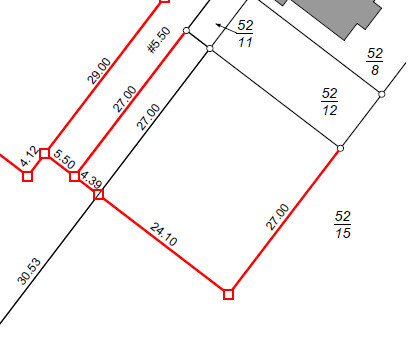

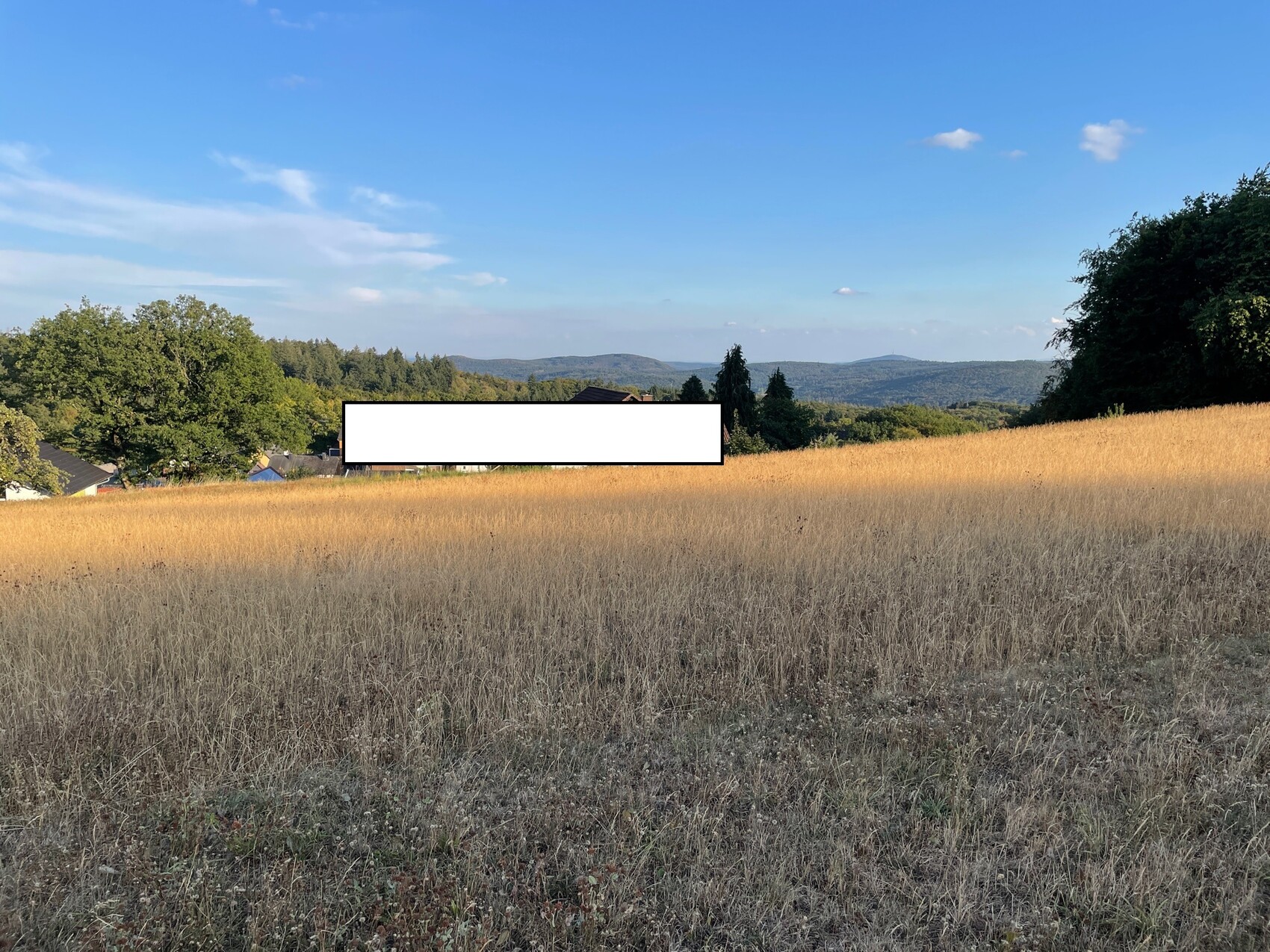

Hello everyone, attached you will find the requested information. I hope it helps with the assessment. It’s always interesting how easy it is to misjudge. In the photos and even in reality, the slope appears less steep than 4m (13 feet) along the diagonal.

hanghaus2023
20 Jan 2023 20:32
Thank you for the documents. Is there no reference point for the building height?
I’m looking forward to seeing the architect’s design.
Dachshund90
20 Jan 2023 23:57
I am currently trying to determine the reference point precisely… the neighbors’ statement is only that it is “based on the average of the original elevation survey.”
