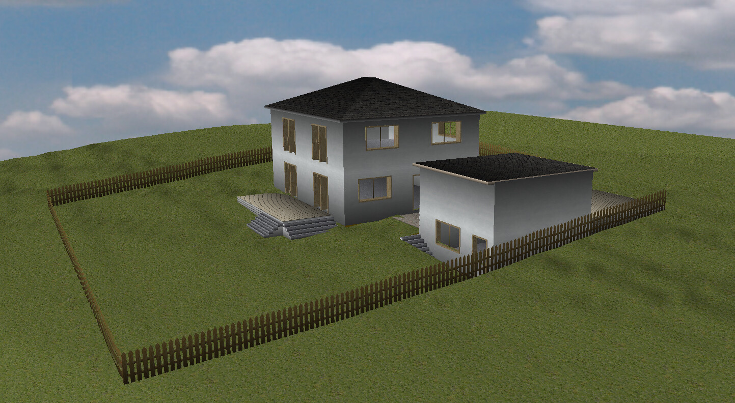

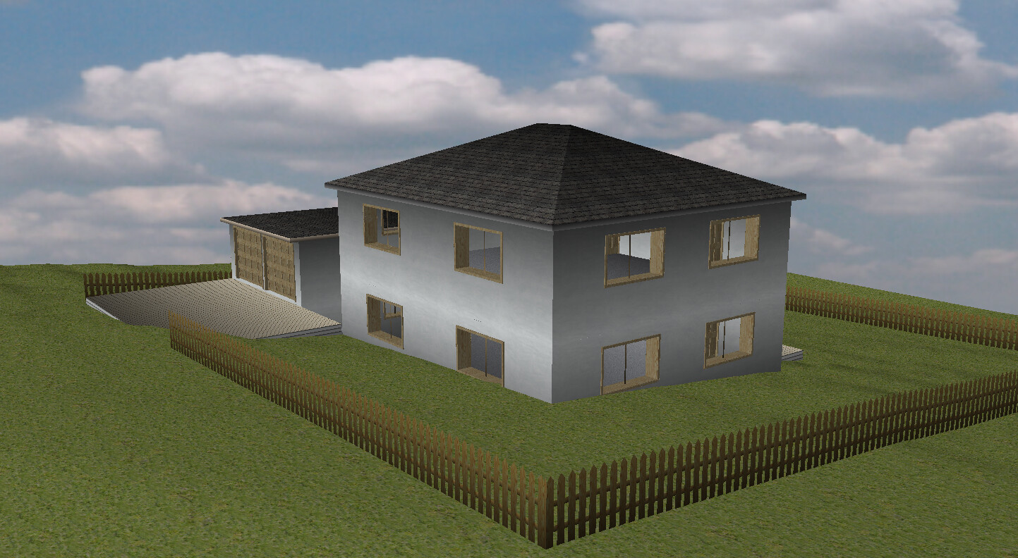

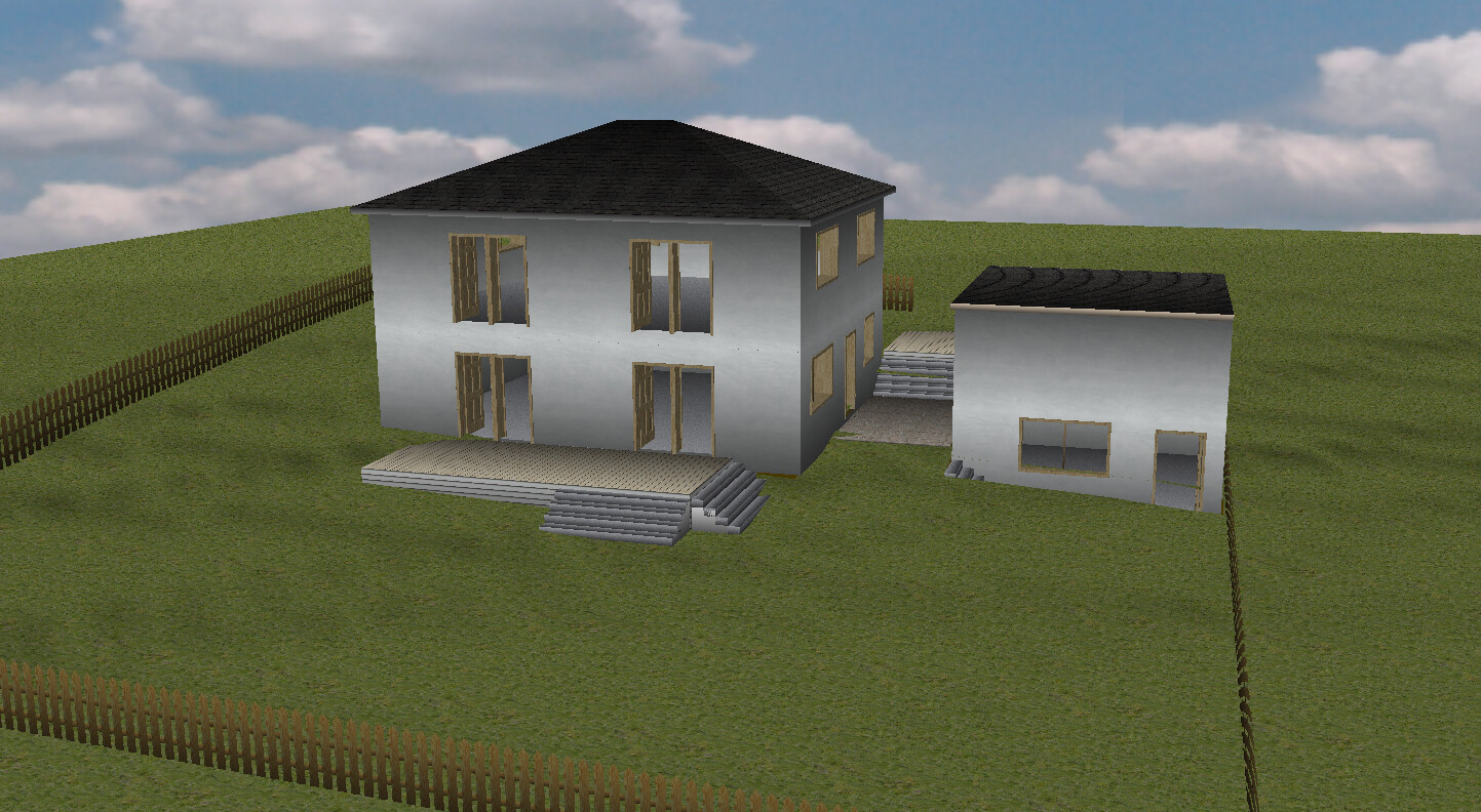

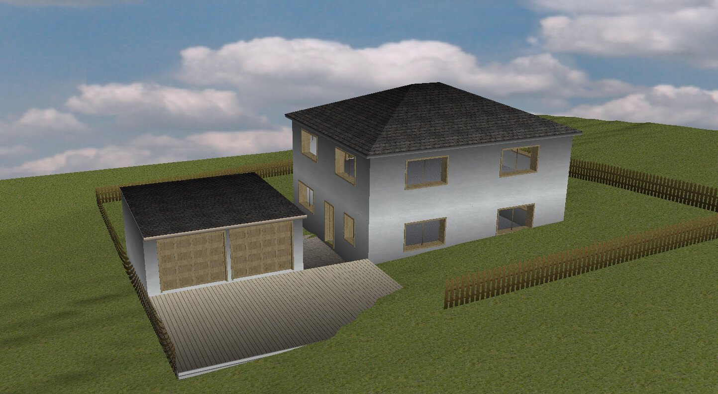

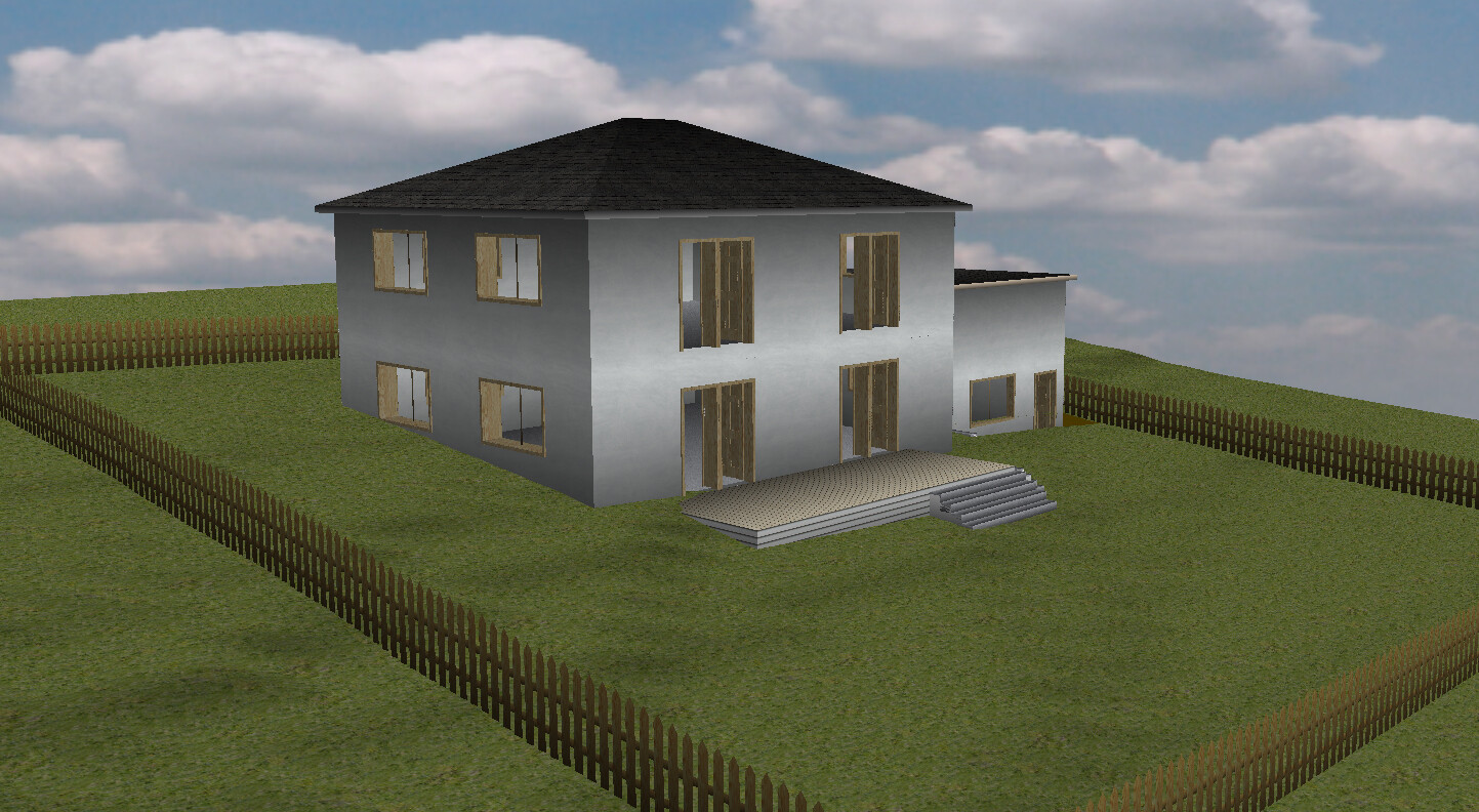

K a t j a21 Jan 2023 11:33
Here is a rough sketch of the elevation levels. I usually see fewer issues with the house itself. The slope side is partially embedded into the ground – so what? There is still enough height for windows, and the utility room needs to go somewhere anyway.
In my opinion, the parking spaces are more challenging. It’s difficult to drive down a staircase. Here, I can more easily imagine something like a basement or a storage area for equipment or bicycles underneath.

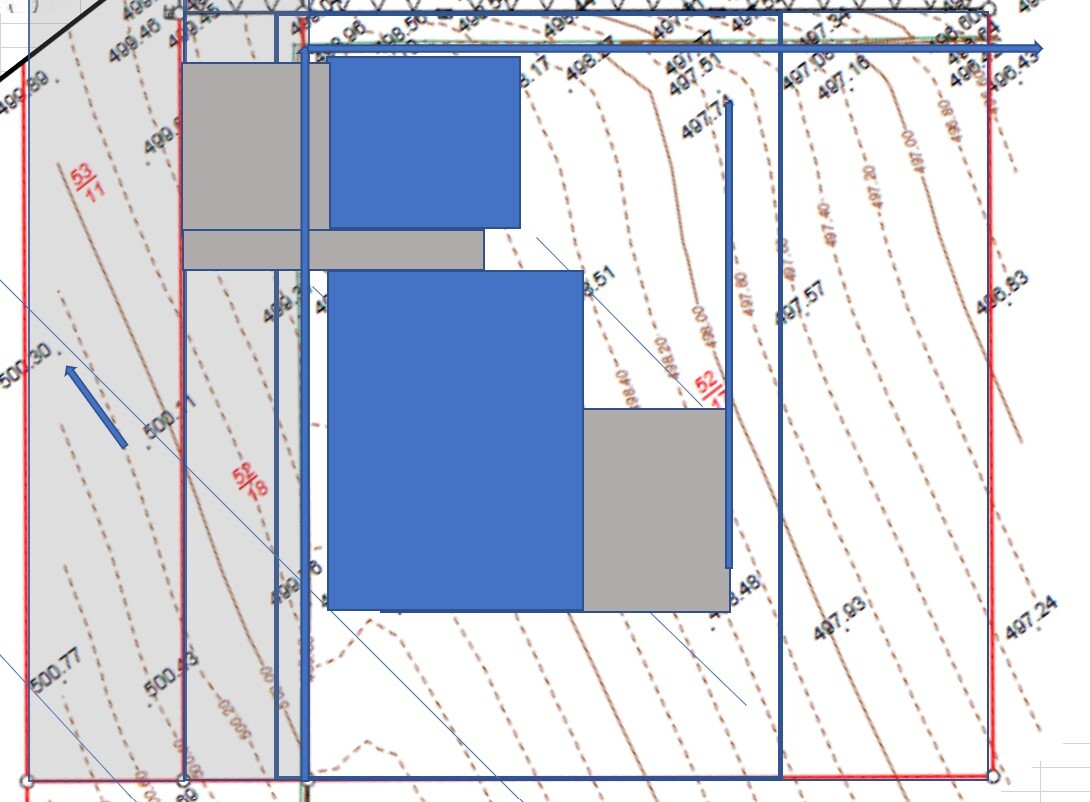

hanghaus2023
21 Jan 2023 12:38
How should the trench be handled? According to the contour lines, it should follow the path of the blue arrow. I wouldn’t place a garage on it. Or should it be redirected?
