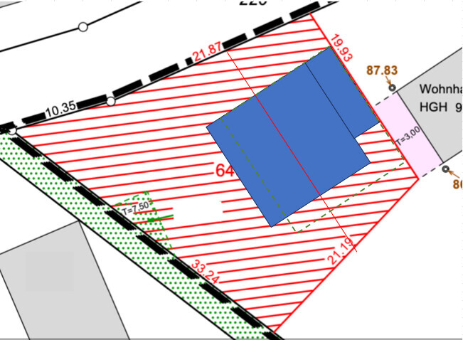

Plot size: 650m2 (7000 sq ft approx.)
Slope: Yes, gentle (scale 1:250, see elevation in attachment; 1m (3.3 ft) over approx. 10x11m)
Floor area ratio (FAR): No formal development plan, approx. 220m2 (2368 sq ft) floor area possible after approval by building authority
Building coverage ratio: No formal plan, approx. 220m2 (2368 sq ft) floor area possible
Building setback lines and boundaries:
- 5m (16 ft) from the street
- 3m (10 ft) from neighboring properties
Edge building: On both sides and opposite along the street
Number of parking spaces: Probably 3 required (we could move the house back so parking is directly in front)

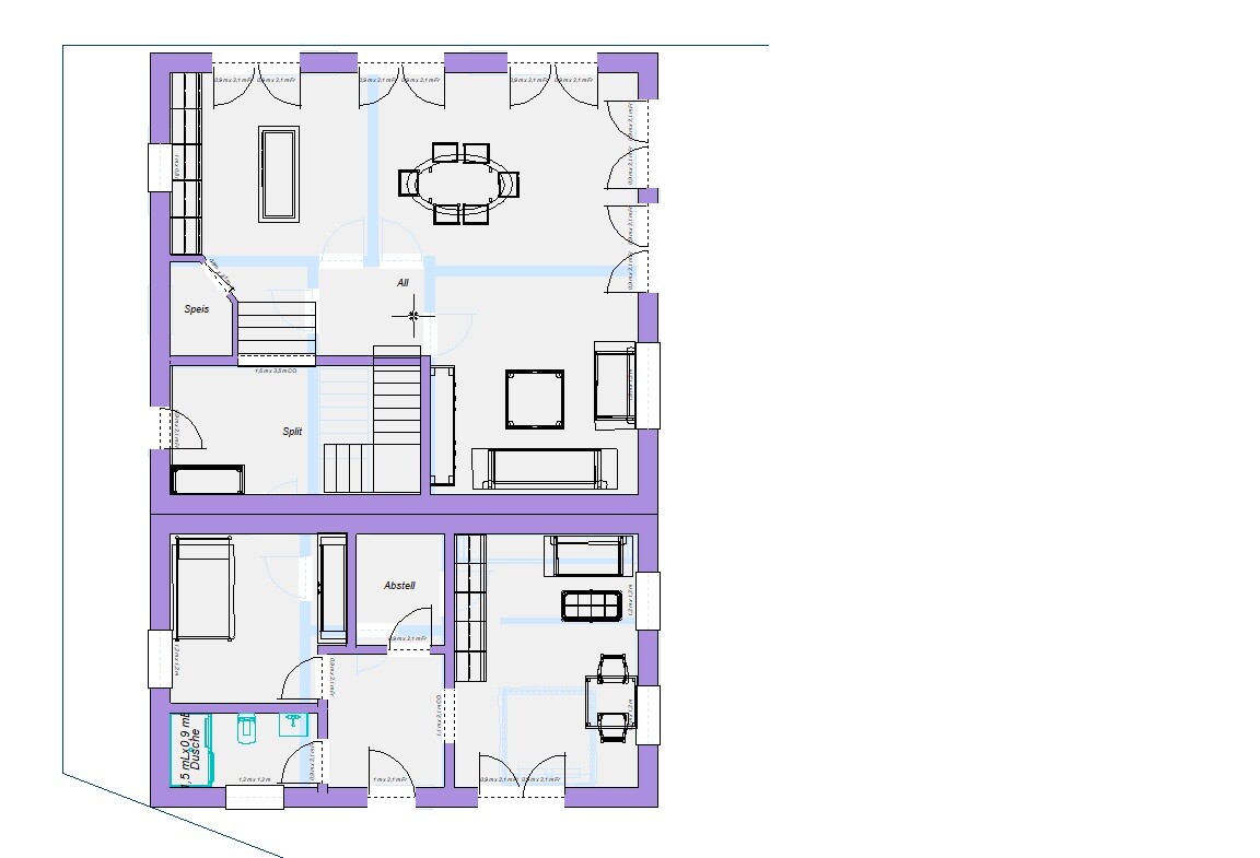

What do you particularly like and why?
- The ground floor overall; many wishes fulfilled, some highlights
- Bedroom and walk-in closet; probably adding a door in between later
- Landing staircase, view axis, kitchen windows, entrance hall
What do you dislike and why?
- GF office faces southwest instead of east or southeast
- GF living room: fixed glazing towards southwest too small
- GF living room: lift-and-slide door too large, couch doesn’t fit well
- GF living room: considering glazing the entire wall
- GF corridor quite long
- UF sizes depend on GF; rooms (except bedroom and closet) are rather large
- UF bedroom faces southwest instead of north
- UF considering all windows floor-to-ceiling except stair and landing for light and appearance
- Garage not directly attached to house due to access to separate apartment
- Separate apartment quite complex
- Initially we drafted an "L-shaped" house similar to post here, but could not solve circulation areas properly; currently seeing them as a “necessary evil.”

hanghaus202330 Dec 2024 19:36hanghaus2023 schrieb:
I have sketched a house measuring 12 x 12 m (suitable for a granny flat on the ground floor) on the plot. Without splitting, the layout becomes quite challenging at this size, I think.
Here is a first idea for the split option:
The building footprint here is 15.5 x 10.5 m (51 x 34.5 ft) – there is certainly room to save some centimeters (inches) here.
I will continue from the previous floor plan.
Yes, the basement variant. The basement becomes the lower ground floor, as I explained yesterday: a gentle adjustment towards the eastern edge of the plot. The open plan area of the main apartment could be located there.
On the ground floor, there is the entrance and the parents’ level (bedroom, bathroom, office, and walk-in closet).
Between the main apartment and the street is the separate flat, designed to be airy and on one level.
On the upper floor are the children’s rooms and the utility room—or possibly a hobby room or similar. All of this with a staggered pitched roof, as a modern style was requested.
My software does not support slopes, so just take this as inspiration and a starting point for your imagination, since it is not as extreme as it appears here.
The only more complex or costly elements would actually be the offset of the ground floor and the staggered pitched roof. However, visually these always look more elaborate than they actually cost.

I sketched a 12 by 12 meter (39 by 39 feet) house (suitable for basement apartment on the ground floor) onto the property. Compared to your space requirements, the 12 by 12 meter (39 by 39 feet) house looks better. The upper floor can then definitely be smaller—or not, as you save the basement.
ypg schrieb:A huge thank you in advance to everyone who starts drawing here. I have no idea how much work that takes, but it costs time and brainpower. That’s not a given.
I’ll pick up on the previous floor plan.
Yes, the basement variant. The cellar becomes the lower ground floor, exactly as I explained yesterday: a gentle adjustment to the eastern edge of the property. The main living area of the main apartment could be located there.
The entrance and the parent’s floor (bedroom, bath, office, and storage) are on the ground floor.
If I understand correctly, the main living area is now in the semi-basement, where the biggest criticism of the basement apartment existed before. That would put the best southwest side for bedroom and office, which we do not want.

Without a split-level, it is already tricky to arrange the space at this size, I think.
Here is a first idea for the split-level option:
The building footprint is about 15.5 by 10.5 meters (51 by 34 feet)—though I’m sure a few centimeters could be saved.
At 15.5 by 10.5 meters (51 by 34 feet) × 2 floors × 0.8 efficiency × 3400 USD/m² (square meter), I come to 885,000 USD. At 3200 USD/m², that would be about 833,000 USD. That is clearly above our budget. I absolutely cannot estimate what the split-level design costs. Also, we would probably need two roofs.
Visually, we don’t like the design at all. Substantively, you were criticized a lot for the kitchen not being on the terrace side. Maybe that could still be changed here, but then you would have to go through the living room with every shopping trip and for every little thing from the kitchen.
Basically, however, with this variant and the different heights and roof types, we might take up the flat roof option again. That could completely change the appearance.

With a split-level design, there is no excavation at the terraces, since the split ideally follows the slope of the hill exactly.
Regarding the size of the draft, I already mentioned that the sketch has not yet been optimized. It can still be made noticeably smaller without losing quality. However, I don’t optimize sketches that are not really considered, because that would be real work. So, for now, there is just the preliminary draft to capture ideas—let alone the appearance.
I’m missing a few details in your calculations as well. The key factor for the height differences is first and foremost the slope within the building plot. That means roughly the 11m (36 feet) length of the house plus some meters around it. Even with generous estimation, I come to less than 1m (39 inches) height difference. With a 3m (10 feet) floor height, you’re always missing at least 2m (78 inches) in height for a full floor with patio doors. If you raise House 80, there will still be 1.20m (47 inches) of soil underneath. With a 30cm (12 inches) floor structure, the basement windows with 90cm (35 inches) window sills would be right at ground level. But where exactly would your garden exit on the ground floor be? Somewhere at 80 + 50 = 130 cm (51 inches) above ground level? Then you’d probably want to add fill material, which you would also have to retain.
We haven’t even talked about heavy rain and drainage in that “hole” you want to dig in front of the granny flat, and that already gives me a bit of a chill.
You will definitely need to create a model here. That’s just part of dealing with a slope. But there is still a difference between excavating and retaining the entire property and only a part of it.
