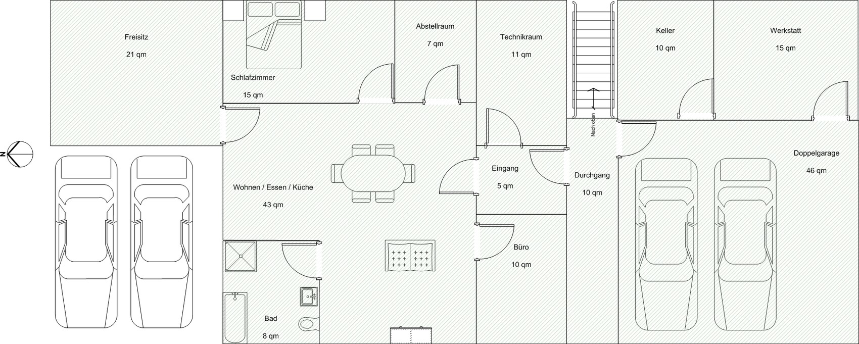

Since no one has responded yet, possibly due to the text being too long or unclear, here are the questions in a clear format:
1. Is there a better location for placing the house and the double garage? (I don’t think so because of the narrow, elongated shape of the plot)
2. Does anyone have a better idea for the layout of the bathroom in the ground floor granny flat?
3. Does the room arrangement on the first and second floors (single-family house) work well with the directions of the compass?
Is there anything missing, or is it simply too early in the planning stage for answers?

Well, if only something could be properly assigned. And if one knew why a 10 m (33 ft) wide house can fit on a 13 m (43 ft) wide plot. What about the usual minimum distance of 3 m (10 ft) on each side? Can the garage be this close to the street?
And if one knew who is supposed to live in such a dark basement apartment. A bedroom without a window? A bathroom accessible only through the living room? Only western light? Who would rent that?
I understand correctly that the ground floor on the east side is basically built into the slope.
Why not simply place the workshop, storage, and utility rooms on the ground floor in the windowless area, and then have an entrance with a spacious wardrobe and a guest/hobby-sports room with a west-facing window?
And then just have generous floors above.

Sorry for the confusion. The two building elevations show the demolition building and are intended only to reflect the slope of the terrain.
Unfortunately, I didn’t notice that the images were renamed during the upload.
Image 1 = 1st floor detached house (or ground floor from the slope side)
Image 2 = 2nd floor detached house
Image 3 = Ground floor with granny flat, utility room, and attic

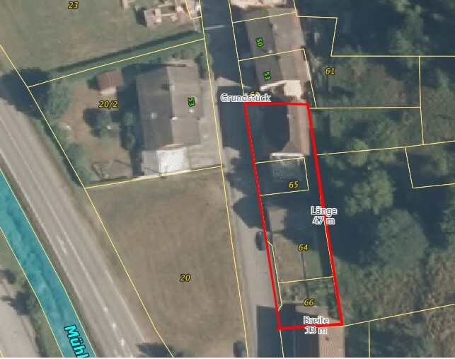

Image 4 = Plot of land
Image 5 = Aerial view with plot dimensions

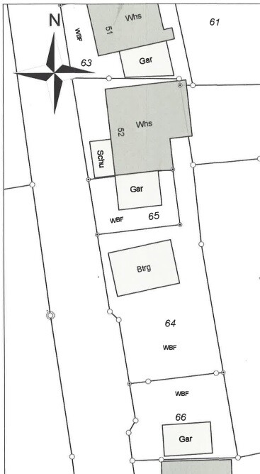

Image 7 = Elevation of the old building south
Image 8 = Site plan of the old building (parcel numbers 64, 65, and 66 are included)
