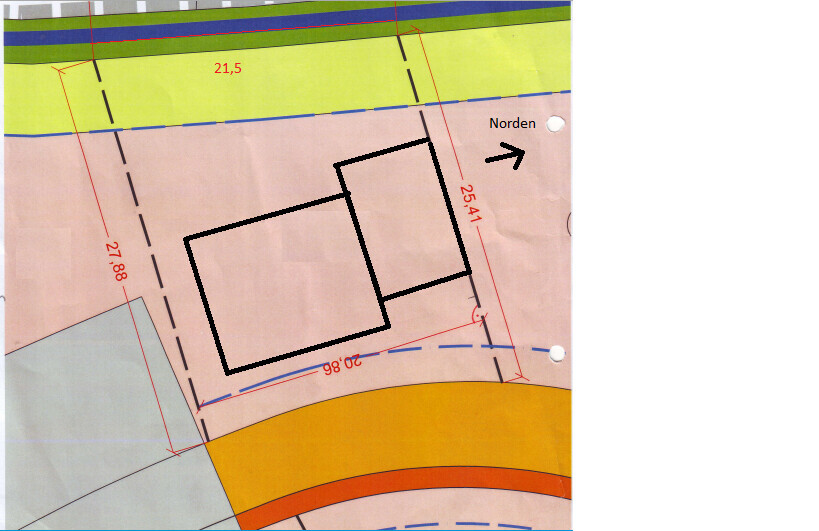

we need help planning our house. We have purchased a 540 sqm (5810 sq ft) plot and want to build a single-family home with a basement, two full floors, and a double garage. Unfortunately, I couldn’t attach PDFs, but I hope the quality of the mysweethome snapshot is sufficient.
Details on the floor plan below...
Development plan/restrictions:
Plot size: 540 sqm (5810 sq ft)
Slope: no
Site coverage ratio: 0.4
Floor area ratio: 0.6
Building line, building boundary, and building zone: see plan
Edge development: detached housing
Number of floors: no restriction
Maximum height: 8.5 m (natural ground to ridge)
A 5 m (16 ft) wide protected buffer zone along the water must be planted and cannot be built on.

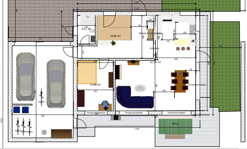

The current design is our own. After visiting many show homes and working through various planning drafts, we gradually became clear about what we want. The current design incorporates the above wishes.
What do we not like? Why?
  • Where could shelves be integrated in the living area?
  • Is the size of the dining and living area proportionate to the house?
  • The hallway on the ground floor is quite wide – seems like wasted space
  • It would be nice if the living room felt a bit more separated
If you had to give up some details/extensions, which ones would they be?
  • Pantry (we haven’t managed to integrate it yet)
  • Half-landing staircase is practical and attractive but takes up a lot of space (alternative: straight staircase or two-flight angled staircase)
  • Kitchen orientation facing the street
What we cannot do without:
  • Direct access from the garage
- Living/dining area should be spacious and feel open
- We do not want a kitchen-dining-living corridor; the living room should be somewhat separated/offset.
Why did the design turn out this way?
Optimal use of the plot, placing the double garage and house towards the street to have enough garden space at the back. Kitchen faces the street, living and dining area face the garden/terrace. Simple house shape (no bay window because of the waterproof basement “black tank,” cost savings, etc.). After much trial and error, this layout made the most sense.
Are there other options to meet our requirements? What are the main criticisms or improvement suggestions for the current design?
Site plan: two rectangular buildings, north arrow, plot boundaries, and dimensions.
Floor plan of a house with double garage, living and dining area, terrace, and garden.
Floor plan of a home with several bedrooms, dressing room, library, bathroom, and hallway.

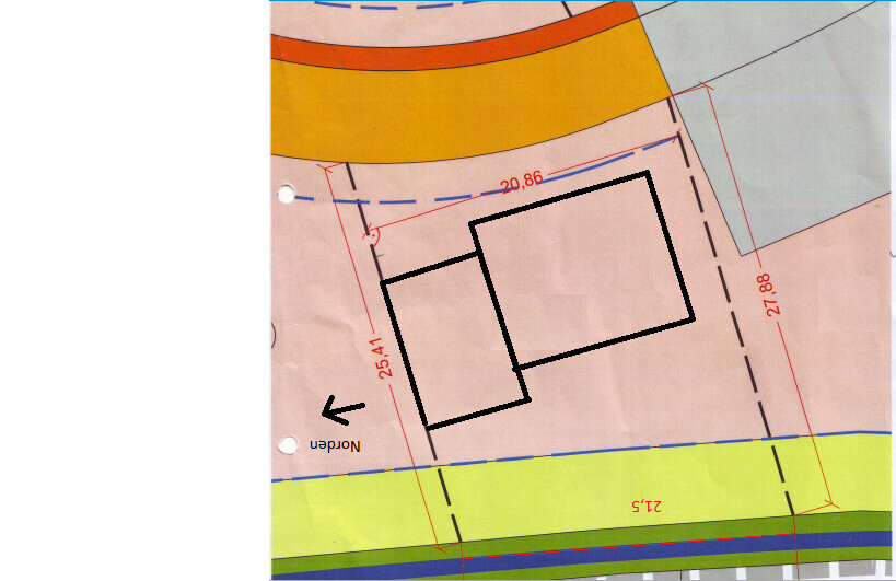

Left, uh right is north, and the floor plan design places the garage in the ??? west? And then?

13 Sep 2019 23:22
The plot is now aligned exactly as the floor plans.
Grundriss eines Baugrundstücks mit zwei Rechteckgebäuden, Maßlinien und Nordpfeil.

MakeNBreak schrieb:
Plot now oriented the same way as the floor plans.
Sorry for my previous response.
But what are we supposed to do with your orientation issue, meaning the mirroring?
Or should we think outside the box?
By the way, I see a 90-degree rotation.

PDFs are generally not popular here for practical reasons—especially among mobile users. Do the parents sleep separately, or does only one child have a walk-in closet? Overall, the floor plans feel awkward, like a typical first attempt at rooms-and-walls tetris by amateur planners.
Would you like to name the model homes that served as inspiration here (only by name, without links) or that were partially mixed into the plans?
It never rains in southern California—setting the door to the garage at priority 99 easily allows for more freedom in arranging the building layout.
