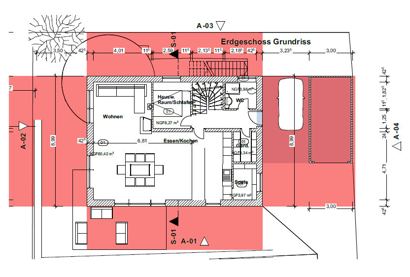

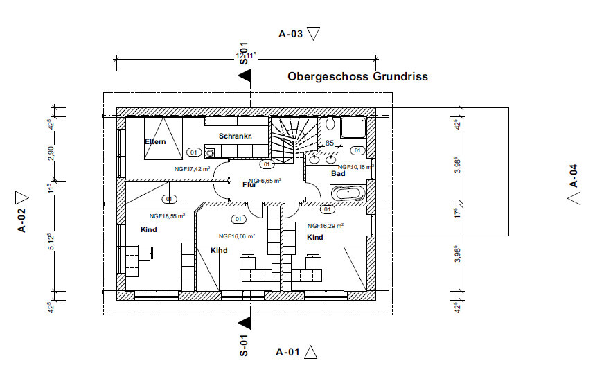

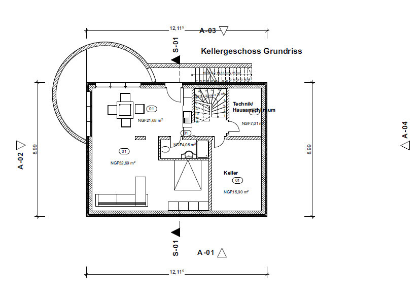

Taner007Hello everyone,
After much consideration, we have decided to build a house with a granny flat (accessory apartment).
Recently, I received the floor plan draft from our architect. Due to the small plot size and my lack of experience, I would like to ask for your assessment and suggestions for improvements.

Octrineddy19 Aug 2020 12:46Is the secondary apartment intended to serve as a fourth child’s bedroom? Otherwise, isn’t one still missing?
Alessandro19 Aug 2020 13:06You won’t be able to build the house within your budget...
nordanney19 Aug 2020 13:44Octrineddy schrieb:
Is the granny flat intended as a fourth bedroom? Otherwise, one is still missing, right? It’s probably the room on the ground floor (utility/sleeping).
Almost 300 sqm (including the basement) for the requested €420,000 including photovoltaic panels, kitchen, fireplace, and whatever else. Impressive! Normally, we calculate around €2,XXX per sqm (square meter) of living space plus basement, additional construction costs, fittings, and garage/outdoor areas. This doesn’t add up.
