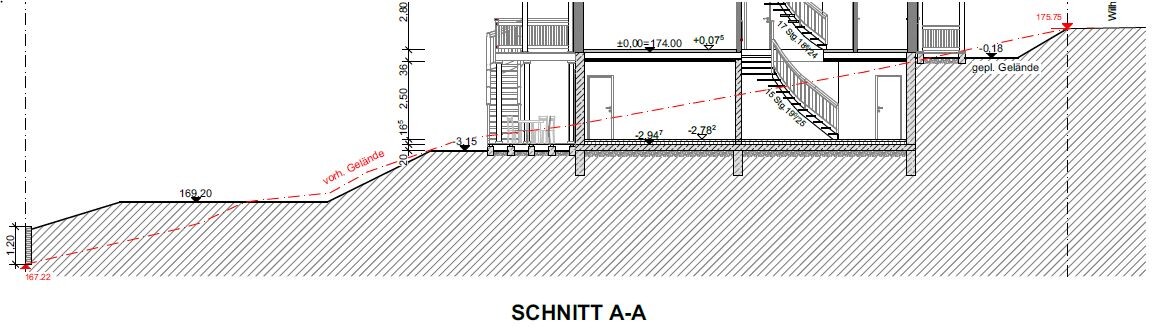

We are in the process of building a house and, after much deliberation, have decided on the floor plans. I’d like to share the plans with you and look forward to your objective opinions.
Please do not comment on the kitchen layout. We are currently in the middle of kitchen planning, and the kitchen as shown on the plan will almost certainly not be implemented as is.
The plot has a steep slope from north to south (there is an 8-meter (26 feet) difference between the street and the lower boundary of the property) and a slight slope from east to west (this is the street side, with a 2-meter (6.5 feet) difference). Only the tenant of the basement apartment has access to the garden. Since the house turned out quite large, we decided to include a basement apartment to rent out. It has a separate entrance.
It was important for us to separate the living room from the kitchen and dining area because we have three cats, and I want to buy a nice sofa without worrying about destructive cat claws. Upstairs, we wanted a large hallway as a second living room. I’m not a fan of having TVs or computers in the children’s rooms.
There is no building permit/planning permission for the site. The garage will be built directly on the property boundary.

zwei&vierzig22 May 2017 21:07ypg schrieb:
I’m still missing a cross-section!
With hillside houses, you don’t just plan a normal additional floor without windows; you have options to stagger the levels.
Personally, I would never consider accessing my own garden only via a staircase, especially since land and property are so expensive. The stairs pose too many risks for children – using the garden would be more like going on an outing to the playground or park, always carrying a picnic basket to keep the kids and yourself energized.
I read something about an 8-meter (26 feet) height difference and a 2-meter (6.5 feet) slope on the side, so shouldn’t it be possible to create several garden levels?
In this design, it would also make more sense to place the exit for the granny flat near the entrance (east side?) so that the residents from upstairs don’t always have to pass by the tenant’s outdoor seating area. The terrace downstairs isn’t really usable without disturbances at the moment. The granny flat itself lacks some storage space. I would plan the kitchen near the entrance and the bathroom closer to the bedroom.
Since the granny flat is pretty compact in size, you could arrange it so that half is on the upper floor and the other half is the parents’ area. The ground floor could then be for the children’s bedrooms, and the basement for living and household areas.
Surely, there are more options than just “either-or.” What exactly do you want a cross-section of? The house? The plot?
We actually don’t have the option to stagger the floors. The plans were preceded by three months of discussions with the building authority/planning department, and three architects have tried (and failed).
There are multiple garden levels, and one will be built up to create a flat area. The storage space issue for the tenants is indeed a problem. The idea was once to create storage space under the stairs. Otherwise, the room under the garage (which will only be half-height) could be used as storage. Or what do you suggest? The bathroom is located on the side where the kitchen and the utility connections are. I personally don’t like your idea of splitting the granny flat and parents’ area in half; it feels too close. Also, children are planned but not yet present, and for very young children, I would prefer them to be near the parents’ bedroom. The granny flat doesn’t have to be rented out for the next 20 years.

zwei&vierzig schrieb:
I was actually referring to @Tentakel when asking how he would plan it.
The plot is only 18 meters wide. If I plan a double garage (6 meters wide) next to the house, the house becomes too narrow. It was important to us to have the kitchen, dining, and living areas next to each other. We consciously decided to live on two floors to avoid living on the staircase, which is unavoidable when living over three floors.
Moving the basement forward would cause problems with the slope. It would also create a half level, and supporting that would be costly.
The issue with the staircase is the 3-meter (10 feet) clearance from the property boundary. This has already caused us many sleepless nights.
"Move walls on the upper floor, possibly put the guest room in the basement area under the garage." I like that idea. However, that should be my room and I don’t want to be so far away from everything. You end up living over three levels anyway. Kids are outdoors almost every day of the year. Every drink, etc., has to go down the stairs. If you want to quickly do something, like cook, you don’t have the kids in the

I find it a shame to make compromises on the upper floor to use nice living spaces as a separate apartment, in-law flat, etc., or leave them empty.
One level for parents sleeping and children’s rooms, maybe later an office and guest room, laundry
One level for cooking, living, dining, with easy access to the garden
One level for guest, office, small bathroom, open living area, later the teenagers’ domain.
It’s a pity about the staircase. I can imagine that this could cause issues with renting or splitting the garden. Do you already have exterior views?
