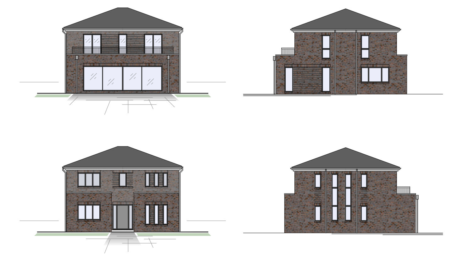

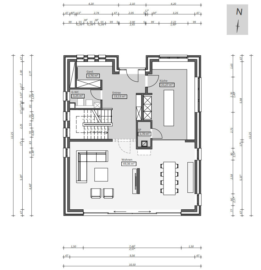

We have received the first draft of our new single-family home from the architect.
Personally, we really like the house style visually, since it is a city villa without roof slopes but does not look bulky and fits well into the Hamburg cityscape.
The architect has fulfilled most of our wishes, but the entire kitchen area is definitely still problematic, as it is too narrow and long. Due to the house shape, widening the kitchen is unfortunately not possible without affecting the light-flooded entrance area or making the house wider (which we would prefer but cannot due to the plot’s dimensions, as a 2.75m (9 ft) distance to the boundary has already been planned on both sides). Originally, we planned a pantry accessible through the kitchen front (yes, a somewhat modern convenience) placed on the north side of the kitchen, but this would block the light axis in that area and make the northern side windows redundant.
Furthermore, the bathroom on the upper floor is under discussion. Although we like the idea of a separate toilet, the shower and washbasin area may make the room feel smaller overall, even though it is quite large.
The upper-floor bedroom is also not perfect yet. We wanted a separate walk-in closet, but due to limited space on the upper floor (single-story design without roof slopes), the bedroom feels relatively small and we would prefer it to be a bit more spacious. The children’s rooms are generous enough.
The house has quite a few (somewhat narrow) windows, and we are considering whether fewer but wider windows would make more sense.
This is a first draft developed based on our space requirements. We would very much appreciate your initial impressions to help us decide whether this can be developed further or if we should rethink the design.
If I have forgotten anything above, I will gladly provide more info later.
Thank you very much.

I would never think about widening the kitchen but rather shortening it. Visually it is appealing, but in my opinion, it is a kitchen with long walking distances and thus not ergonomic. Kitchens should be designed like a workspace to minimize necessary travel distances.
I don’t think it will feel cramped. Maybe just plan for dressers on the short side and leave out the sidewall.
However, I view the roof terrace negatively, as it connects parents and child, resulting in a lack of privacy on both sides.

The problematic area is definitely the entire kitchen because it is too narrow and long. Due to the house shape, it’s unfortunately not possible to widen the kitchen.
flymac schrieb:
Bedroom/dressing room (feels cramped, possibly replace the dressing area with a fitted wardrobe)

I agree with @ypg, you won’t get this house built turnkey in Hamburg for €700,000.

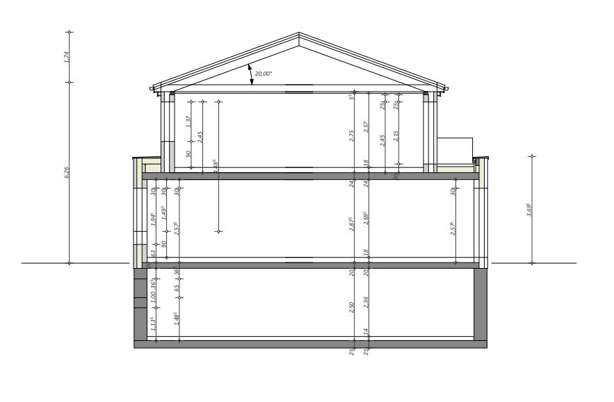

Another point: Are you sure this is still considered a single-story house? By my rough calculation (94 sqm (1,012 sq ft) ground floor, 70 sqm (753 sq ft) first floor), the first floor has more than two-thirds of the ground floor living area, or does Hamburg have a different definition?
I unfortunately have to say... lots of space, but in parts more than impractical.
The bedroom on the upper floor is problematic, especially the bed’s position with the headboard right next to the passageway. I also find the bathroom poorly designed, particularly the shower exit in front of the bathroom door.
I see the kitchen the same way as @ypg ... it will be hard to plan. And an island only 326 cm (128 inches) wide will be very tight, or even too narrow, for an island.

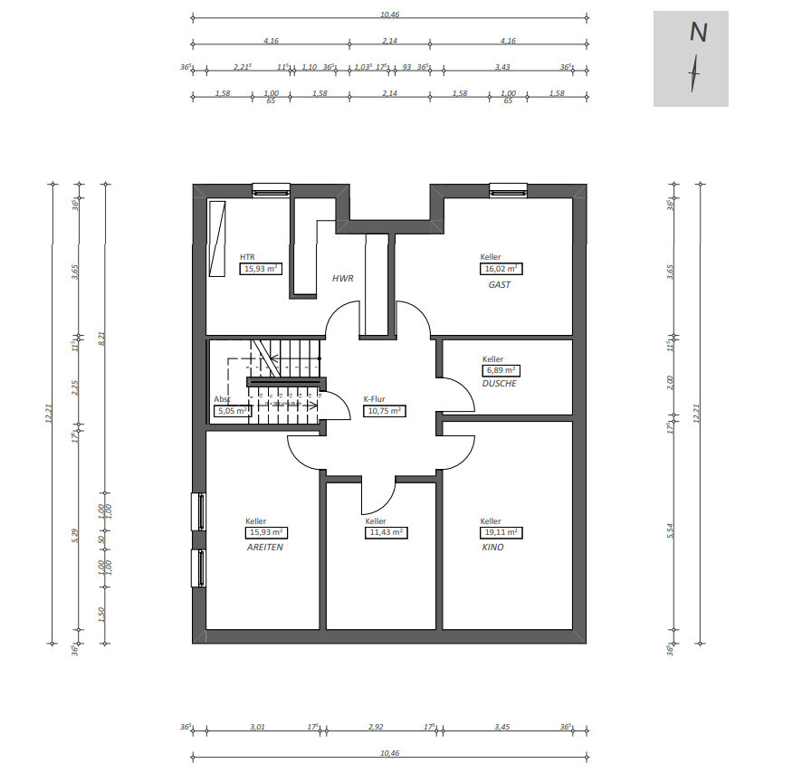

Home office in the basement – the basement room shows windows only 100 cm (39 inches) high. Is there supposed to be some kind of light well in front of them? Nothing like that is shown in the elevation drawings.

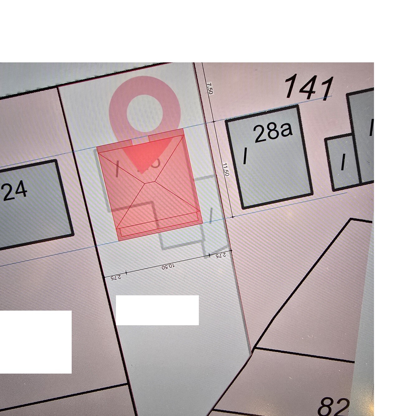

hanghaus202314 Nov 2024 10:36Is there a zoning plan or development plan? The architect planned beyond the budget.
