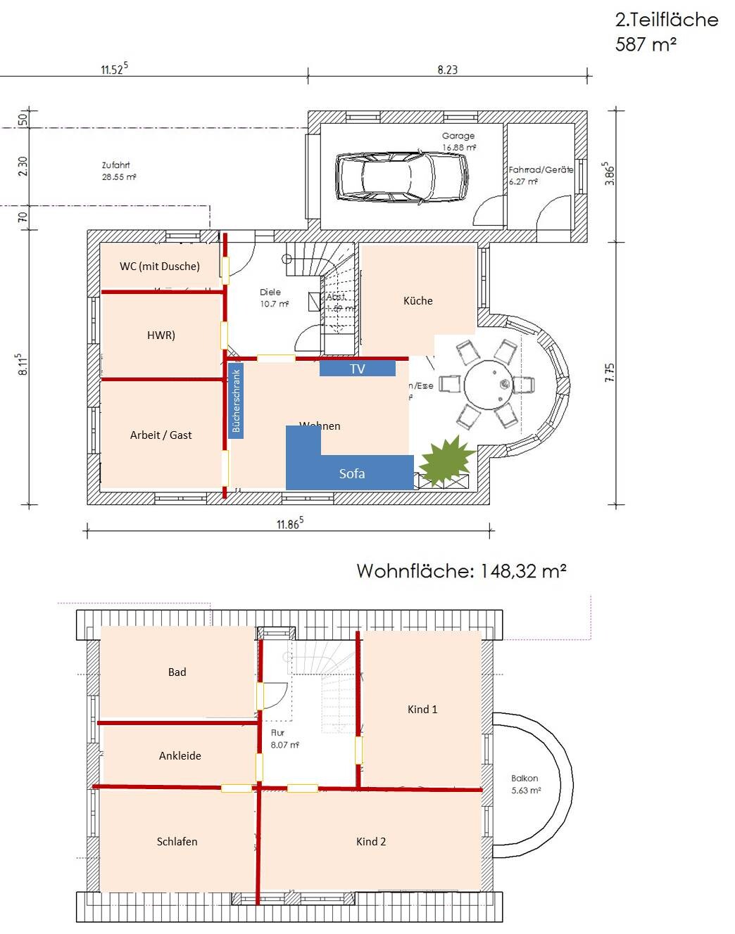

I took the exterior dimensions and the staircase/entry area as fixed and tried to arrange the rooms in a way that would appeal to me somewhat...
Ground floor (all walls straighter):
- Additional study, unfortunately isolated (to reduce the huge living room)
- Kitchen with access to the terrace (if the large living room is preferred, the kitchen and study can be swapped again)
- Bay window usable as a dining area
- WC could possibly be expanded to include a shower
Upper floor:
- Both children's bedrooms are larger and have access to the balcony
(I can even imagine the balcony being used for a few years as a children's space, since it’s uncool to sit with the parents on the terrace)
- Walk-in closet can only be accessed from one side (personally, I would remove it and combine the bedroom and bathroom, but "mini" walk-in closets are currently trendy and might be a good selling point)
- Bathroom under sloped ceiling needs careful planning
Upper floor:
RomeoZwo schrieb:
I took the exterior dimensions and staircase/entrance area as fixed and tried to arrange the rooms in a way that would somewhat appeal to me...
[ATTACH alt="Bild1.jpg"]42262[/ATTACH]
Ground floor (all walls more linear):
- Additional study, unfortunately isolated (to reduce the massive living room)
- Kitchen with access to the terrace (if the large living room is preferred, the study and kitchen can be swapped again)
- WC could possibly be extended with a shower
Upper floor:
- Both children’s rooms larger and with balcony access
(I can even imagine the kids using the balcony for a few years, since sitting with the parents on the terrace is uncool)
- Walk-in closet can only be accessed from one side (personally, I would leave it out and combine bedroom and bathroom, but “mini” walk-ins are currently trendy and might sell well)
- Bathroom under the sloped roof needs careful planning I think this makes sense! Yes, the bathroom on the upper floor is awkward because of the sloped ceilings and head height. It should include a bathtub, a shower, a toilet, and two sinks.
