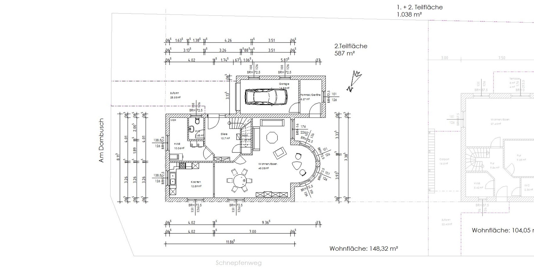

Hello
What do you think about the design and the room layouts?
Best regards, RaBa2020
Upper floor plan with bedroom, dressing room, bathroom, child 1, child 2, corridor, and balcony.
Floor plan of a single-family house: living/dining area, kitchen, garage with car, utility room, toilet
bauenmk202021 Jan 2020 20:43
Could you not place the garage as a boundary wall directly next to the neighbor’s garage?
The two windows in the garage are actually not necessary.
If the garage is moved, the entrance to the house would then have to be on the narrow side of the house.

Where do you see size in this house?
The hallway areas and bedrooms have significantly more square meters than necessary and are huge compared to the children's rooms. The living area also has relatively a lot of space. For an overall spacious house, it’s not too much, but the spaciousness doesn’t extend to the kids’ area. If the total size is fixed, a better redistribution should definitely take place.
kbt09
21 Jan 2020 22:54
The garage should be right on the boundary. No windows are allowed there.
The floor plans still lack dimensions. The window sill heights are also missing... one of the children’s rooms will end up a dark cave.

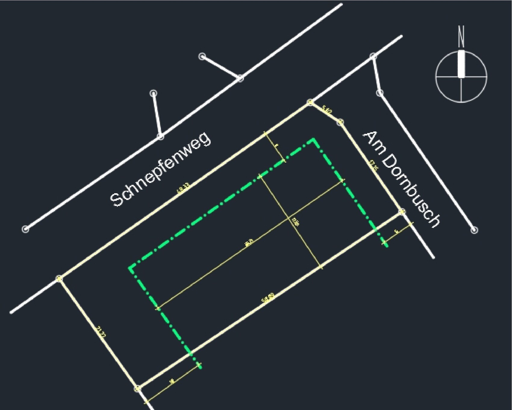

R
RaBa2020
22 Jan 2020 09:39
Detailed floor plan of a house with garage, kitchen, living/dining area, hallway, utility room, and restrooms.
Floor plan of a residential house with bedroom, bathroom, walk-in closet, corridor, balcony, and living/dining area.
CAD drawing of a street sketch with dimension lines, green rectangle, and north compass.
Development plan including sections §§ 1–5, land uses, parking spaces, trees, and regulations.

kbt09 schrieb:
The garage should be located on the boundary line. There are usually no windows allowed there.
Why would the garage have to be on the boundary line?
The floor plans still lack dimensions. The window sill heights are missing as well... one of the children’s rooms will end up very dark.
What does Z1 mean? = Maximum one-story construction
You have to figure out the north arrow yourself and first rotate the house as it will likely be positioned on the plot.
Explanations are still completely missing.
