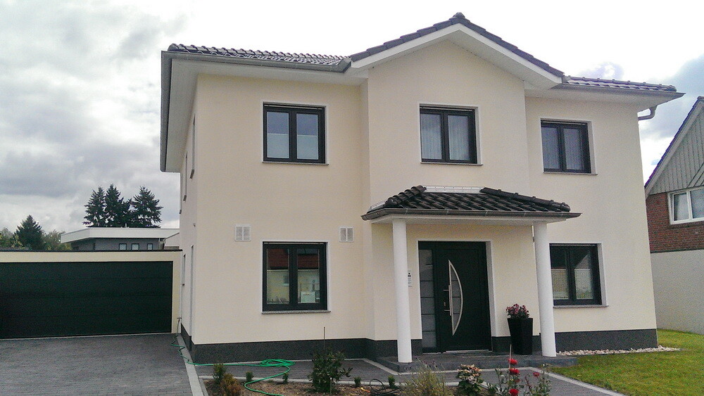

Also, I find an entrance like this one very appealing, with a small porch. (Photo attached) If I place the entrance on the side, the garage would be just 2–3 meters (7–10 feet) in front of it… and that would ruin the nice view of the “impressive” entrance because the garage is directly in front. And if we were to plan the garage driveway at the back and the entrance from the sidewalk… I have never seen a house where the garage is oriented away from the main entrance. I just can’t imagine such a layout. Everyone places their garage with the driveway facing the entrance, either on the side or front, but never the other way around.
Maybe we just lack the imagination to see how it could look finished, but as far as we are concerned, we like the entrance facing front and the driveway in front best.
