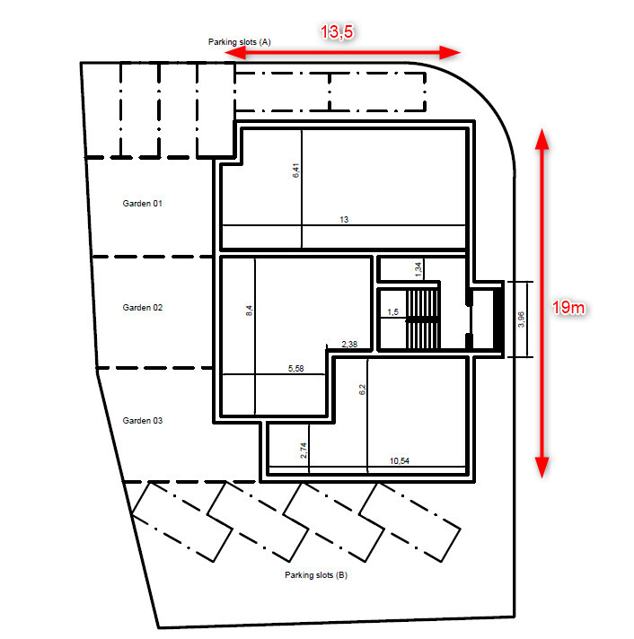

At first, I found a floor plan that I quite like and whose dimensions almost fit perfectly.
I’m still unsure about the elevator and whether it’s really worth the $30,000 (offer from Kone). Possibly, we will prepare the shaft for later installation if accessibility becomes necessary. The toilets would be removed to save costs.

hanghaus200031 May 2021 09:45Why not?

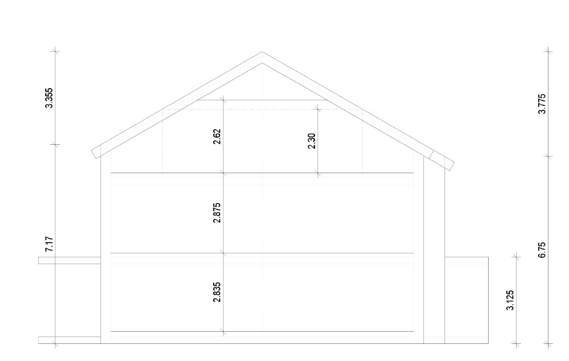

Make the lower dormers a bit steeper, then you can fit in one more dormer.
A ceiling height of 2.30 m (7 ft 7 in) in the attic won’t work. In my opinion, the minimum living space height should be 2.40 m (7 ft 10 in), preferably higher.
Is house number 67a a flat roof?

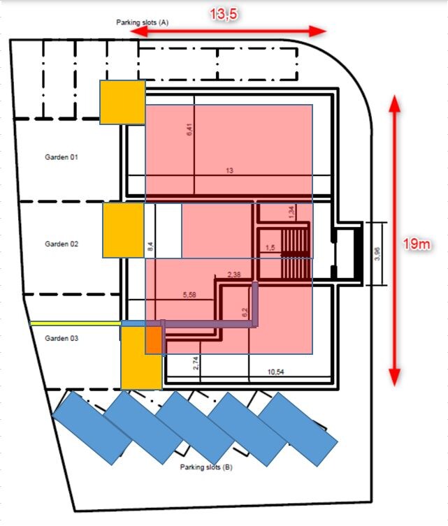

I thought you also wanted a flat roof. I would set the third floor back a bit, like the mansard roof in the picture—about 1 to 2 m (3 to 6 ft). This is how they handle it here in the community with the newly approved flat roofs. The added benefit is that you have fewer issues with setback distances and wall heights.
