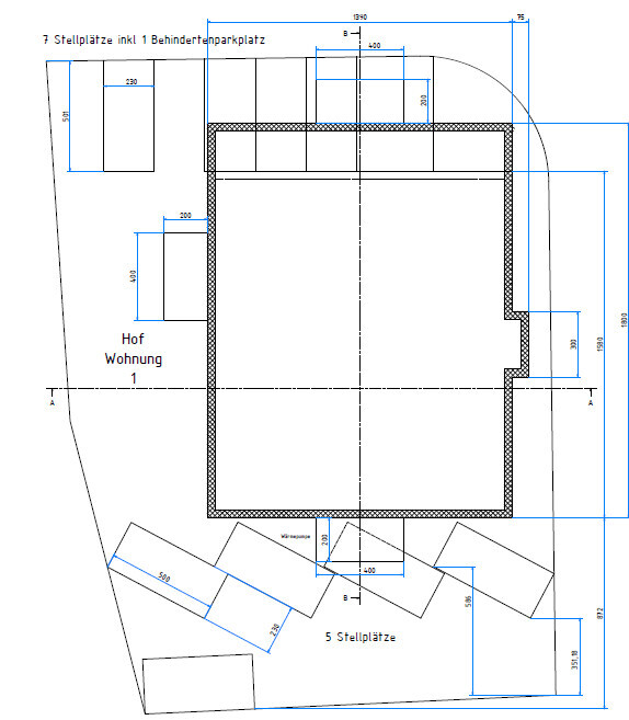

In two weeks, the next planning committee meeting will take place after what felt like a year of back and forth...
In connection with a slightly modified floor plan, I would also like to submit this letter.
What is your opinion on this?
As discussed with you by phone, please find attached the revised preliminary request with the change to 6 residential units as well as the updated site plan.
The new design includes a building with 6 residential units. The number of parking spaces has been increased to a total of 12.

hegi___ schrieb:
Reserving 2 parking spaces per housing unitTwenty-thirty narrow, but you can take stinginess too far ...https://www.instagram.com/11antgmxde/
