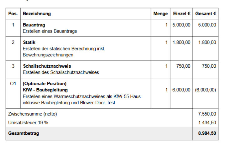

This time, the structural engineer for my single-family house will handle the building permit application at the usual low cost. Fire protection will also need to be included.
