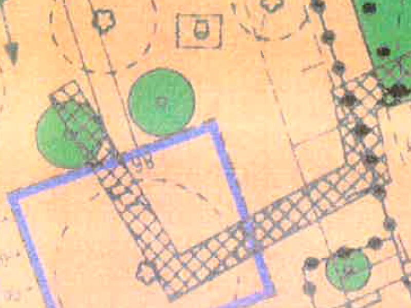

I am considering a plot of land and have the following questions:
1. A multi-family house is planned to be built. Are there any regulations regarding how the individual residential units must be arranged within the building? I want to build something like a townhouse with an additional unit above (so three units in total; just not stacked directly on top of each other).
2. There are trees on the property, unfortunately in the area where parking spaces could be located. I see hardly any other options. Is it possible to obtain tree removal permits (the trees are protected by a tree protection ordinance)?
3. On the development plan, there is a feature marked that I cannot identify. It is an irregular "path" with a checkered pattern, see attached.
Thank you very much for your help.

Reiner_197812 Aug 2014 07:35Good morning.
Interestingly, the tree within the building area is no longer there. 🙂
I am quite well informed on this. I know about tree protection regulations. The trees are obviously known to the city and are also nice to look at. I had only read that parking on the roots is not allowed. If a tree is too close to the house, it can be removed.
My question was whether anyone has heard of parking spaces causing trees to be removed. Apparently not in this case, as seen below.
What I have now also seen on the city’s online building plan (the picture is from the owner) are marked areas labeled "St." These are likely parking spaces—three of them.
These are probably required to be constructed there.
They are located northeast of the building area as well as directly east adjacent to the building area.
So, there is forest to the south and building opportunity to the northeast.
1100 square meters (approximately 11,840 square feet), with a maximum allowed building area of 400 square meters (approximately 4,300 square feet) according to city regulations.
I like the location, but it is frustrating that even the parking spaces can’t be placed as deemed practical.
Especially since access to the house is supposed to be from the south. And in summer, the sun stays longest in the area where the parking spaces are planned (northeast: 2).

Bauexperte12 Aug 2014 08:46Hello Reiner,
That’s how many multi-family houses look nowadays 😉
Where parking spaces “could go” and “are allowed to go” are often two very different things.
That depends… The city/municipality/local authority can provide information or direct you to the responsible contact person.
You should also ask the city/municipality/local authority about this, especially if the written provisions of the development plan don’t clarify it. It could be anything from a utility corridor to infiltration trenches.
Basically, in my opinion you should find a trusted partner to clarify the buildability of the property with you; for example, whether more than two residential units can be approved at all. At the same time, they can help you with your other questions regarding the construction project.

Reiner_197815 Aug 2014 09:46Hello!
I visited the building authority.
Here is what I can share:
1. There is a suspected bunker tunnel underneath the hose with a checkered pattern.
Problem: The heritage protection authority might classify it as worth preserving. The official could not tell me what consequences this would have. (I want to build without a basement.)
2. The structural design does not seem to be a problem.
3. I am a freelancer and want to work in the top floor.
This is a WR (mixed-use residential) area according to § 3 of the land use ordinance NRW.
According to § 13 of the land use ordinance, I would be allowed to use rooms within a building. The official intends to check internally whether it is possible to use an entire floor. I am looking for legally reliable information about the rather lengthy preliminary building permit process.
Does anyone have experience with how this is handled in NRW?

Bauexperte15 Aug 2014 10:37Hello,
Is this an assumption or confirmed knowledge, and what is the source? In any case, if the heritage authority is involved, the process will take longer and be more expensive, especially for site development. In addition to the usual soil survey, a further geological investigation is required to provide clear evidence of the underground conditions.
Are you really a freelancer or rather a business owner? This is not only an accounting distinction. Are you an artist, do you have a university degree, or do you work in the IT sector?
That would be a purely residential area with no commercial activities allowed. Hence my question regarding freelancer status yes/no.
This varies from city to city; with heritage protection involved in your project, expect longer processing times. Normally, anywhere from 6 weeks to 6 months is possible.
€945.00 per square meter? That’s pure wishful thinking in the Rhineland area; roughly expect about twice that amount. This excludes additional construction costs and landscaping but includes all architectural services. Where exactly do you plan to build?
The building permit phase alone is not enough; your contractor will also need some execution planning 😉
For service stages I through V, fee zone III, and assuming my estimate is correct (which it should be for the Rhineland; I just quoted a smaller multi-family house in Kreis Neuss), architectural fees will be in the ballpark of approximately €50,000.
