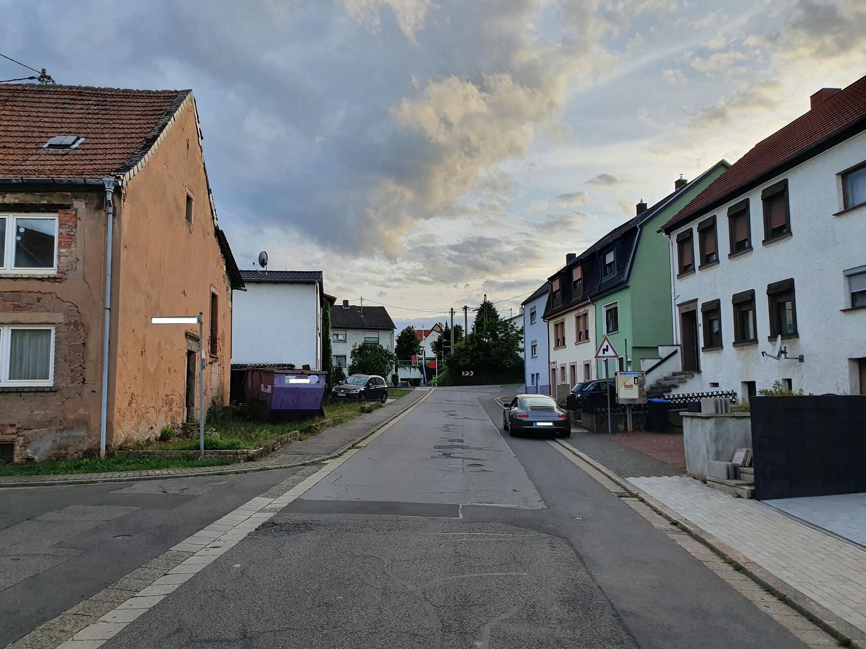

What are your opinions? The houses on the other side of the street also have 2 full floors plus an attic.
The new idea is to reduce the dimensions and have 2 full floors plus a half attic with knee walls and a pitched roof.
So the blue house actually has 3 full stories, and I would also consider the green and yellow ones as having 3 full stories (even if the mansard roof visually softens that).
The letter from the municipality seems, in my opinion, to lean towards reducing floor area ratio to preserve a more open style of development. I would therefore first try to reduce the floor space index.
From the previous description, I understand that no basement is planned. Maybe a concept with a large apartment on the ground floor (4 rooms with garden), 2–3 smaller apartments on the upper floor (2 rooms), and another 4-room apartment in the attic, possibly a setback story (penthouse), or 2 x 2-room units.
Lately, 3-room apartments are no longer really considered family flats but rather dwellings for high-earning couples. They might prefer to move to a nearby city. Families connected to the area or lower-income singles working locally would be your main clients for the 4-room and 2-room apartments. According to this reasoning, that would mean 7 parking spaces.
