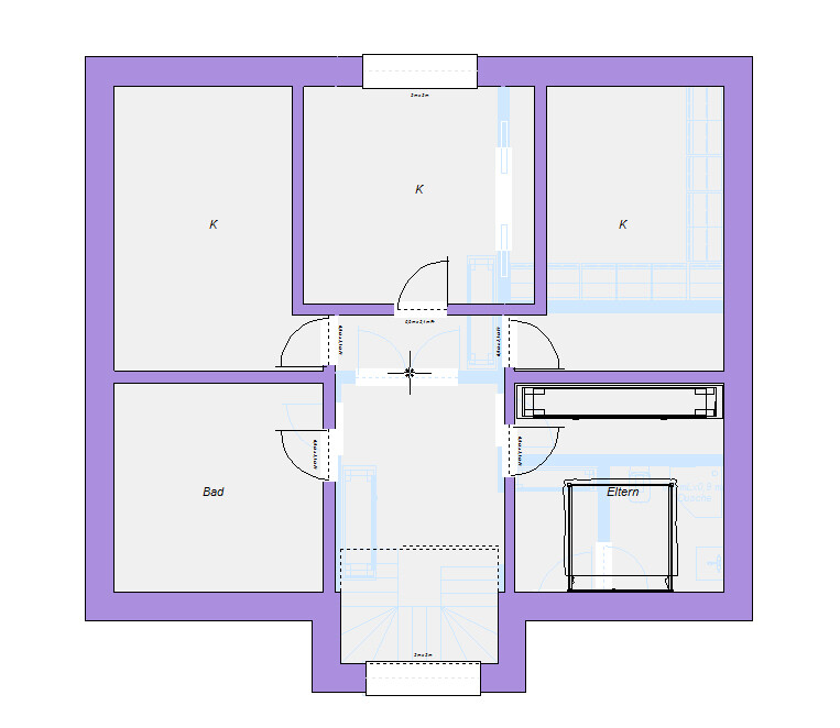

we were able to reserve a plot of land (thank you very much for your help!) and would now like to plan a captain’s gable house.
We are quite satisfied with the exterior appearance of the house, the positioning on the plot, and the ground floor, but the upper floor is still causing us some concerns.
Maybe you have some ideas and suggestions for improvement. We would appreciate it!

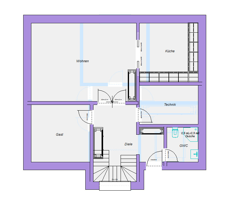

What is particularly liked? Why? Spacious entrance area and utility room, exterior appearance
What is disliked? Why? Dormer not centered; third children’s bedroom much too small; storage room on upper floor unnecessary

Phew, minor details…
Is it enough for who? Just you, you and your partner? Or for the one and a half kids?
On Facebook, there is a group called Dream Living: every day the same question comes up with a picture asking, “How do I get some order in the hallway?” The pictures make it look like you should be looking for a new house.
Yes, I also see the challenge of moving the east window on the ground floor.
Yes, cozy is a good way to describe this entrance situation.
But these are minor details. The first thing I would do is to mirror everything, so the garage doesn’t block the valuable west-facing sun.
LisaO schrieb:
we found a spot for a coat nook in the hallway.
LisaO schrieb:
The windows are not symmetrical yet,
LisaO schrieb:
whether the access is really that inconvenient or maybe even cozy?

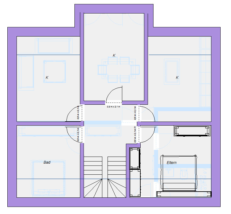

If the staircase to the attic is omitted, it can be optimally repositioned for the upper floor. I am quite surprised that your planner did not suggest this. The previous location was only optimal because of that. If that reason no longer applies, for example, it would be much better placed along the eaves side.
We do not want to mirror the house despite the afternoon sun from the west, although we really thought about it for a long time.
Right now, I cannot quite imagine the staircase on the eaves side, or how access to all rooms would be ensured.
Is the cloakroom really that much too small? We each have 2-3 jackets for every season, and currently, we have to manage with much less space. We thought about installing doors in front of the almost floor-to-ceiling recess and additionally placing a shoe cabinet under the stairs.
MachsSelbst29 May 2024 23:30Here, it is common to calculate with 10 jackets and 1 linear meter (3.3 feet) of wardrobe space per person. Don’t worry about it.
LisaO schrieb:
I can't quite imagine the staircase on the eaves side, or how access to all rooms would be ensured in that case. Well, for example, like this:
LisaO schrieb:
We like the current floor plan quite well except for a few minor details. Really? Have you taken a close look at your bathroom? Having the toilet right behind the door is quite awkward in my opinion. The door actually swings the wrong way entirely. If you reverse it, the toilet placement gets even worse. So that’s a fail.
LisaO schrieb:
The windows are not symmetrical yet, the roof window is too small for us, and the access to Child 1’s room is not ideal. Exactly! Offering something like that in a new build is a joke! Please don’t let anyone talk you into this, and NO! it’s not cozy, it’s just ridiculous.
Thank you for the feedback and the example pictures!
I completely understand the criticism regarding the child’s room access. Since we were uncertain about the bathroom layout, we had it professionally planned and are actually quite satisfied. Do you think the toilet is poorly positioned in terms of appearance?
