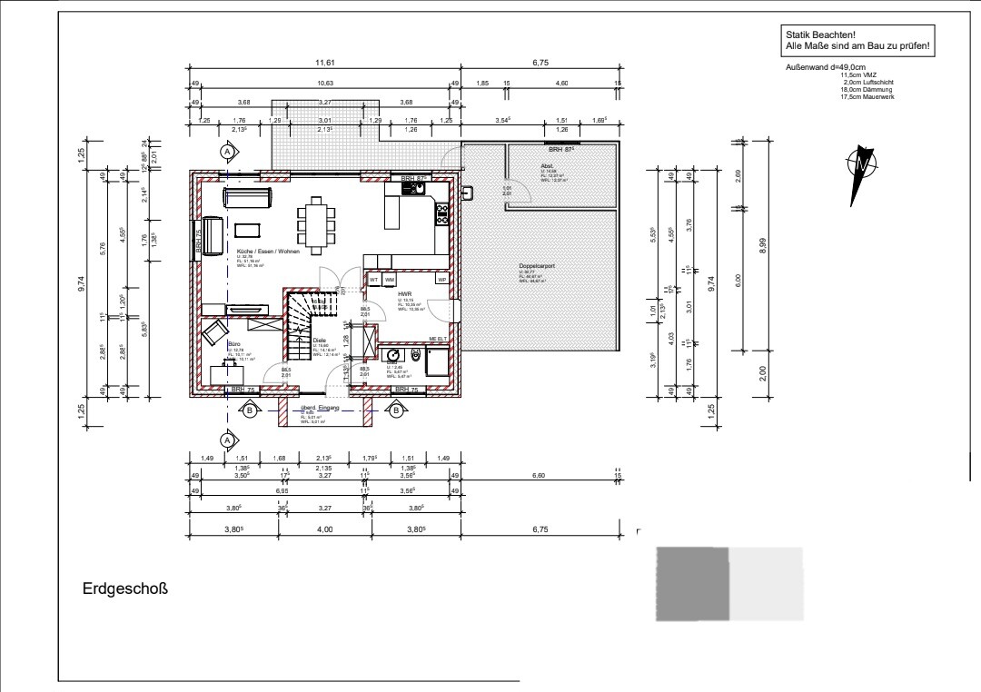

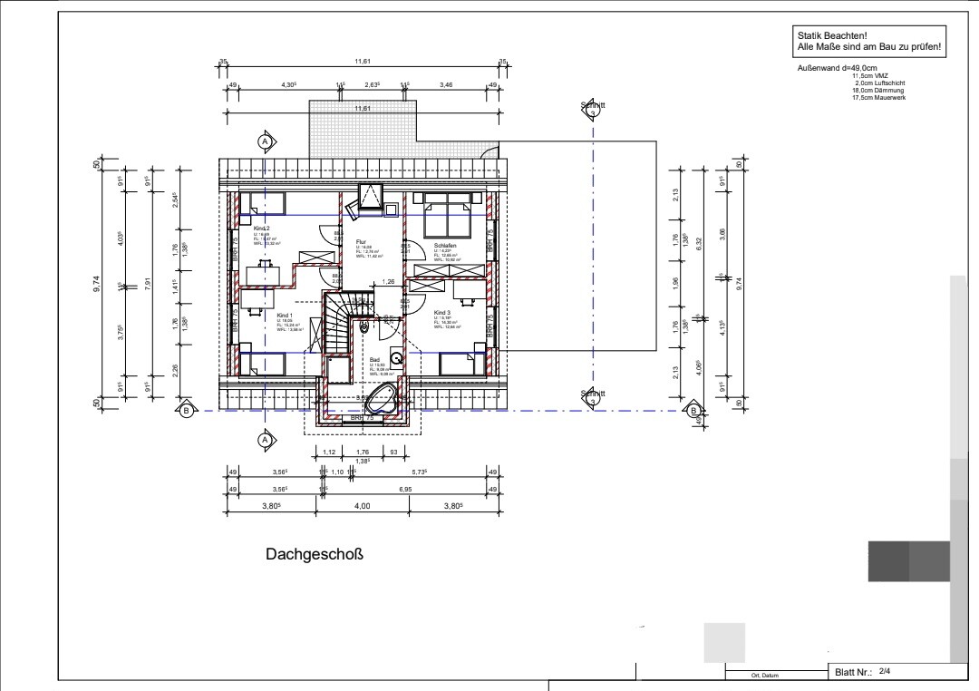

we were able to reserve a plot of land (thank you very much for your help!) and would now like to plan a captain’s gable house.
We are quite satisfied with the exterior appearance of the house, the positioning on the plot, and the ground floor, but the upper floor is still causing us some concerns.
Maybe you have some ideas and suggestions for improvement. We would appreciate it!
Here are the key details:
Development plan/restrictions
Plot size: 1,062 m² (11,430 sq ft)
Slope: none
Site coverage ratio: 0.3
Floor area ratio: 1
Building window, building line, and boundary: 3 m (10 ft)
Edge development: yes
Number of parking spaces: at least 2
Number of floors: 1.5
Roof type: minimum pitch of 30 degrees
Architectural style: /
Orientation: north-south
Maximum heights/limits: max. ridge height: 9 m (30 ft)
Other requirements: parallel alignment to a property boundary
Owner requirements
Style, roof type, building type: captain’s gable house
Basement, floors: no basement
Number of occupants, age: two adults, two children (3 and 5 years); possibly a third child planned
Space requirement on ground and upper floors: approx. 170 m² (1,830 sq ft) total
Office: family use or home office? Home office (3-4 days per week)
Overnight guests per year: none
Open or closed architecture:
Conservative or modern design:
Open kitchen, kitchen island: open kitchen, adjacent kitchen island
Number of dining seats: 8 seats with possibility to expand to 16 seats several times a year
Fireplace: no fireplace
Music/stereo wall: /
Balcony, roof terrace: /
Garage, carport: double carport
Utility garden, greenhouse: /
Other wishes/special features/daily routine, preferably with explanations why this or that should or should not be:
- Office needed on ground floor
- Spacious utility room with separate technical room and external access, because we often come home with dirty clothes and don’t want to bring dirt into the entrance area
- Covered entrance
- Fixed staircase to the attic to possibly set up an additional playroom for the children
- Three children’s bedrooms (one of which should serve as an additional office if no third child arrives)
- No separate dressing room
Designed by: Architect
What is particularly liked? Why? Spacious entrance area and utility room, exterior appearance
What is disliked? Why? Dormer not centered; third children’s bedroom much too small; storage room on upper floor unnecessary

Thank you for your responses!
Regarding the guest toilet:
We still need to reconsider which way the door should open.
We haven’t noticed that there isn’t enough space for the WC and the toilet yet, and we have already tried unsuccessfully to think of how to solve this issue. We definitely need to consult on this.

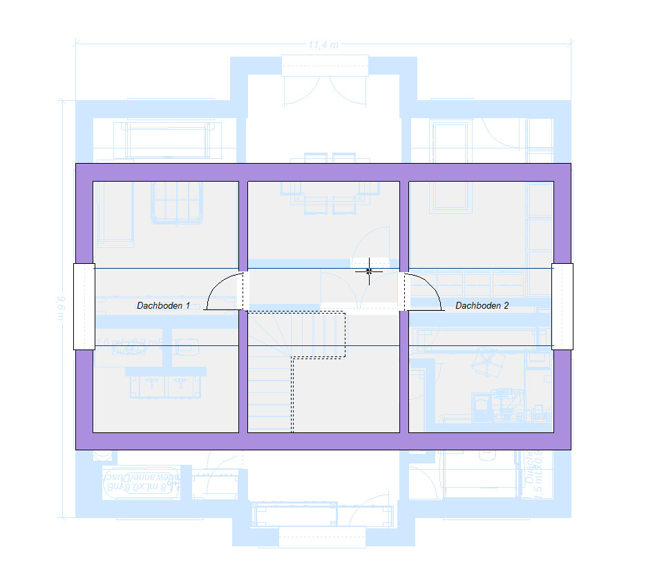

Regarding the attic:
There is no floor plan. Maybe it’s a bit naive, but we thought of putting up a wall in the middle and using one half as a storage room and the other half as a playroom.

we have recently been giving a lot of thought to the floor plan and reconsidered some aspects.
The staircase to the attic is to be removed, although it was originally very important to us. The utility room should (or must?) be much smaller, but in return, we have found space for a built-in wardrobe niche in the entrance hall.
For cost reasons and also because the staircase is being removed, we want to do without the dormer.
Apart from a few minor details, we quite like the current layout.
The windows are not yet symmetrical, the roof window is too small for our liking, and the access to Child 1’s room is not ideal. However, we do not see another solution and are wondering whether the access is really that inconvenient or perhaps could even feel cozy?
Many thanks again for all the previous advice. We would also appreciate any further criticism here.
