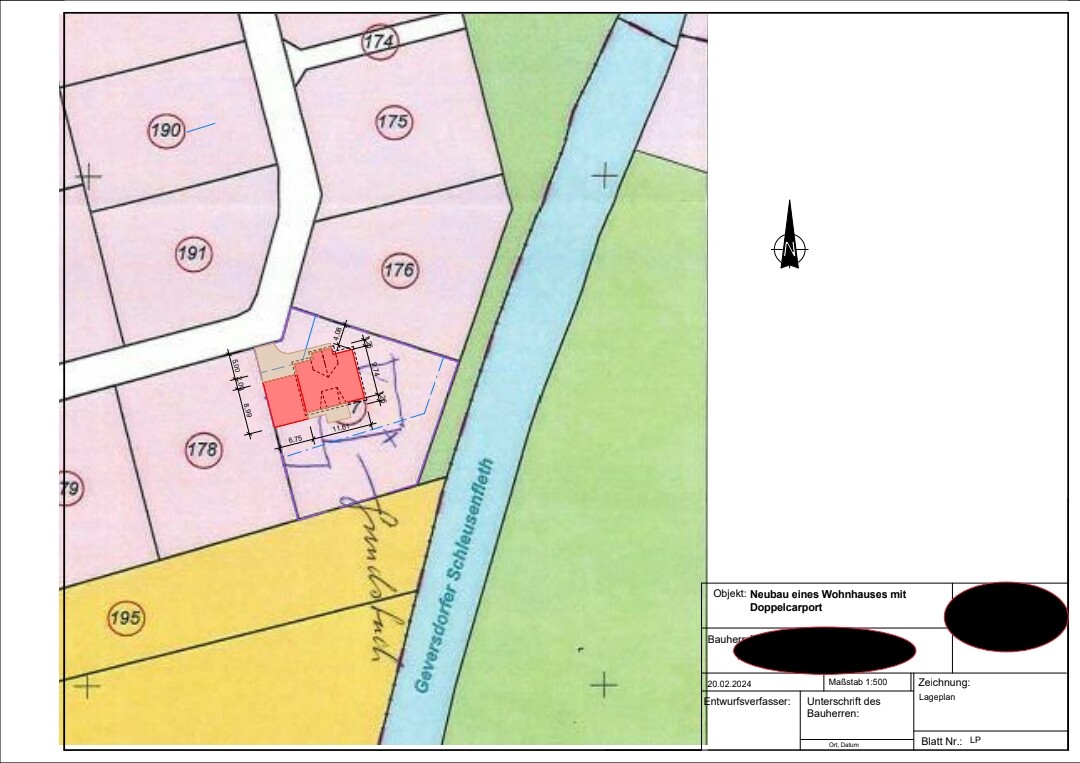

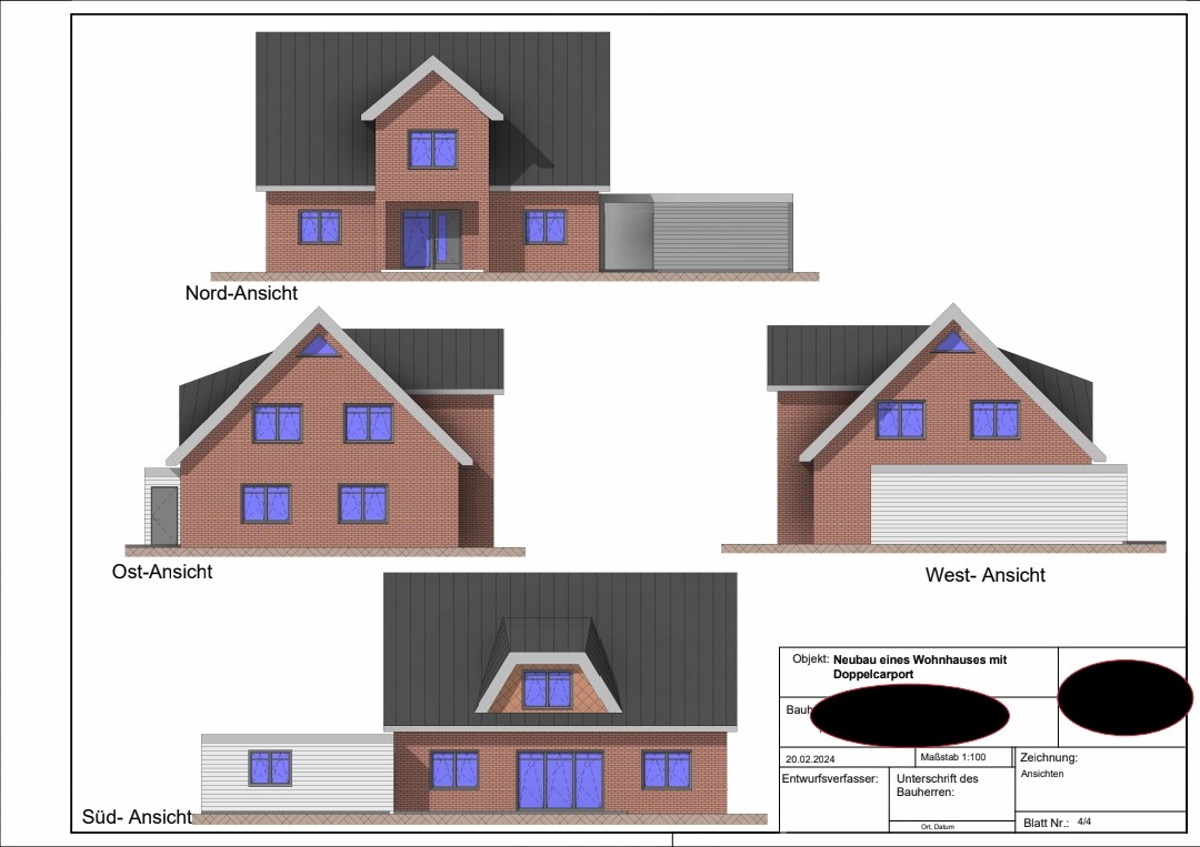

we were able to reserve a plot of land (thank you very much for your help!) and would now like to plan a captain’s gable house.
We are quite satisfied with the exterior appearance of the house, the positioning on the plot, and the ground floor, but the upper floor is still causing us some concerns.
Maybe you have some ideas and suggestions for improvement. We would appreciate it!
Here are the key details:
Development plan/restrictions
Plot size: 1,062 m² (11,430 sq ft)
Slope: none
Site coverage ratio: 0.3
Floor area ratio: 1
Building window, building line, and boundary: 3 m (10 ft)
Edge development: yes
Number of parking spaces: at least 2
Number of floors: 1.5
Roof type: minimum pitch of 30 degrees
Architectural style: /
Orientation: north-south
Maximum heights/limits: max. ridge height: 9 m (30 ft)
Other requirements: parallel alignment to a property boundary

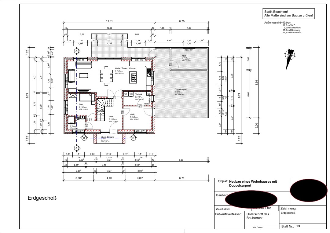

- Office needed on ground floor
- Spacious utility room with separate technical room and external access, because we often come home with dirty clothes and don’t want to bring dirt into the entrance area
- Covered entrance
- Fixed staircase to the attic to possibly set up an additional playroom for the children
- Three children’s bedrooms (one of which should serve as an additional office if no third child arrives)

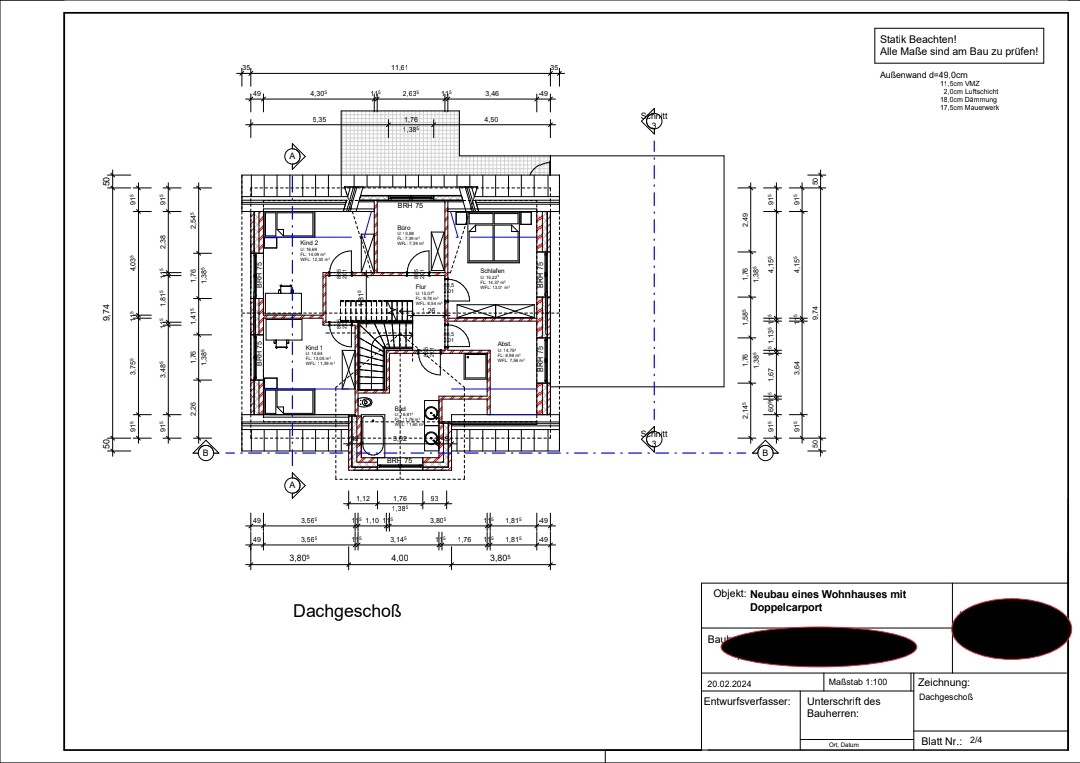

What is particularly liked? Why? Spacious entrance area and utility room, exterior appearance
What is disliked? Why? Dormer not centered; third children’s bedroom much too small; storage room on upper floor unnecessary

Ground floor:
- No cloakroom – Where do you change clothes, where do coats go? Always into the utility room, even with guests?
- I would position the door to the storage room outside at the carport opposite the door to the garden. Otherwise, you have to walk around the corner every time you come from the garden and want to take something out.
- The door to the guest toilet opens into the circulation area in front of the office. You might occasionally get hit by a door there. I don’t see a reason for the door to open into the hallway.

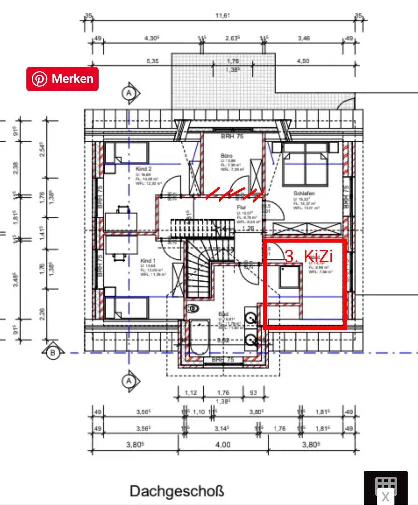

Upper floor:
- Unnecessarily small third children’s room, which results from an impractical layout probably caused by the fixed staircase to the attic.
- Storage room is hardly usable because a lot of circulation space is also required here and it is narrow.
- The bathroom is huge, more like a ballroom, which does not match the size of the third children’s room.
- An interior corridor without windows is not pleasant. There is no natural light, so you always have to rely on artificial lighting.
I would reduce the bathroom size on the upper floor, enlarge the storage room and convert it into the third children’s room (possibly swapping it with the bedroom if you have a third child), and remove the small extra room. This way you get light in the corridor, a usable room, and can keep the staircase to the upper floor.
Additionally, you could create a reading/play corner with garden views at the top end of the upper-floor corridor.

What do you especially like? Why?: spacious entrance area and utility room, exterior appearance
Sorry, but two sides look completely misaligned and unsuitable. So really wrong and hard on the eyes.
If you plan a symmetrical third gable or captain’s gable, you should let go of dreaming about individual floor plans and wall shifts. It’s just not possible. It’s best to think in a grid and make the most of it. That’s the compromise!
Basically, and also possible here: place secondary rooms and garages on the north, south, and west sides to keep the living areas free. Bedrooms are considered more like secondary rooms, while children’s rooms count as regular living spaces.
Therefore, this design is not negotiable for me.

I’m not very familiar with floor plans, but you might want to reconsider the sill height of the kitchen window. Or are you building for wheelchair users?
Putting a bay window on the upper floor to accommodate the bathroom? Next to it, a huge storage room? The bathroom could probably go there instead.
You can orient the house like that if you’re sure no house will be built to the south.
11ant22 Feb 2024 16:12
I was just pleased that the planner is not ignorant about octameters when I read this:
LisaO schrieb:
We are quite satisfied with the exterior appearance of the house, the placement on the plot, and the ground floor, but the upper floor still concerns us.
This is – as I have repeatedly explained (including in "The Upper Floor Takes Priority") – no more certain than saying "Amen" in church, a consequence of starting with the ground floor (and/or ...)
LisaO schrieb:
and now want to plan a captain’s gable house.
... the choice of the "wrong" building concept.
A captain’s house always means one-and-a-half stories (and therefore uneven load distribution with the center of gravity on the ground floor). If the room program for the upper floor would actually require a full upper story, something will have to be shifted to the ground floor (in this case, for example, the "storage room"), if the captain’s house design is going to be decisive.
LisaO schrieb:
What don’t you like? Why?: Dormer not centered; [...]
I have surely already mentioned that symmetry is not a value in itself and often a burden for house design.
LisaO schrieb:
third child’s bedroom much too small, storage room on the upper floor not necessary
If an unnecessary room does not compensate for a missing room, something is wrong before the comma.
Sorry, but two sides look completely distorted and out of place. Like really wrong and painful to the eye.
At first, I wanted to make fun of the choice of words, but after examining the corpus delicti, I might rather award a poetry prize for it.
