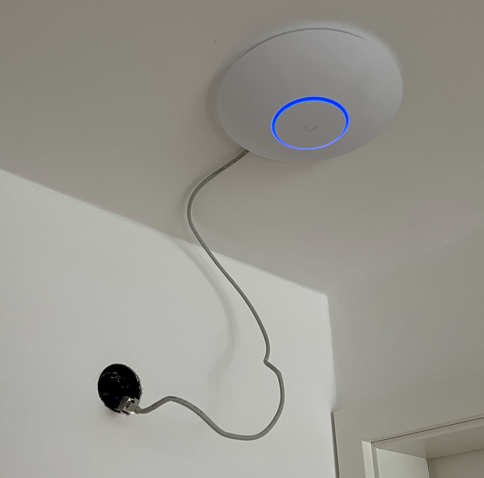

OWLer3 Nov 2021 09:26
MBPassion schrieb:
Regarding the access points, I can only recommend having in-ceiling cabling installed for them directly. This looks neat (or rather unobtrusive) and provides good coverage. You should tell the electrician to use a deep flush-mounted box for this, because you will need to connect the terminated cable to the access point with a short patch cable.
That’s exactly how I would do it now! 🙄 You always know better afterwards. Unfortunately, my situation is the same as this:
White round ceiling unit with blue ring light; cable runs from the device to the wall outlet.
So: for example, have a flush-mounted box placed centrally in the ceiling and pull CAT cables that are PoE-ready. Another tip is to plan for two boxes on the upper floor, positioned diagonally opposite each other.
I already have reception problems in the upper floor corners of the building with the LR WiFi 6 access point in Taiwan mode.
In the basement, despite having an access point, I barely get any reception except in the adjacent rooms.
I might also have to disable the 5 GHz requirement for the performance devices at some point.
Benutzer200
3 Nov 2021 09:43
OWLer schrieb:
That’s exactly how I would do it now as well! 🙄 You always learn afterward. Unfortunately, it’s going wrong now just like it did for me:
But you do know that there are special wall-mount solutions from Unifi?
OWLer3 Nov 2021 09:47
Benutzer200 schrieb:
But you do know there are special wall-mount solutions from Unifi, right?
Yes, I am aware. The internet generally suggests that ceiling access points offer better coverage and range. Mounting a ceiling access point on a wall results in one-sided signal radiation.
opalau3 Nov 2021 09:49
RotorMotor schrieb:
Aren’t UFOs just as suitable for wall mounting?
Sure, but they won’t work as well as when mounted on the ceiling. Still, I’d rather mount the UFO on the wall than have to look at something so ugly.
Besides, the UFO isn’t ideal close to the wall either; it’s better placed more towards the center of the room.
Benutzer200
3 Nov 2021 09:50
OWLer schrieb:
that the ceiling-mounted access points provide better coverage/range.
That's correct. However, it can be calculated online whether and how well it works. In the end, it's probably similar to the question of whether a car can reach 155 mph (250 km/h) or 168 mph (270 km/h).
