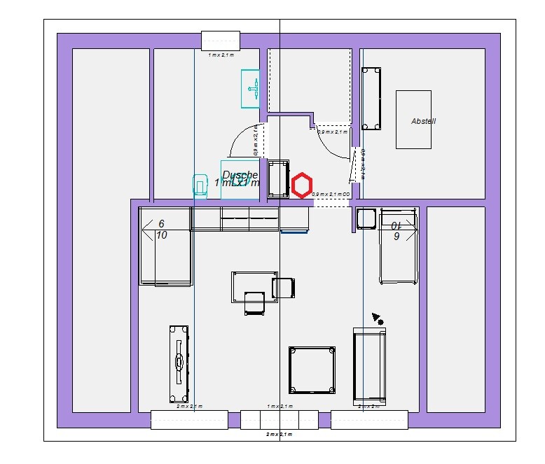

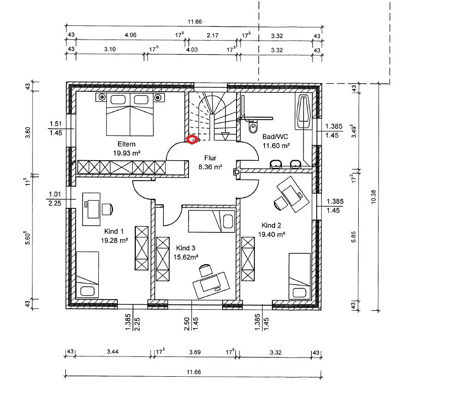

I would like to have Wi-Fi coverage throughout the entire house.
Here is my plan:
- On the ground floor, the router will be placed under the stairs, in front of the utility room (the space is not fully recessed, standing height)
- On the first floor, an access point will be installed at the staircase leading to the attic (ceiling height)
- In the attic, another access point will be mounted in the hallway on the drywall partition wall (ceiling height)
Question: Is this setup sufficient, and are these locations suitable? Can you recommend any specific products?
Thanks and regards!

Where will the switch and other equipment be placed? Also under the stairs like the router? If so, and it remains exposed, keep in mind that these devices often have some LED lights that stay on or blink. Additionally, don’t forget that if you switch to devices with fans (large switch with PoE or NAS, etc.), you will hear the noise. I would put the equipment in the utility room.
For Wi-Fi, it’s best to stick with one manufacturer to ensure good handover between access points. I am a fan of ceiling-mounted access points and Power over Ethernet (PoE). With PoE, you don’t need a power outlet nearby, and having the access point on the ceiling avoids furniture-related signal issues. My access point is from Unifi, and I run the Wi-Fi separately from the router. However, if you choose AVM devices together with a FritzBox, that’s also a reliable option. They do, however, always require a power outlet.
On the ground floor, I would place the access point in the living area, since that’s where you will mostly use your devices. Upstairs, somewhere centrally in the hallway.
