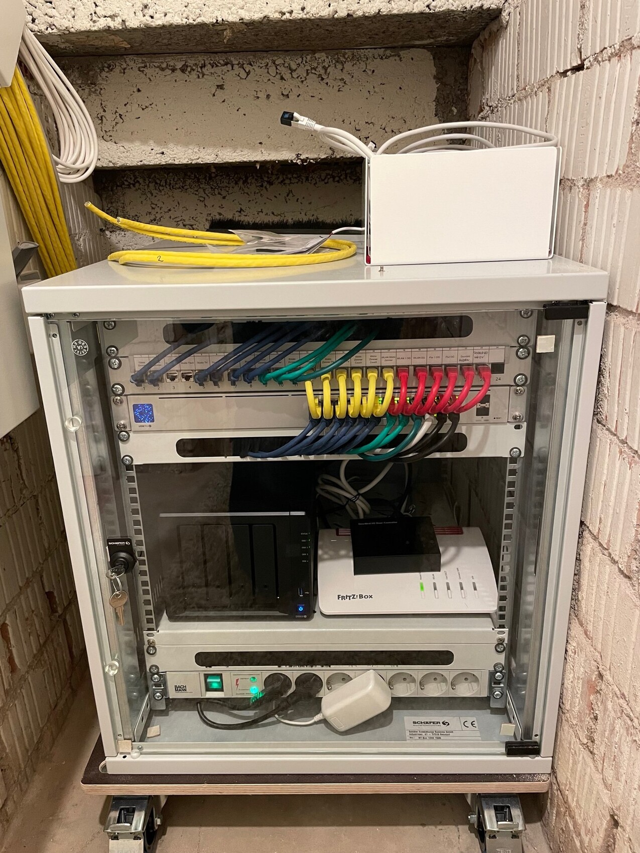

fromthisplace12 May 2023 14:40Dear community,
except for the NAS, which will be added at a later stage, the network cabinet is complete and I put it into operation today.
I’m very glad that I followed your advice and also chose the switch from Ubiquiti.
The setup was very easy and took less than an hour. I really enjoy the clear and user-friendly controller. I had to configure very little myself. The access points connected automatically, and the devices switch to the closer one without any extra configuration.
Here is the setup. I was inspired by @MBPassion. Many thanks again for this and all your help.

fromthisplace schrieb:
I was inspired by @MBPassion for this.Could you please link the post that inspired you? It’s usually hard to find otherwise. It definitely looks great. Thanks for sharing.F
fromthisplace12 May 2023 15:29Yes, of course! This is post #68 from page 12: (Note, no full quote)
