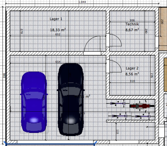

I have a question for you again: I met with the planner today and was informed that windows are not allowed in a garage built directly on the property boundary (at least in Austria; only allowed from a minimum distance of 2 meters (6.5 feet)). We have also planned two storage rooms and a utility room within the garage. So, my questions are:
1. Do you think having a window (transom) or natural daylight in the garage, storage rooms, and utility room is essential?
2. If yes, does anyone have experience with roof lights on flat roofs as an alternative to windows?

one option could also be a strip window in the garage door.Hello,
During a security consultation with the police, we were strongly advised against having a window in the garage or a strip window in the garage door.
This would give a burglar the opportunity to check if a break-in is worth attempting.
Of course, if you only have an old rust bucket inside, a window might even help prevent a break-in... 😉
Regards,
Dirk
Daylight in the garage is not really necessary for me. Ventilation and fresh air come through the garage door anyway. However, I have now planned a window facing south (next to the garage door) as a skylight, so that at least when walking toward the front door of the single-family house, there is some natural light in the garage.
The utility room in the current layout will also get a small window, since I can build it 2 m (6.5 ft) away from the property boundary.
What’s special in our case are the additional storage rooms inside the garage (we have a flat roof and no basement, so these rooms are inside the garage). I could live without daylight there as well, but especially in the storage room, some ventilation would probably be beneficial.
What do you think about a glass or plastic dome (not sure what the exact term is) on the flat roof that can be opened? Are these technically challenging or much more expensive than, for example, a skylight? Does anyone here have experience with this?
Here is the current garage layout (planned along the northern and western property boundaries; driveway/garage door on the south side):
Jochen
Jochen
