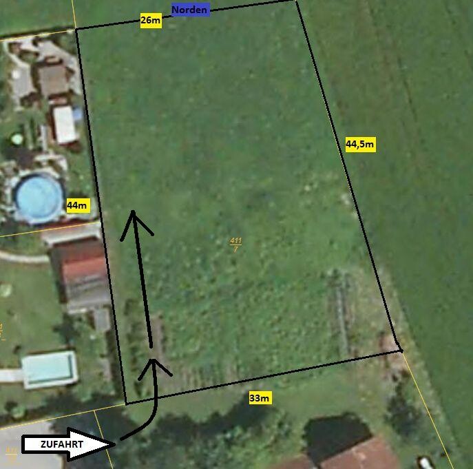

As mentioned, it will be a flat-roof house. The house is currently planned for the northeast part of the plot, with the garage in the northwest, to maximize the southern garden area. Here is the building site (no possibility of development to the north and east; west and south are already built on):

I would also be interested in the site plan and which roof type is planned and approved?
That's a nice, large plot of land.
Are there any building restrictions besides the 3m (10 feet) setback from the neighbors?
Are all the houses on the left single-family homes with pools?
I already noticed the sunny side being used for the children's bedrooms, and I think that's a good idea.
We only need to maintain the 3m (10 feet) setback as the building boundary, and the garage can be constructed right up to the property line.
Regarding the neighbors: On the first plot to the west (where the arrow marked "access" is), there is only a garden shed at the property line, and the single-family house is located further west (not visible in the photo). On the northern plot, there are only garden sheds and a caravan, and no single-family house yet (it will still be years before one is built there).
joho78 schrieb:
As mentioned, it will be a flat roof house. The house is currently planned for the northeast, with the garage in the northwest, to maximize the size of the south-facing garden. Here is the building plot (unbuildable to the north and east; already developed to the west and south):
Don’t underestimate the other sides of a house: it’s a good idea to have several seating areas for different times of day also in the east and north. In addition, some garden features are best kept out of direct view.
I don’t find the current layout ideal for the plot. However, the elevations are still missing, so a precise assessment isn’t possible yet.
