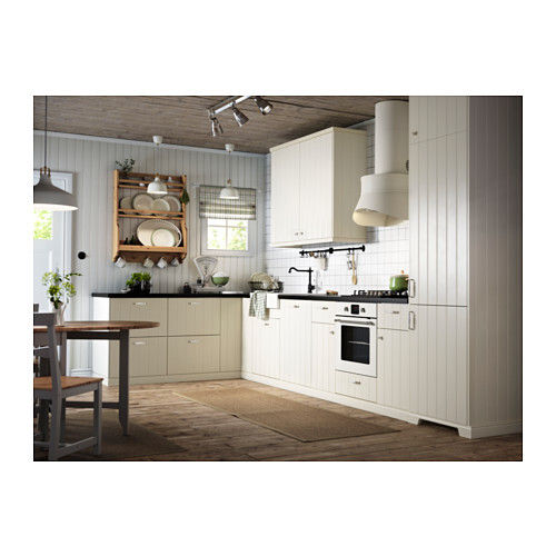

Personally, I don’t like the new fronts as much as the old ones. This is especially true for the display cabinets, which no longer have the crossbars... I guess I’ll have to live with that or choose something completely different.
