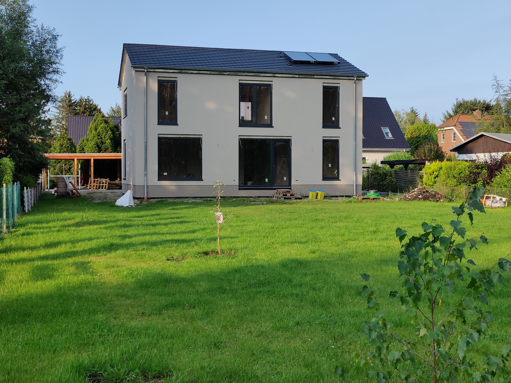

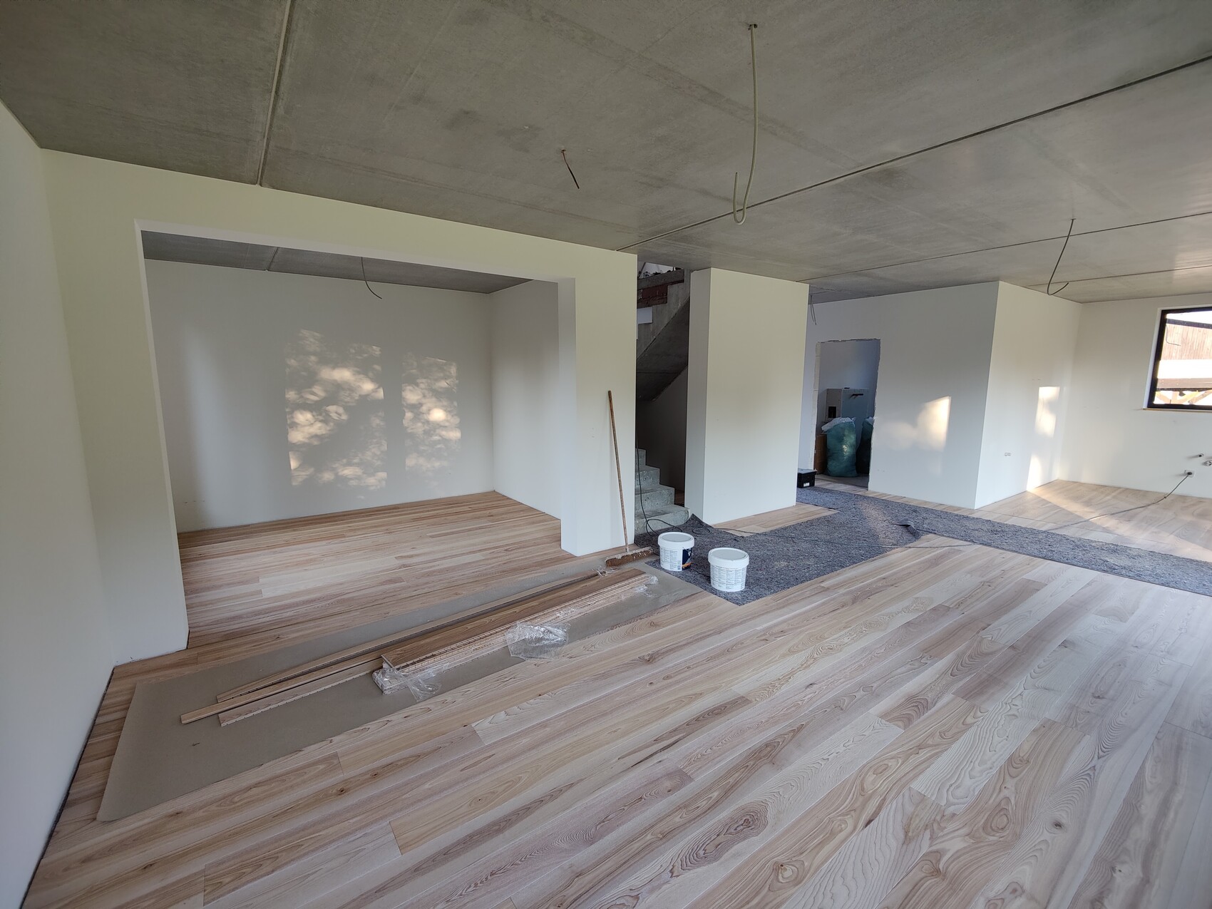

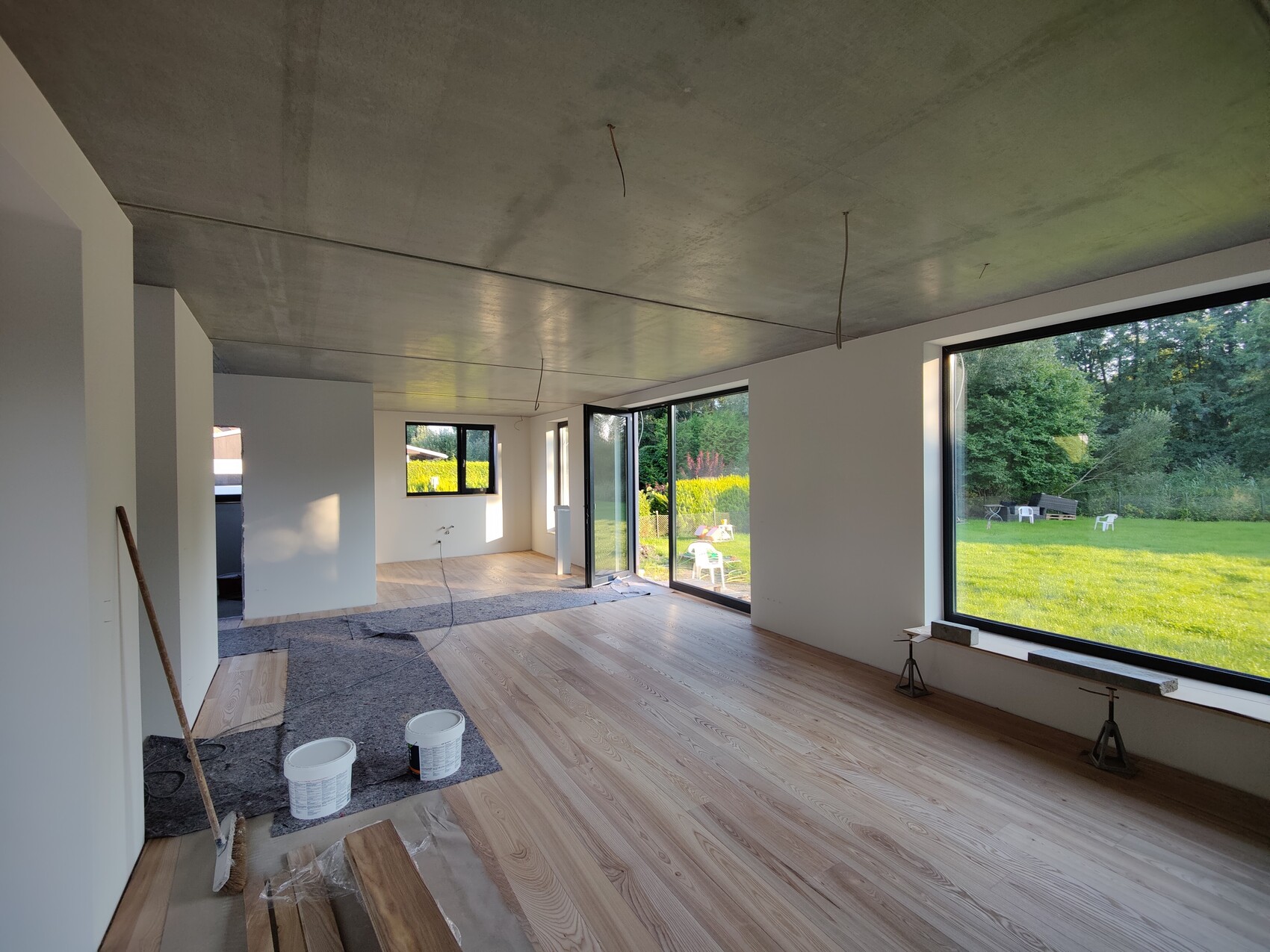

an update on our almost finished house (I guess a house is never truly finished 😉), where we have now been living for 2 weeks. Most of the photos were taken before we moved in â now you can hardly see the beautiful floors anymore, as itâs still quite messy :p. We are very satisfied; of course, you notice little things here and there, for example, the distance between the wall and the door in the utility room is only 65 cm (26 inches), which is a bit tight if you want to put a freezer there with a handle sticking out 7 cm (3 inches)⌠well, these are all solvable problems. We feel very comfortable! Especially the underfloor heating and the real wood flooring are wonderful, the new kitchen is incredibly ergonomic, and we have so much light and sunshine⌠And Iâm somewhat proud to say that we kept within our tight budget despite using high-quality materials for the interior finish (tiles, parquet). The house cost us 224,000 ⏠(about 224,000 EUR) WITHOUT pile foundation and additional construction costs like surveying, development, etc., but INCLUDING exterior shading. Without the DIY work and self-management, this certainly wouldnât have been possible! We did, among other things, the plumbing installation ourselves (my father-in-law), the underfloor heating, fitting of window sills and doors. This way, thereâs still a bit left from the loan, although with the endless list (removal of the construction road, embankment, entrance platform, terrace, garden landscaping, built-in furniture, insect screensâŚ) that will disappear faster than we can blink.
Thank you all again for the valuable input 🙂. Maybe Iâll show photos of the furnished house sometime â once the boxes are no longer blocking everything 😉.

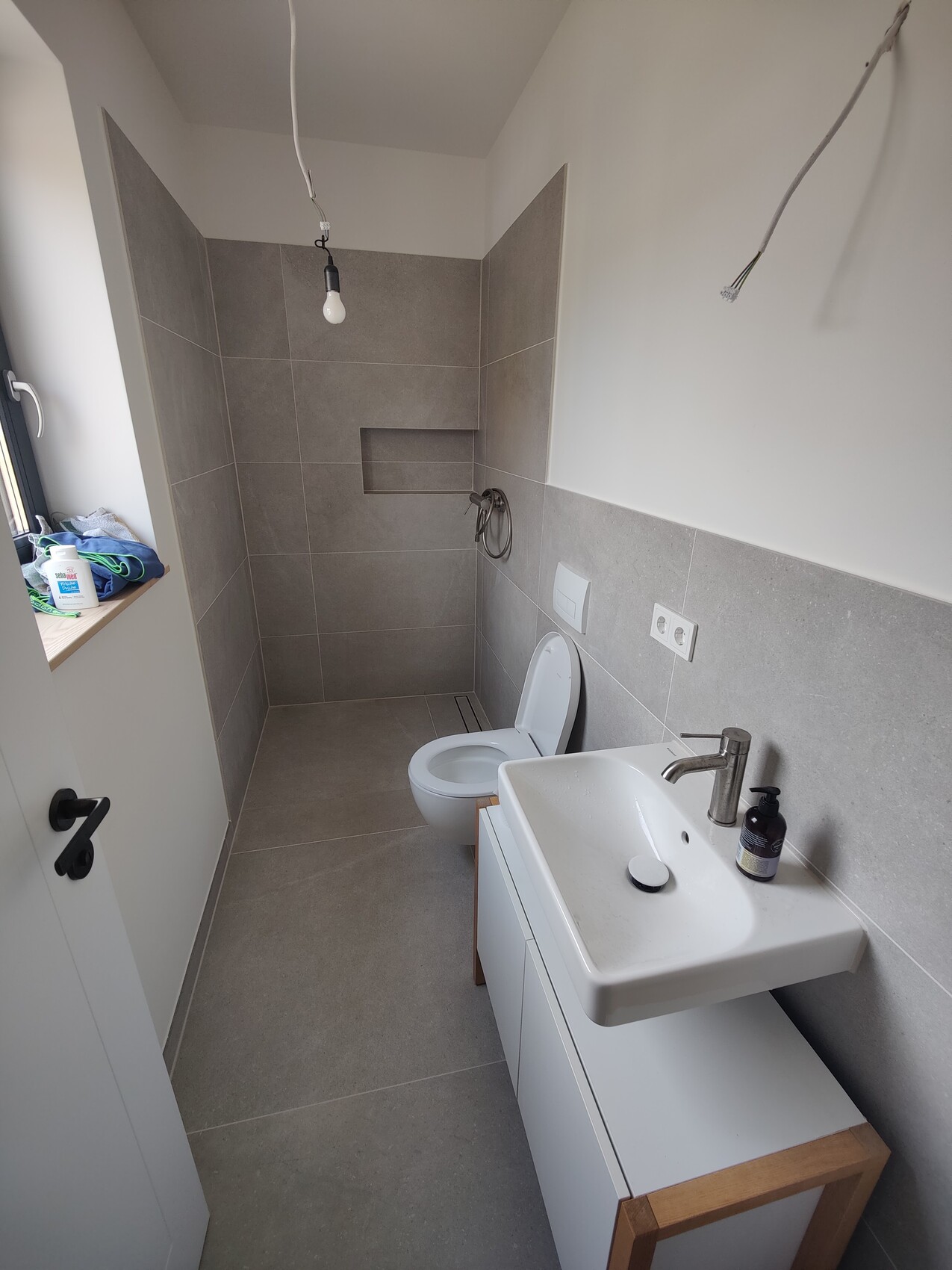

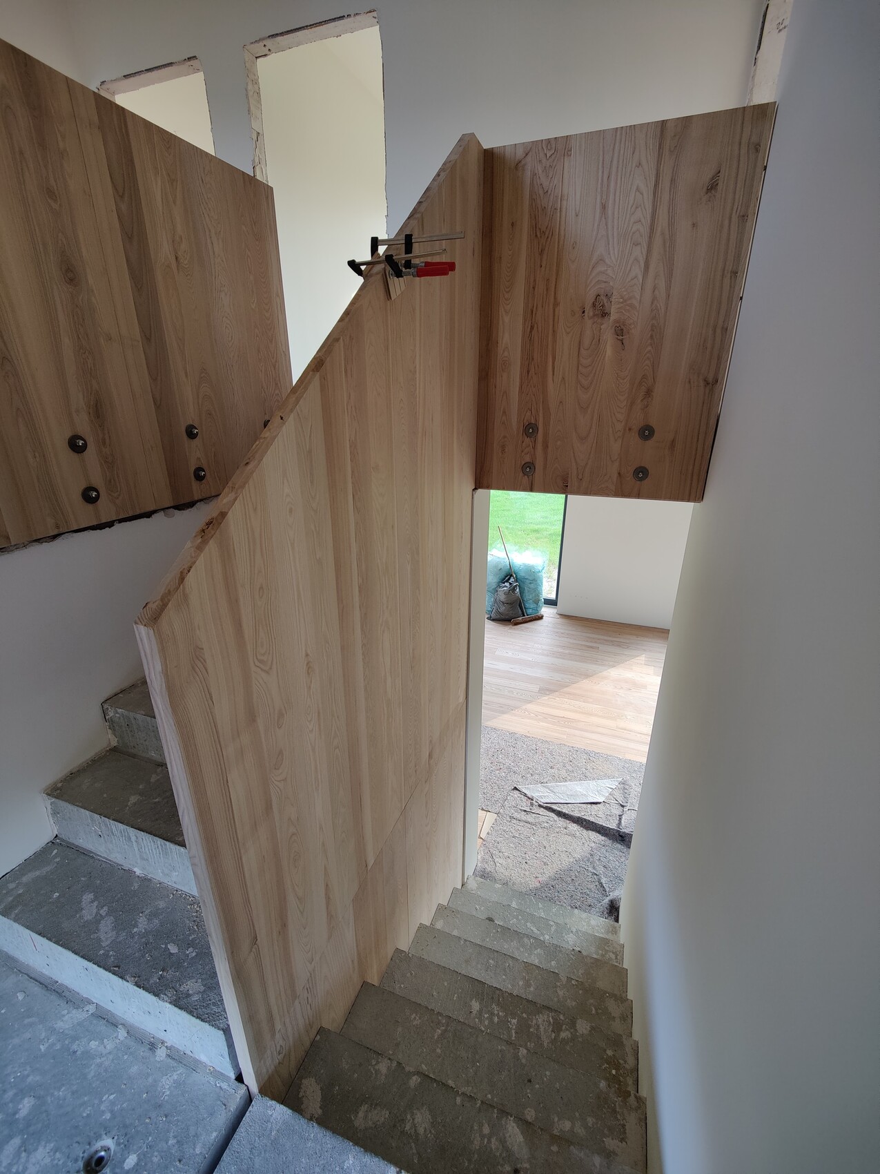

Looking at the third-to-last picture (171216), can we see the sewing area?
@11ant indeed not 😉. The "gallery" currently doesnât have a specific purpose â at the moment, itâs a storage room but is intended to become a reading and play area later. My sewing/desk area is planned in the walk-in closet (photo 4). Imagine a built-in wardrobe along the entire length of the left wall and a desk on the right. It looks very narrow, but it fits (the wide-angle photo is a bit misleading here).
