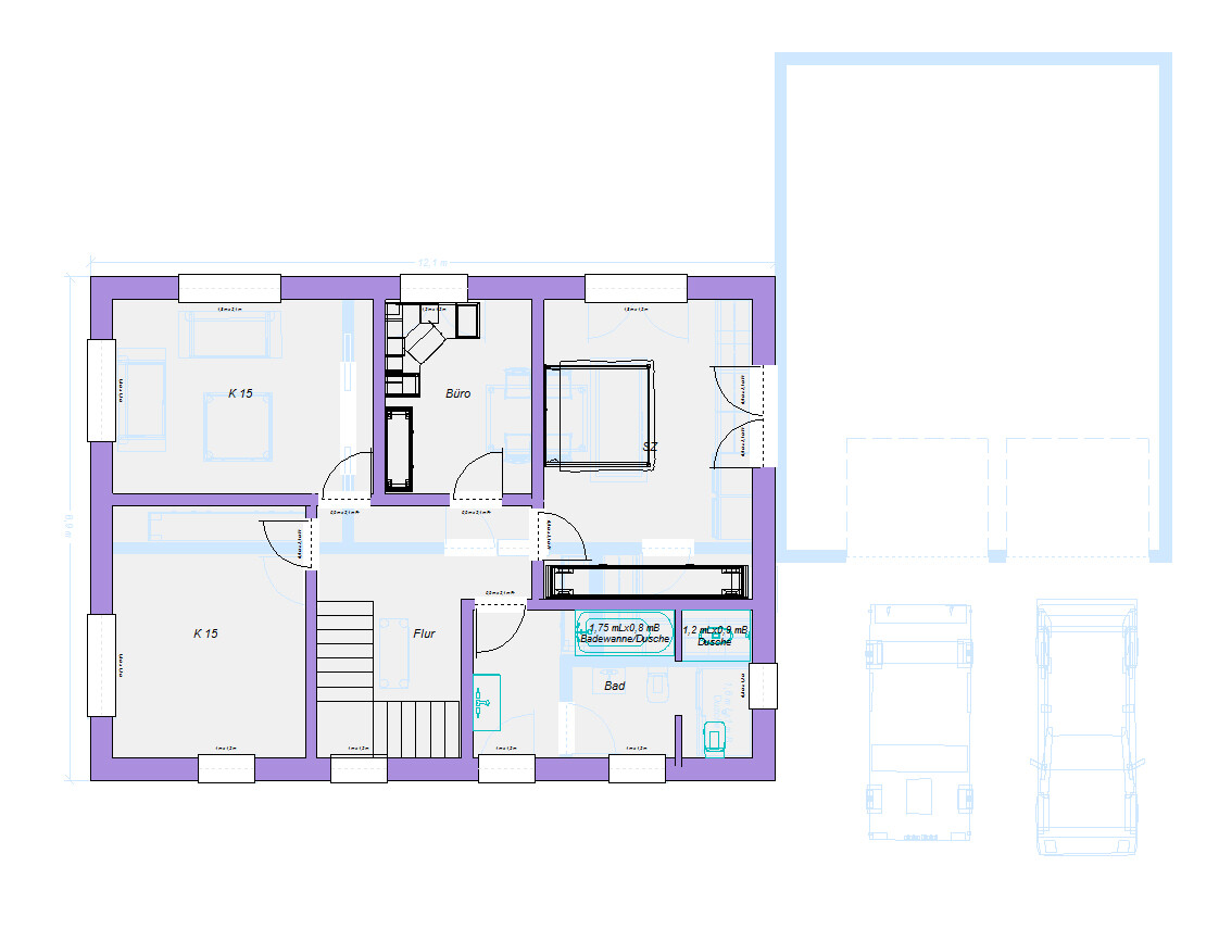

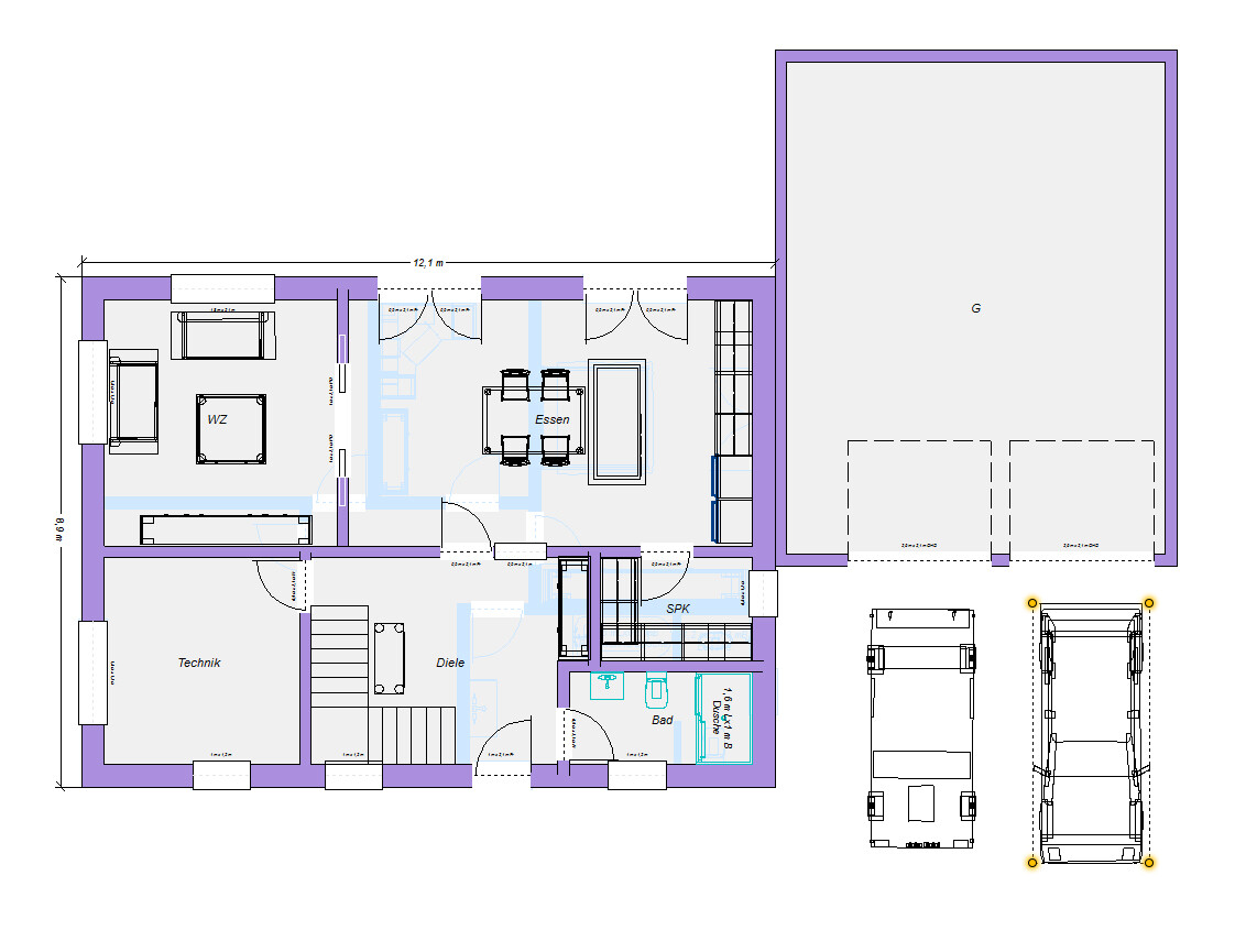

kaho6743 Dec 2019 09:24
*I don’t know how long Katja spends on her designs. She definitely produces a lot, which might be due to the software she uses.
This isn’t as simple as it seems. The main question is the orientation of the primary living spaces.
It’s easy to get confused here, which you can clearly see in the original design in my opinion.
I’ve now radically oriented the house towards the west and set the width to 12m (39 feet). The depth has been reduced accordingly to keep the costs neutral. I’ve removed the utility room door—sorry about that. Instead, there’s a proper pantry and upstairs there is an exit onto the garage as a future option. Also, the children's rooms are a reasonable size.
If the staircase starting next to the front door is not an option, you could simply switch to a half-turn staircase here. I just find this shape nicer. (The staircase does not have a landing! That’s a software error.)
Floor plan of a house with utility room, hallway, living room, dining area, bathroom, pantry, and a large garage for two cars.
Floor plan of a house with corridor, office, two rooms, bathroom, kitchen, terrace, and garage.
Maybe I’ll try another version with the kitchen and living room orientation like the original, but so far that has worked out worse.

kaho674 schrieb:
This is actually not that simple, even though it seems so. The main question is the orientation of the primary rooms.
It’s easy to get confused here, which I think is also evident in the original design.
I’ve now radically oriented the house to the west and set its width to 12m (39 feet). The depth was shortened accordingly to keep the costs neutral. I removed the utility room door—sorry about that. Instead, there is a proper pantry and upstairs there is an exit to the garage as a future option. Also, the children’s rooms have a reasonable size.
If having the staircase start next to the front door isn’t an option, you could simply switch to a half-turn stair here. I just find this shape nicer. (The staircase does not have a landing! This is a software error.)
[ATTACH alt="EG.jpg"]40503[/ATTACH]
[ATTACH alt="OG.jpg"]40502[/ATTACH]
Maybe I’ll try one more version with the kitchen and living area oriented like in the original, but so far that has worked out worse.
There’s a clear structure throughout, everything nicely arranged, I would take it as is.
