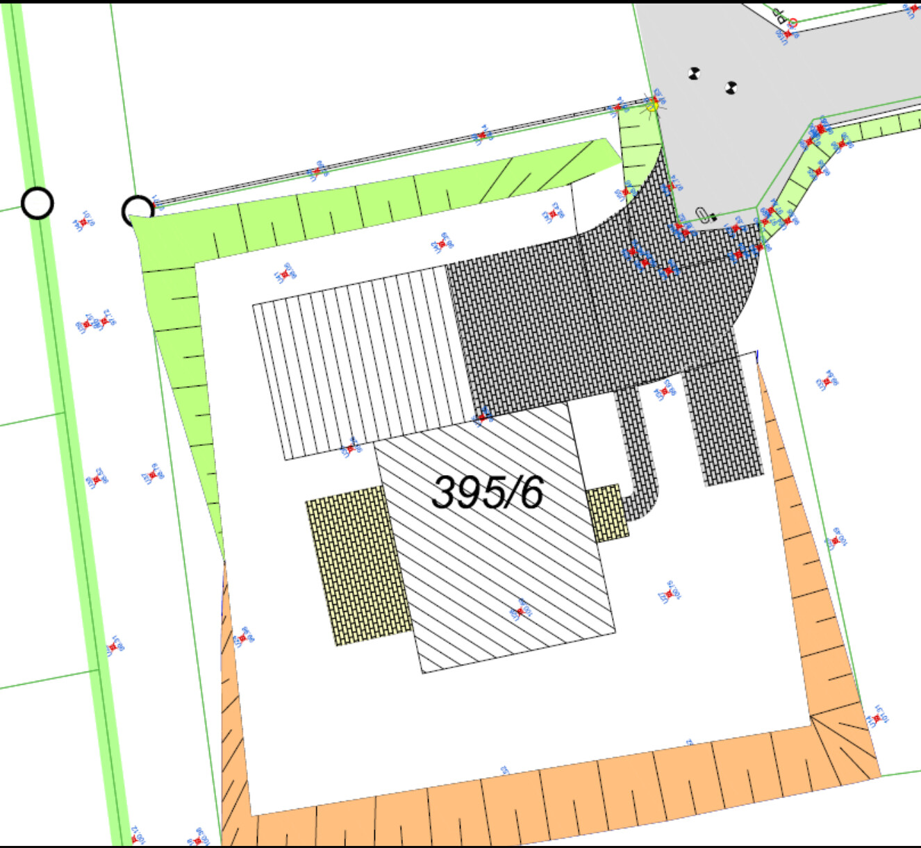

guckuck2 schrieb:
Does knowledge in earthworks also include the use and installation of L-shaped retaining walls to support the embankment? That would require budgeting a five-figure amount. Yes, that too. But the embankment will be sloped at 1:1.5 and planted with grass. I have more than enough space for that.
In total, there will be 560m3 (730 cubic yards) of excavation, with 200m3 (260 cubic yards) reused on site. Of course, the sewer connection and the empty conduits for utility lines will be installed before the embankment is built up to the foundation slab. This means I have already saved that excavation volume. Some homeowners with basements probably have even more earthworks at times.
I just like it when the area around the house is flat (my robotic lawn mower will thank me) and when I have an unobstructed view of the nature behind the property.
fskscorp schrieb:
That too. But the embankment will be graded at a slope of 1:1.5 and then grassed. I have more than enough space.
There is a total of 560m3 (735 cubic yards) of excavated material, of which 200m3 (262 cubic yards) will be reused on site. Of course, the utility connection pipeline and the empty conduits for the supply lines will be installed before the embankment is made, up to the foundation slab. In other words, I’ve already saved that amount of excavation. Some homeowners with basements probably have even more earthworks in some cases.
I just like it when the ground around the house is level (the robotic lawn mower will thank me for that) and when I have an unobstructed view of nature at the back.How do you manage surface water to ensure it stays on the property even during heavy rainfall?
How do you stabilize the embankment?
Lots of yard and driveway space, right?

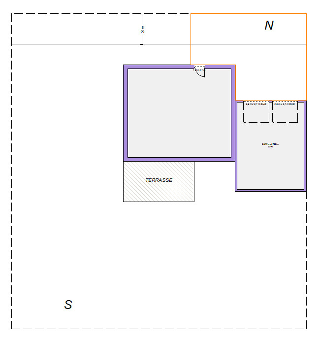

too much... Yes, terrible. I see the layout more like this:
Although I really ignored the heights here, since the original poster intends to demolish everything.
guckuck2 schrieb:
How do you manage surface water to ensure it stays on the area even during heavy rainfall?
How do you secure the slope? The area is not sealed. The slope crest is slightly elevated to prevent water from flowing over the top. It is not secured with additional anchors. According to ZTV E-Steuerberater guidelines, it is interlocked, covered and compacted one meter beyond the crest during construction, then regraded to the intended slope and finally planted with vegetation.
The house position was chosen to provide an unobstructed view over the field to the rear. To the south, there is a green belt with designated planting or woodland, as defined in the development plan. Therefore, the living spaces including the terrace are oriented towards the west.
