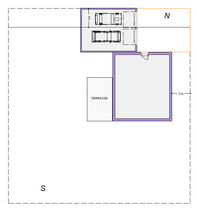

We are planning to make our dream of owning a home come true next year. So far, we have visited five general contractors and received fairly comparable initial offers from them. At this point, only two remain in consideration based on quality, reputation, price, and overall feeling.
The basic floor plan has been set from the very beginning, but we have continuously modified and optimized it and have not yet finalized a version, as we also want to keep an eye on construction costs. The attached floor plans include one initial design from the architect and one optimized version by me regarding the window placements and staircase location.
I would appreciate your feedback. Are there any critical issues we might be missing? What could be solved more intelligently? Perhaps something “unusual” that could be added quickly and without significant expense.
I am looking forward to your input!
Thank you very much!

Are there optimizations in the floor plan we have overlooked? All existing furniture except the kitchen is drawn to scale. Enough windows/light overall?

fskscorp schrieb:
It is not fastened at all. According to ZTV E-Steuerberater, it is interlocked and overbuilt by 1 meter (3.3 feet) during construction, compacted, then restored to the final slope and finally vegetated.So it is fastened after all
guckuck2 schrieb:
So it is compacted after all For me, compacted and stabilized means using riprap or something similar, or possibly soil stabilization using a binder. But I don’t consider it stabilized just like that.You will plant the area extensively (lawn, etc.) to prevent erosion. As soon as a sudden runoff heads toward the neighbor, that will also require discussion. For safety, you could install an edging or a swale at the boundary, possibly with drainage, to prevent any water from overflowing.
I have neighbors with L-shaped retaining walls who are now arguing because water is pressing through the previously celebrated, expensive, and initially attractive L-shaped walls...
fskscorp schrieb:
I positioned the house to have an unobstructed view of the field at the back. To the south, there is a greenbelt with designated planting/forest as specified in the development plan. That’s why the living area including the terrace is oriented toward the west.Yes, how terrible, I wouldn’t want to see forest and greenbelts either. Better tractors then! Just kidding. If west is the preferred direction, I would still try to minimize walking distances and maximize the garden area:
guckuck2 schrieb:
You will cover the entire area with vegetation (lawn, etc.) to prevent erosion. As soon as water runoff flows towards the neighbor, there will be a need for discussion. For safety, you could also install an edging or a swale along the boundary, possibly with drainage, to prevent any water from spilling over.
I have neighbors with L-shaped retaining walls who are now arguing because water pressure has built up behind those previously praised, expensive, and visually appealing L-walls in new condition... This neighbor has already excavated and built an L-shaped retaining wall. I have planned a berm about 1 meter (3 feet) wide along it. On this, I roughly shape a swale that directs water away from the boundary towards the western field path. If water does overflow, I have done everything possible to prevent it. I’m simply not a fan of these concrete elements, even though landscapers make a good living installing them. Since I have the space, I want to design it as naturally as possible.
kaho674 schrieb:
Yes, how terrible, I wouldn’t want to see forest and green strips either. Better tractors then!
Just kidding. If it has to be the west side, I would still try to minimize the paths and maximize the garden area: I actually like tractors Just kidding, but the forest does cast shade, which is definitely pleasant. However, we simply prefer the view towards the fields and then the forest beyond. It makes the whole space feel more open and bright. Thanks for your sketch. I want to do something like that too, but I plan to gently blend the height difference of about 1 meter (3 feet) to the street rather than build a large ramp. I just want to be slightly higher than street level because I find it more visually appealing. My hydraulics professor always said, “Build higher than your neighbor.”
Placing the front door where you suggested was also my first idea. However, this was not possible because we want the kitchen and dining area to face the terrace and want to connect the garage and utility room.
fskscorp schrieb:
Placing the front door where you positioned it was also my first thought. However, this was not possible because we want the kitchen and dining room facing the terrace and aim to connect the garage and utility room.
So you mean the useless utility room door to the garage is so important that you’re willing to pave half the lot? You’re also okay with that narrow space you call the dining room/kitchen and the car fumes that regularly drift inside? Hmm, okay.
