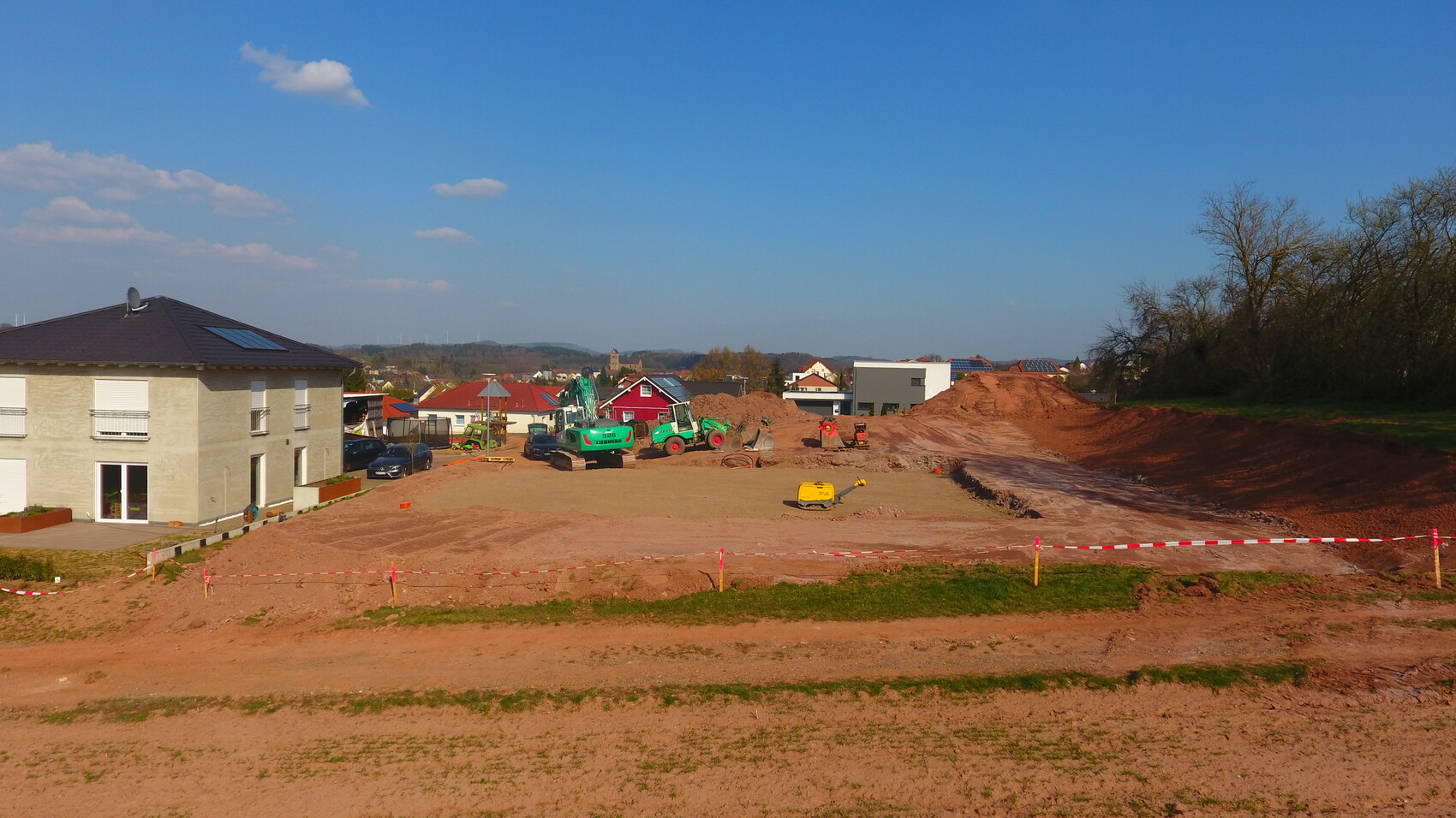

Last Monday marked the groundbreaking, and I wanted to briefly share the originally planned earthworks. The level of the top of the finished floor slab is now 1.30m (4 feet 3 inches) higher than the street in the preliminary development stage, so almost 1m (3 feet 3 inches) higher later on.
Some key figures for the earthworks:
- approx. 330m³ (430 cubic yards) of topsoil removed and stored
- approx. 600m³ (785 cubic yards) of excavated soil removed and stored
- approx. 350m³ (460 cubic yards) of excavation for the ring trench collector removed and replaced
- approx. 280m³ (365 cubic yards) of excavation for the actual building pit
- approx. 160m³ (210 cubic yards) of soil re-used in the fill area
- approx. 150m³ (196 cubic yards) of gravel installed
In total, 5 days of work (including the ring trench collector, installation of empty conduits and drainage) with two workers.
Hopefully, it is clear what this is going to become.
Now the structural builder can start work on the foundation slab next week.

fskscorp schrieb:
Hopefully you can see what this is going to be.It looks like a spot where you might soon have a deer visiting you too @kaho674https://www.instagram.com/11antgmxde/
