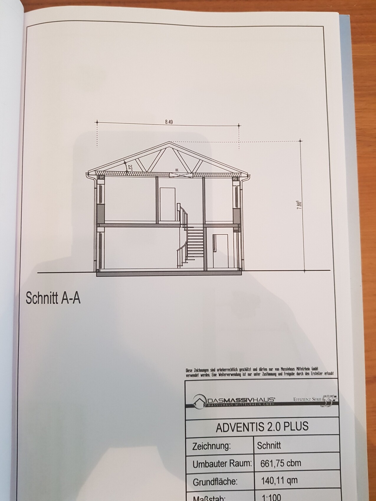

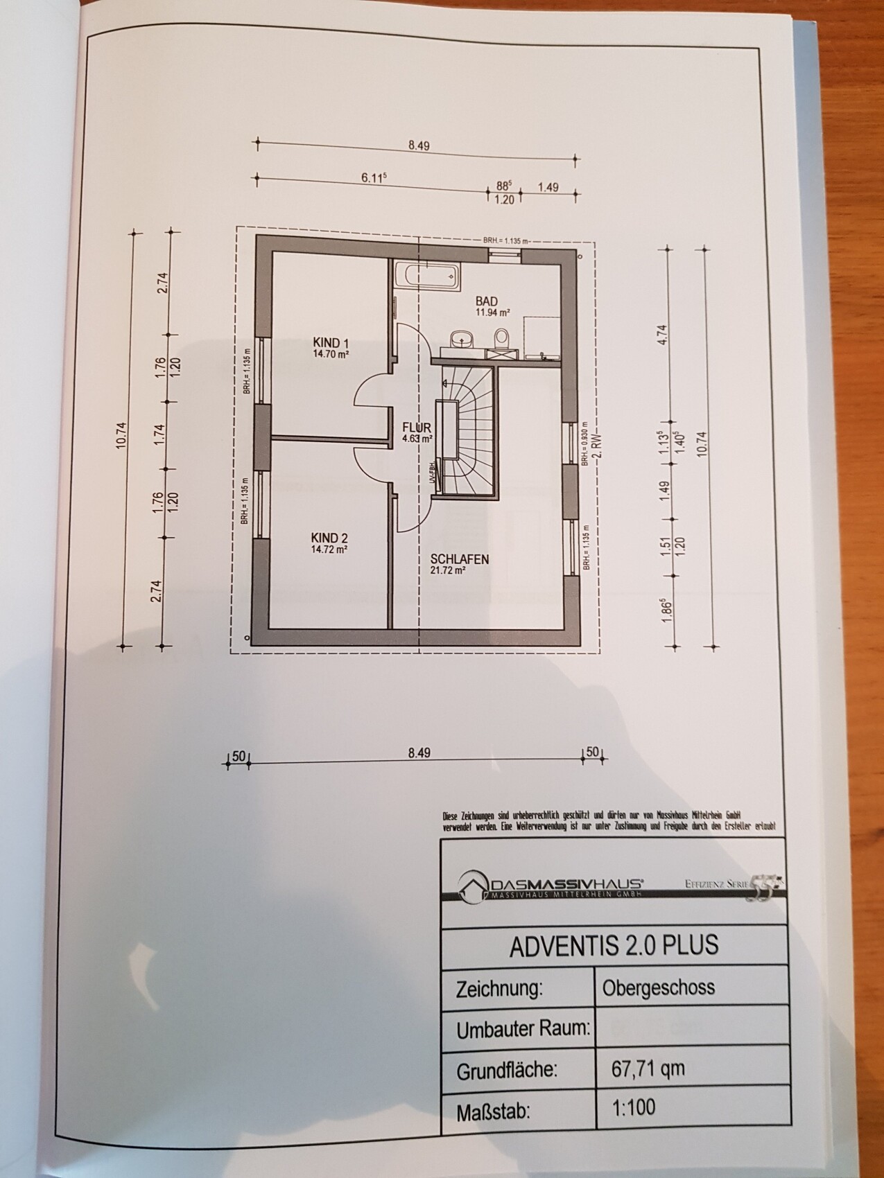

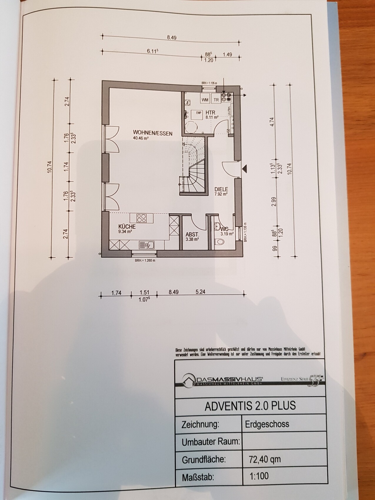

- Fingerhaus visited and pleasantly surprised us. The price is still pending, but they offered that we could do the plumbing, electrical work, and drywall ourselves. Unfortunately, they are inflexible; for example, they only allow an increase in width to 8.5m (28 feet) for an additional charge (the catalog house is 8.25m / 27 feet). The basement cannot be freely designed!
Then the company MHM came by; so far, a strong presentation and my gut feeling says wow, they seem to know what they’re doing.
They offered a top-quality house, fully tailored to our wishes, and gave good advice.
Offer: 365,000 with 140 sqm (1,506 sq ft) plus heated basement, exit to the south side from the basement, geothermal heat pump, ventilation, and KfW 55 Plus standard with 2 garages. House finished with brick veneer and Sting.
Follow-up post with photos to come.

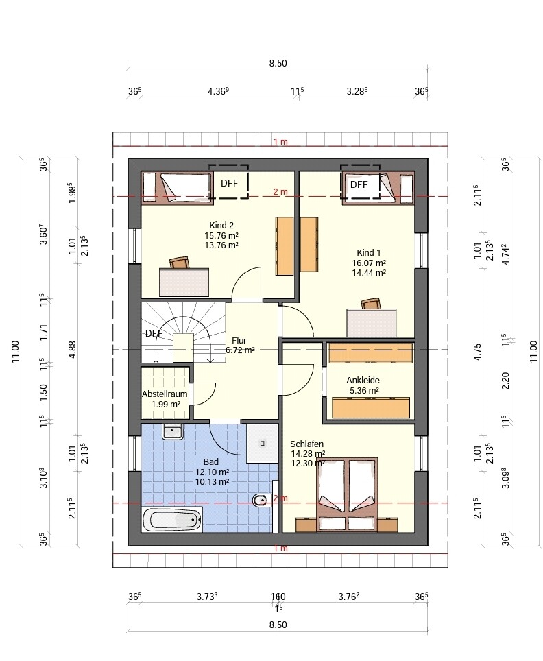

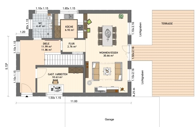

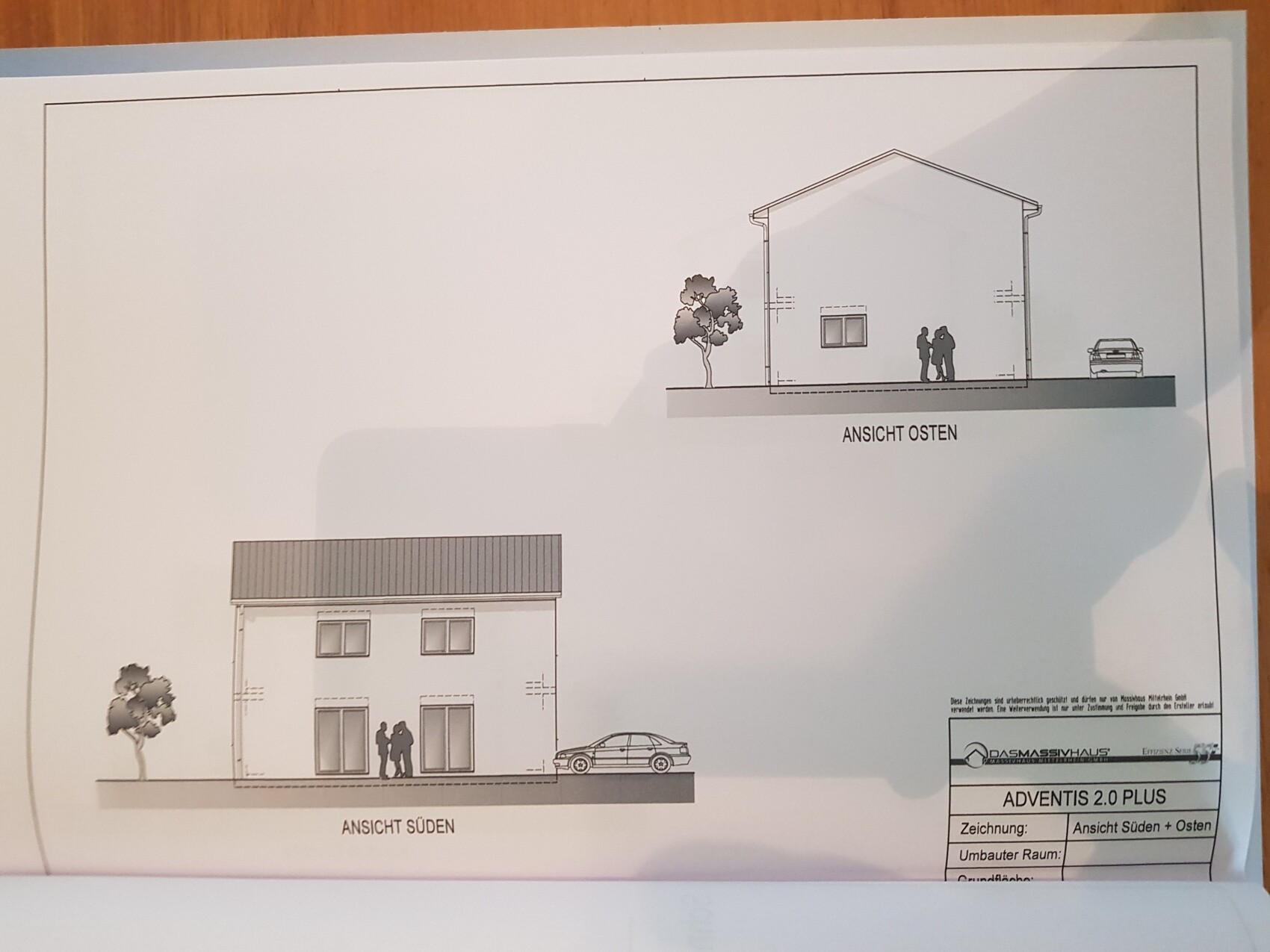

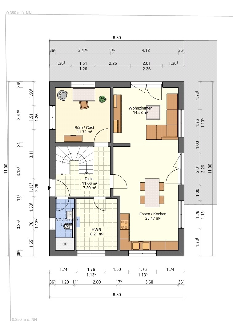

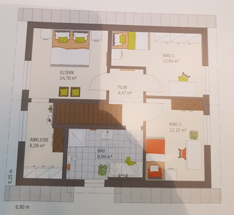

If you basically find the floor plan proposal from the catalog suitable, I wouldn’t expect much difference from a 25 cm (10 inch) variation in the house width; however, the lack of flexibility would be a drawback for me.
Massivhaus Mittelrhein is one of the few providers whose catalog gives me a consistently well-planned impression.
The house with the long side as the gable end strikes me as odd.
Apparently, the desire for an 8.5 m (28 foot) house width leads some providers to automatically think in terms of a semi-detached house, so they then take semi-detached house floor plans from the drawer and vary them by adding a fourth window side.
I find Fingerhaus too inflexible. They keep pulling out their Neo design over and over again – I’m getting tired of seeing it. It’s not that it’s bad, but this lack of creativity would be a deal-breaker for me.
The design from MHM is interesting – but with two children, having the staircase in the living room is not well thought out. You can’t even watch TV without the kids upstairs waking up. Still, the company leaves the best impression on me. They just need to revise the design.
The design from Baumeister is solid. It’s a textbook example of a standard design, which isn’t necessarily a bad thing. In execution, however, I don’t find it perfect, and it’s quite boring. Taking two months to finalize it seems like a joke? For me, they get zero points for innovation. They’re simply too unoriginal and too slow.
I would change all three floor plans. I like the one from Baumeister the most.

Take a close look at all three floor plans. Imagine living in the house – what bothers you, what do you like?
Draw in your furniture layout.
Compare the building specifications / scope of work.
