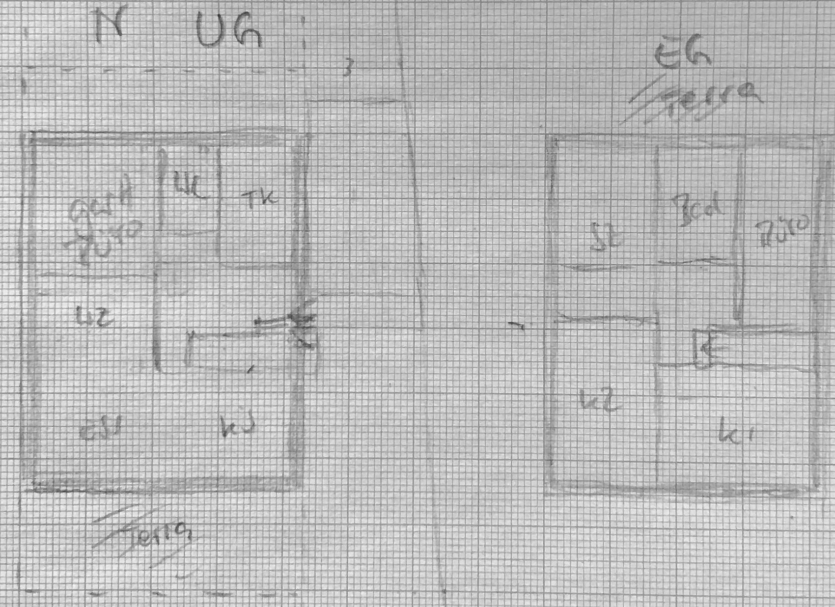

We do not have one yet! The plan below would be acceptable for us, but it needs to be made quite square. Has anyone worked on a similar project?
- Architect: We want an architect to help us but do not want to hire one unprepared.
- DIY: That’s why we want to gather as much input as possible.
What do you particularly like? To make full use of the building area, if possible. Why? So that there is not a 100-130 sqm (1075-1400 sq ft) house on an 815 sqm (8770 sq ft) plot, and we would like to have neighbors!
What do you not like? The 8.5 m (28 ft) width of the building area. Why? 10 m (33 ft) would be optimal for a nice semi-detached house.

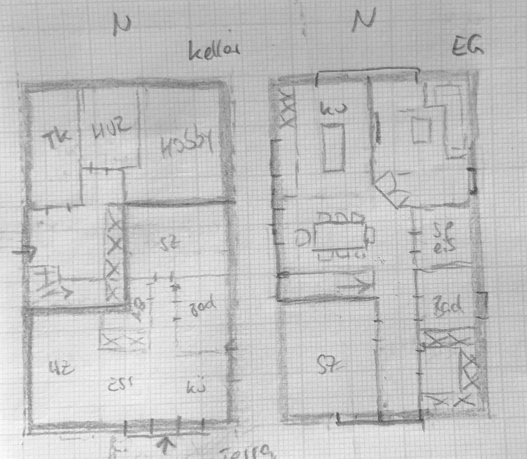

I quickly sketched something during my lunch break to show how it could be done.
Assuming there is little to no slope within the building plot (you haven’t answered that question yet), the result is a basement granny flat on the north side with excavation in front for access and a terrace. Windows could be placed on the west side, although then the north side of the plot wouldn't be properly accessible from the west.
Access for both units is from the east, with parking spaces/carports in front.
The main house has garden access to the south: a large kitchen with dining area, connected to the living room.
On the upper floor are two children’s bedrooms, a main bathroom, and an office, keeping in mind that the sloped ceilings reduce usable space upstairs.
The granny flat is relatively dark… so it’s not ideal, but just an example of how it could be arranged.
An alternative would be to place the granny flat in the south, have large windows on the west and north sides of the main house, and position the terrace to the north.

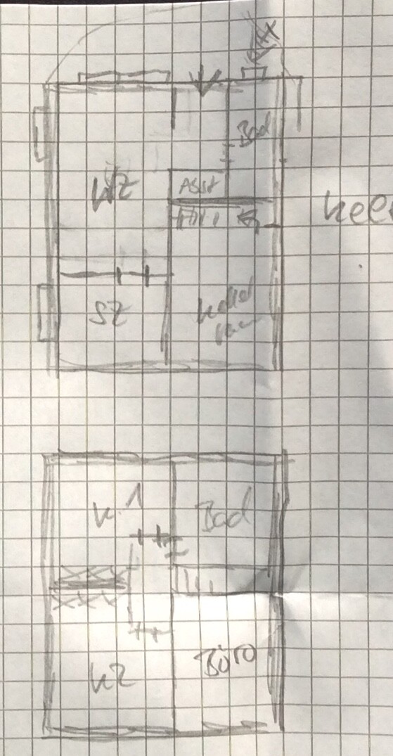

Thanks for the sketch. According to the surveyor, there is a slope of about 1.5–2 meters (5–6.5 feet) over 16 meters (52.5 feet) within the building plot. The neighbors five houses down to the left built like this: the basement has the entrance and living space with large windows and stairs going up. On the ground floor, you then have access to the garden (north side).
Basically, the side facing the street is two stories, and towards the back (north) it is one and a half stories. I hope this explanation is clear.
I don't find a north-facing garden too bad either! We’re not really sun lovers, and it doesn’t mean there’s no sun at all...

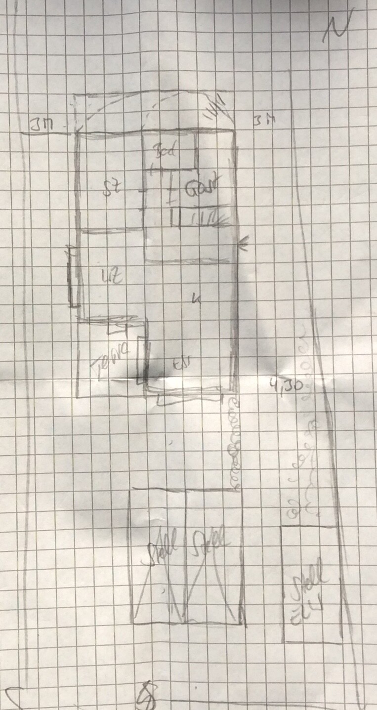

I have now opened the hallway to the south on the ground floor because of a window at the end. This is not necessary; the space could also be used more efficiently.
This is another draft, so there’s still room for improvement.
Accessory apartment: entrance is also on the terrace.
Main apartment is accessed from the west, terrace is on the north side.
The house is currently 14 x 8.5 meters (46 x 28 feet), but with some smarter planning, it could probably be smaller...
