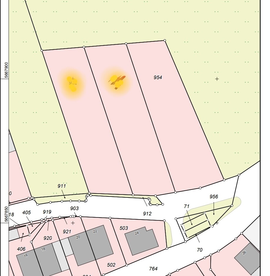

kaho6745 Oct 2018 17:43
Where is the road located in relation to your plot?
Sturkopf865 Oct 2018 17:58
kaho674 schrieb:
Where is the road located on your plot?
Parcel 954 would be ours....
Cadastral map: Several pink parcels on a green background, numbers 954, 911, 912.
11ant5 Oct 2018 18:06
The excerpt of the development plan is too small; it’s difficult to place anything in the surrounding context. From the limited information, I interpret the following:
The road is at the bottom of the plan, but the entrance is not from there,
  • rather it seems to be via a ramp from the lower right corner (at least that’s what the embankments suggest). Then, only the building setback area on the right side of the plan is designated for garages, which raises the question of why the left side is not? My assumption is that the indicated building envelope is only the right half of a semi-detached house plot shared with the neighbor, meaning the left side is intended to be built up to the property line.
  • I wouldn’t see a division of the property due to access reasons, but the second half is also not supposed to have a different owner. So why not use the “not being alone” arrangement vertically instead (i.e., a classic two-family house with tenants upstairs)?
    *[Edit: while writing, a larger excerpt was added – according to that, a full-width access from the bottom of the plan would be possible, but in connection with the embankment it remains unclear]
    kaho6745 Oct 2018 18:11
    When I look at the marked building area of 11.50 x 16 m (38 x 52.5 ft), it almost seems as if edge development is allowed and one semi-detached house is explicitly preferred, especially since there appear to be semi-detached houses on the neighboring lots as well.
    Is the drawing outdated, or is there new information? Do you have the zoning plan / development plan in front of you? Is there one? Are you sure about the 8.5 m (28 ft) building depth? I have the feeling that there might be a mistake here.
