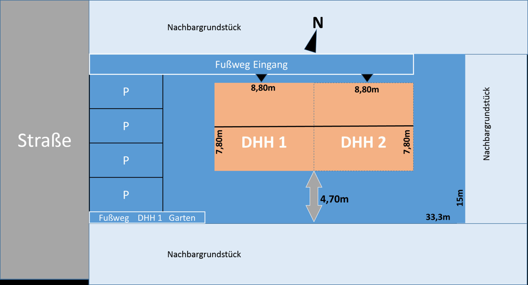

I plan to keep one half of the semi-detached house and rent it out. The second half I either want to rent out as well or sell—either immediately after completion if the project costs exceed my financial means, or later (for example, after 10 years).
The plot is rather long and narrow, so standard floor plans do not fit directly. The usual semi-detached house layouts tend to be “long and narrow” rather than “wide and short” or “square.” A wider layout does not necessarily seem better for usable rooms. How much larger than 8.80m x 7.80m (29 ft x 26 ft) should each half be? (Dimensions taken from the plot with some distance left for garden space toward neighbors, positioning the building volume accordingly; there is no strict need to adhere exactly to these, it's simply a starting point.)

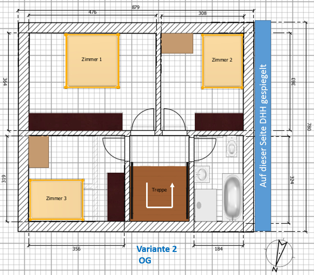

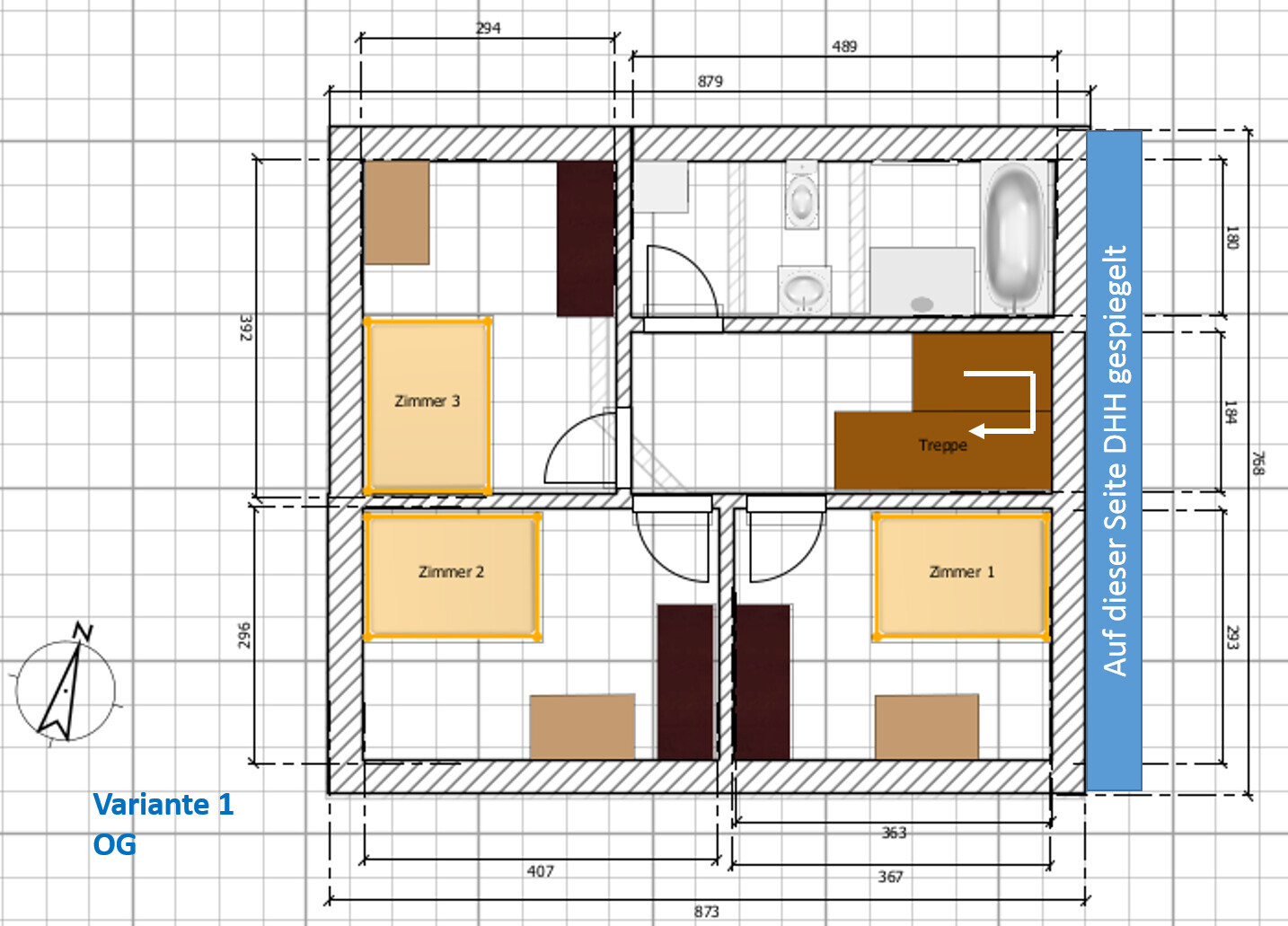

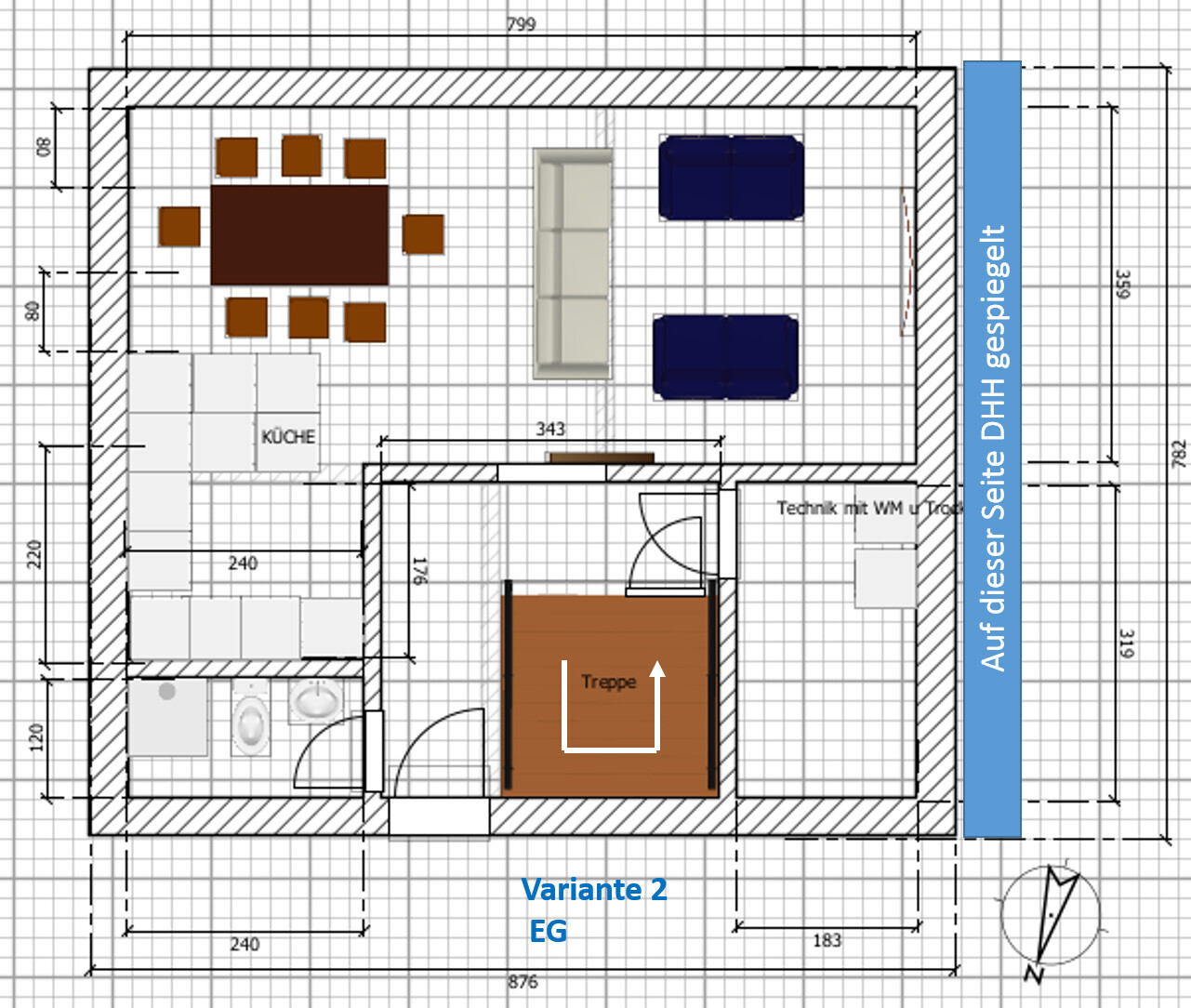

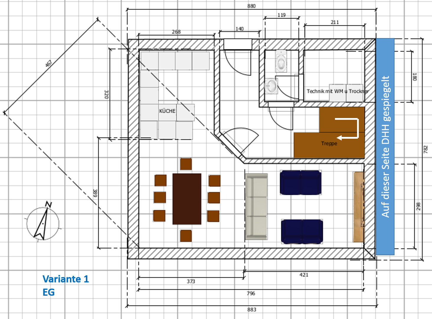

Since I have no clear idea of the required minimum size yet, I started designing a basic floor plan.
I also want to use this draft to compare prices from different general contractors.
I generated two different variants (plans for the ground floor, upper floor, and attic are still pending).
What improvements can be made? Do you have any other ideas?
Site sketch: plot (dark blue) with planned parking spaces, pathway, and building volume

Plot size: 499m² (5373 sq ft)
Slope: No
Floor area ratio: §34 Baugesetzbuch (Building Code)
Plot ratio: §34 Baugesetzbuch (Building Code)
Building envelope, building line, and boundary lines
Edge construction: 2.5m (8 ft) setback from the property line
Number of parking spaces: 2 per semi-detached half = 4 total
Number of storeys: 2

What do you particularly like? Why? Variant 1: Living/dining on the ground floor allows better use of space; Variant 2: room layout on the upper floor offers better usable rooms.
What do you not like? Why? Variant 1: Utility room on the ground floor is accessible only through the guest bathroom.

- Cannot give up: Utility room on the ground floor
