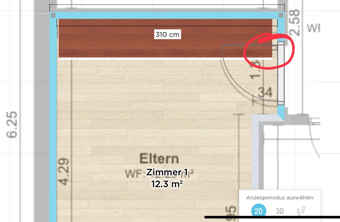

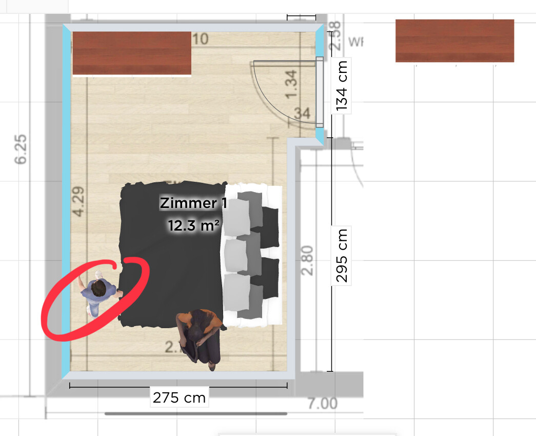

And that is precisely so there is enough depth for a sofa in the retreat area (right side of the plan, i.e. northeast).
Don’t get tangled up with your twisted drafts.
Also, removing the closet is not an option.

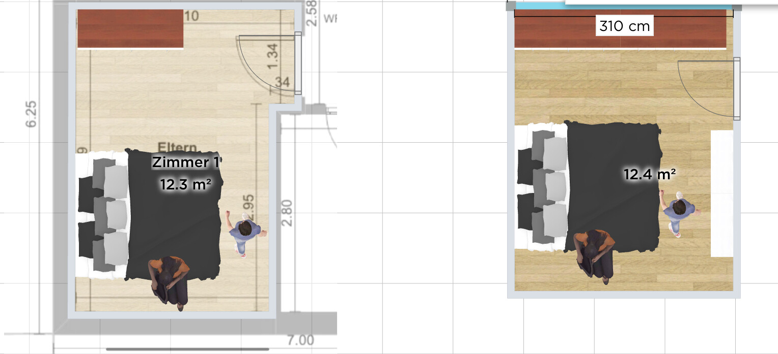

But if I can write, then a simple text program or pencil and paper is enough. Scribbling and crossing out is faster than mark and delete.
Here is the difference between a well-designed bedroom of about 12sqm (130 sq ft) and yours:
If the images are not enough for self-explanation, I don’t know what else to say.

philipp013 schrieb:But you’re not moving into a tool. A tool is just a tool doing what you put into it. It doesn’t say “Error” when something is simply poorly designed. Those who know about housebuilding can use a tool. Those with a deeper understanding can even manage with pencil and paper. It’s like with Word, LibreOffice, or simply a text file: just because I can type, my novel is not a book worth reading more than three pages or a bestseller.
I managed to get the furniture in the tool.
philipp013 schrieb:That is probably also allowed. However, the parking space area won’t change if you instead simply elongate the house rather than consider how to be happy with the yard on the plot. Because all the grandeur in the house is useless if you (to put it bluntly) cannot access the plot by vehicle.
except with an enclosed parking space (probably without a bay window)
philipp013 schrieb:No. You just calculated square meters or living area. Your WC doesn’t even have a door.
I don’t understand this, we based the small office and the small guest WC on plans from existing standard house types.
philipp013 schrieb:What applies below for the bedroom also applies to your office.
The office itself is actually just the right size for me because I don’t need more.
philipp013 schrieb:Tool or not:
So I managed to get the furniture in the tool, a 2m (6 ft 7 in) wardrobe just fits, a 1.80 m (5 ft 11 in) bed too, but of course there isn’t much space around it, we’re aware of that.
