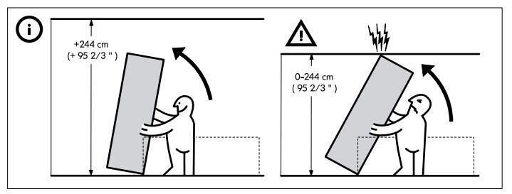

Wasn’t the question about the ceiling height with a Pax wardrobe that is 236 cm (7 ft 9 in) tall? Building a house and then having such a low ceiling height that you couldn’t even assemble a simple wardrobe lying down?
I would definitely reconsider the ceiling height; that is far too low!

Since we had to assemble the Pax standing up during our last move, I can only say: With two people, Ikea experience, and the appropriate height, it’s no more difficult or uncomfortable than assembling it lying down.

Yes, I have done that before, and it worked well. My comment was mainly because the question came up, and the general issue remains unresolved: the ceiling height in this kind of house design is, in my opinion, a no-go.
