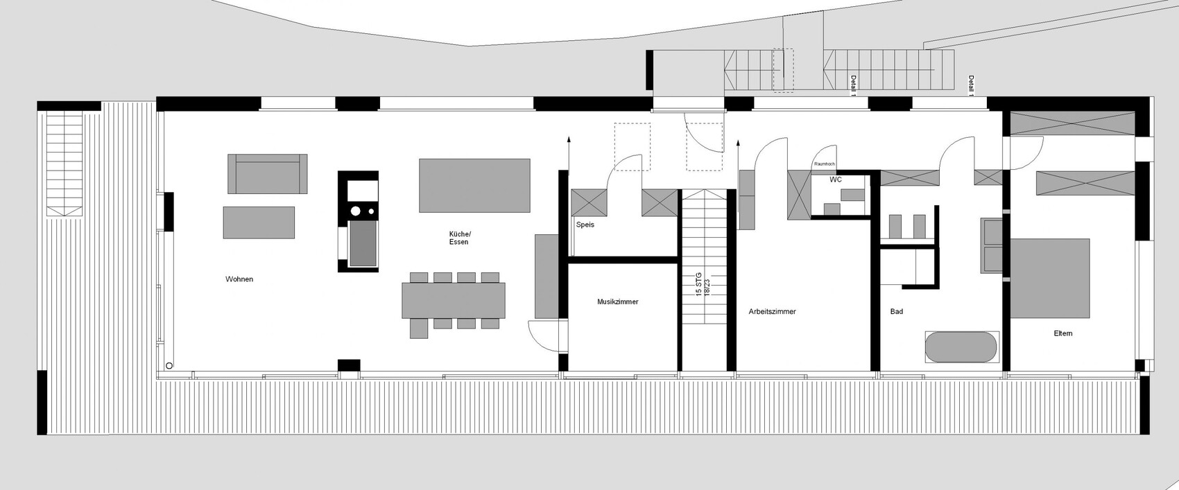

We have been planning and actively reading for over a year now. As our plans become more concrete, we would like to present our design and get your feedback.
First of all: Yes, the house is big. It is our dream, we are doing a lot of the work ourselves, and we know that we cannot extend it further — the situation here is a bit unusual, as strictly speaking this is only officially buildable land for a short time window.
A brief introduction: I am 36 years old and co-owner of an IT company. My partner is 31 and works as a lecturer. About two years ago, we found our dream plot — a little over 2800sqm (about 0.7 acres), with direct forest access and located in the third row. All neighboring plots are, as far as possible, already built on, mostly with former weekend houses or residential homes.
First, the questionnaire:
Building plan / restrictions?

Who designed it:
The design was created with an architect, based on our drafts.
High ceilings and visible ceiling beams on the upper floor, separated area upstairs for us, the fireplace room as a second retreat, the single-story “extension” for the dining room, the large kitchen, the fireplaces... and especially the abundant wood.
What don’t you like? Why?
The gable windows should get an added triangular top to maximize light. The current window layout feels a bit outdated. We actually wanted an open void, but this can’t be sensibly integrated. Heating is a constant issue and never fully resolved.

The architect received a draft from us, every room was discussed beforehand (use, size, contents), and the design was revised multiple times. We like that it implements nearly everything we wanted and that the house does not look too bulky — due to the half-hipped roof and the gables, it does not seem so on the plans at least.
What is your most important / basic question about the floor plan in 130 characters?
Apart from the effort for plastering: is the floor plan practical? For example: washing machine on the first floor where laundry occurs, bathroom for the children...

- All windows can be opened.
- Sliding doors open outwards, not inwards.
- All dormer windows will not be rectangular but have added triangular tops.
- Between the hallway and living area there is no central post; instead, a large double door is planned.

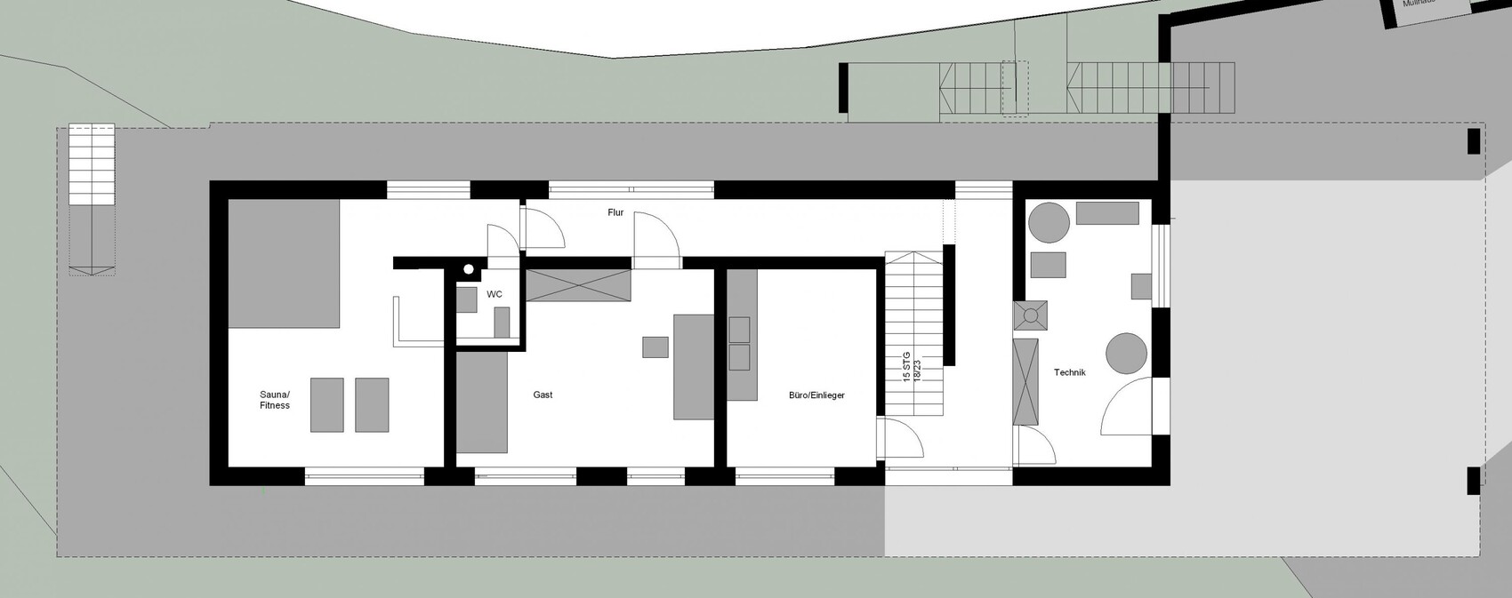

- The basement has a technical room beside the stairs, designed as a through room. In my opinion, this is a poor solution; we probably also need to plan a separate boiler room.
- Where the embankment is drawn, doors will be installed. This will allow the large rooms to get natural daylight and be usable living space.
- The stair step projecting into the hallway is bad and will definitely be removed.
We have also been thinking about other things:
- The hallway upstairs is planned as a “library.” To bring in light, we intend to use two light wells with diameters of 30–35cm (12–14 inches). The advantage: it will never be completely dark at night when someone needs to use the bathroom.
- The fireplace will be a soapstone stove; no plan exists yet. Strictly speaking, it will not stand against a wall but form the wall itself. We also planned a second connection in the fireplace room; originally we wanted a tunnel fireplace but were convinced it’s not a good idea as a room divider.
- The children’s rooms are not ideal — one faces north, the other south. We could make two narrow, elongated rooms and a corridor so both face south, but we consider that clearly suboptimal.
- All doors on the ground floor will be 1m (3.3 feet) wide to at least accommodate wheelchair access reasonably.
I think that’s it. Thanks for your opinions!
Sorry, I just realized that I made things worse in the second-to-last post:
The children’s area should be located above the parents’ area, where the area on the left refers to the clients’ parents.
Climbee schrieb:
But here I would plan the children’s area above the client area (I used the term parents’ area for the clients’ parents), and possibly the children’s bathroom could be located above the entrance area.
sichtbeton8210 Jul 2018 14:01I also saw the symmetry more as an ironic own goal – but I actually do miss the mentioned symmetry.
And since you mentioned the gymnasium – yes, I see it too: with partition walls to make it habitable for the refugees.
Just because your listed needs are met there doesn’t mean it’s a successful design. I can’t really imagine those long corridors with a ceiling height that feels oppressive from above. But I can picture it... I have a similar corridor in front of my office, though thankfully with a higher ceiling.
Has anyone already suggested consulting the architect? I mean: if you look at the placement of many doors, combined with the lines as walls and the scale of the staircase compared to other reference sizes, I don’t necessarily see an aptitude or talent for spatial thinking and its translation into 2D.
