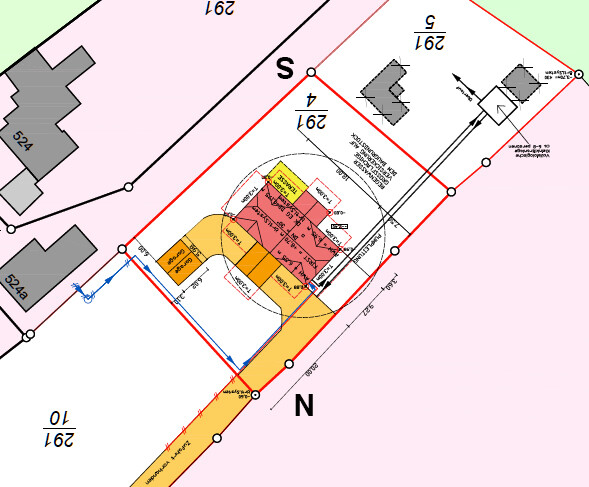

Unfortunately, I find it quite difficult to understand the original poster’s exact wishes. They keep mentioning that very little of the initial design remained, which is why a sharp cut was necessary. What exactly were the wishes that caused this cut?
I found Climbee’s design at least somewhat better. Although, in my opinion, it seems a bit reversed—the sun should be coming from the top left side of the plan, I believe. I’m also afraid the design might be overall a bit tight for the original poster. Besides, without an upper floor, it’s obviously only a starting point.

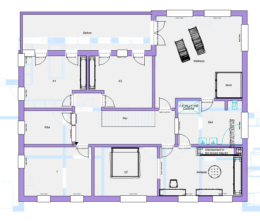

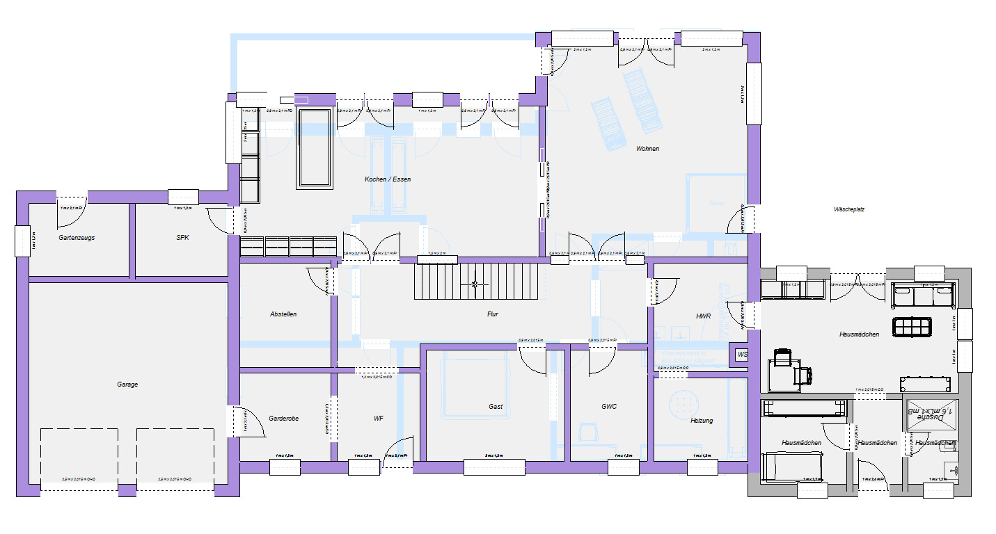

There are certainly a thousand possibilities with a budget like this. Here is one option to gather ideas.
The living area is on the ground floor with direct access to the terrace. Above is an additional balcony with a wellness area and children’s rooms facing south. I drew the garage next to the house, as it was in the last design, but it could also be placed elsewhere. Optionally, there is a maid’s annex, which can also be used as a separate apartment.
Grundriss eines Hauses: Küche, Essen, Wohnen, Flur, Garage, HWR, Heizung, Waschplatz.
Grundriss eines Hauses: Wellnessbereich mit Sauna, Bad, Flur, Schlafzimmer, Ankleide, K1, K2, Balkon

I thought the sun comes from the top right? Okay, then it's mirrored.
But small??? The living/dining/kitchen area is 80 sqm (860 sq ft), the pantry about 8.5 sqm (90 sq ft), and the granny flat about 80 sqm (860 sq ft). I actually felt it was rather oversized...
kaho67412 Jul 2018 13:38
Climbee schrieb:
I thought the sun comes from the top right side of the plan?
Oh really? Wait, let me check...
kaho67412 Jul 2018 13:44
It is already top left on the plan.
Site plan of a residential area with colored zones, boundaries, and compass.
Climbee schrieb:
But small??? Living/dining/kitchen area is 80m² (860 sq ft), pantry about 8.5m² (90 sq ft), granny flat approximately 80m² (860 sq ft). I actually had the impression it was oversized...
Oh, I see, then I misjudged it.
