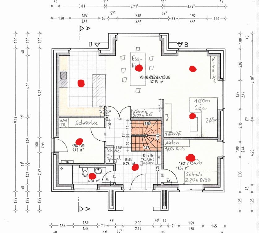

HausbauTiNa18 Oct 2018 15:11The frustrating thing is that I’m an electrical engineer and covered all of this during my studies… but when do you really apply lighting design in practice?
We will consider the typical ceiling outlets. In everyday life, we usually have indirect lighting on, except when vacuuming or similar tasks.
That means we will use floor lamps as well as wall lamps.
In the attachment, we have marked the points (in red) for the ceiling outlets. Do you have any comments on that?
We also find surface-mounted LED spotlights/downlights quite appealing.
What are your thoughts on this?
Mottenhausen18 Oct 2018 15:16Are you serious? That’s far too few—only one vent per room? Five in the bathroom, five in the downstairs hallway, four in the kitchen, and so on.
Aliban201418 Oct 2018 15:41Mottenhausen schrieb:
Are you serious? One outlet per room is far too few—five in the bathroom, five in the hallway downstairs, four in the kitchen, and so on.It depends, since she wants a lot of indirect lighting, which is quite reasonable in my opinion, so it could actually work. In the planning phase, you only see the direct lighting.

HausbauTiNa18 Oct 2018 16:00Mottenhausen schrieb:
Are you serious? That’s way too few, just one ceiling outlet per room? Five in the bathroom, five in the hall downstairs, four in the kitchen, and so on.The ceiling outlets refer to traditional light fixtures.
If using downlights, obviously more should be installed.
How much did you have to pay per additional ceiling outlet?
