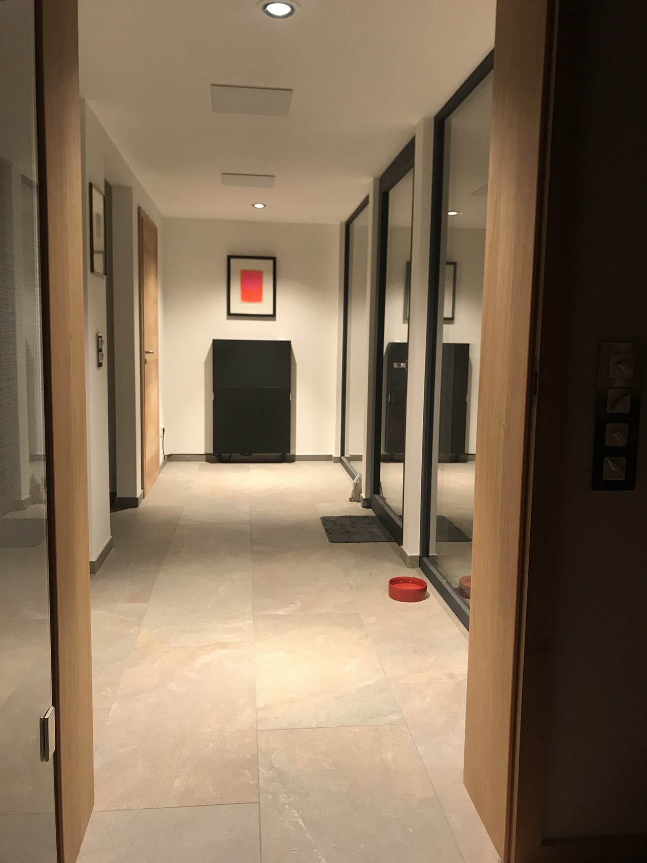

Take a look at the Ansorg Coray series for recessed ceiling lights for the hallway. Two units are sufficient for the hallway if you consider the living area. We achieve extremely pleasant, color-accurate, and even lighting with these. Diameter and installation depth should be taken into account.
Technically, this is retail lighting—but simply done excellently.
Bright office hallway with glass walls on the right, black cabinet at the end, red picture frame on the wall.
In case anyone notices: yes, the lamps and square heating elements are not centered in a straight line.

But there is also a third lighting fixture missing in the middle.
And yes, those offset heating units, argh.
