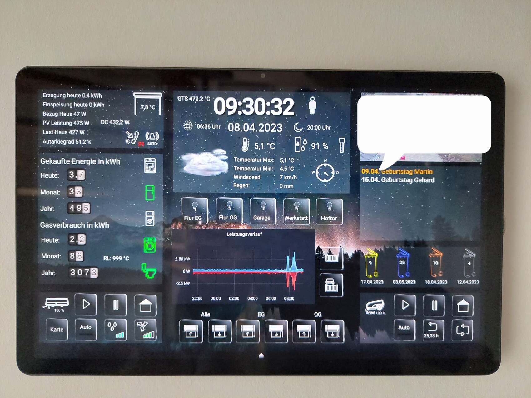

So, I’ll admit I’m a huge iobroker fan.
I’ve been running the system steadily for 2 years now. It integrates, among other things, Shellys, Homematic, robot vacuums, robotic lawn mowers, photovoltaic system, washing machine, dryer, dishwasher, NAS, etc.
You have to say, it’s quite a powerful tool. There are many small and large scripts running that are supposed to automate everyday tasks to some extent. I also created a visualization that’s displayed on a tablet mounted in the hallway and constantly powered.
It looks something like this.
Tablet display showing home automation and energy dashboard with time, date, weather, and consumption data
When it comes to networking, I can imagine that it’s possible for you with plenty of time and patience. But for a guest without any fallback option, I agree completely with others. For example, what happens if the guest doesn’t charge the tablet or fiddles with it so the visualization disappears? Or if the tablet crashes, etc.

Hi, okay, that looks good!
So, IO-Broker…
The tablet—I planned to securely mount it in a steel enclosure on the wall with charging… it shouldn’t be carried around all the time.

Well, if you want to cover all the scenarios you mentioned—heating, air conditioning, blinds, lighting—you’ll need to write quite a few scripts for that.
It’s definitely not something you can just click together quickly. I’ve already spent a lot of time getting everything to work smoothly, not to mention the visualization.
You should also keep in mind that the visualization in iobroker only runs in a web browser. Occasionally, Firefox (in my case) may freeze briefly. That’s not a problem for me; I just reopen the app, and the visualization reloads.
But who will handle that for you?
