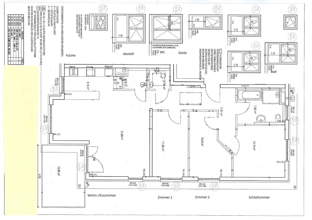

has anyone ever installed the main lighting in a house or apartment using LED strips?
Possibly integrated into a drywall ceiling and walls?
Or is that too prone to issues?
What should definitely be considered during the planning stage?
The apartment consists of a bedroom, bathroom, two kids’ rooms, hallway, storage room, guest toilet, and a combined living, dining, and kitchen area, as well as a balcony, with a total living area of 106 m² (1141 sq ft).
Thank you very much for your advice.

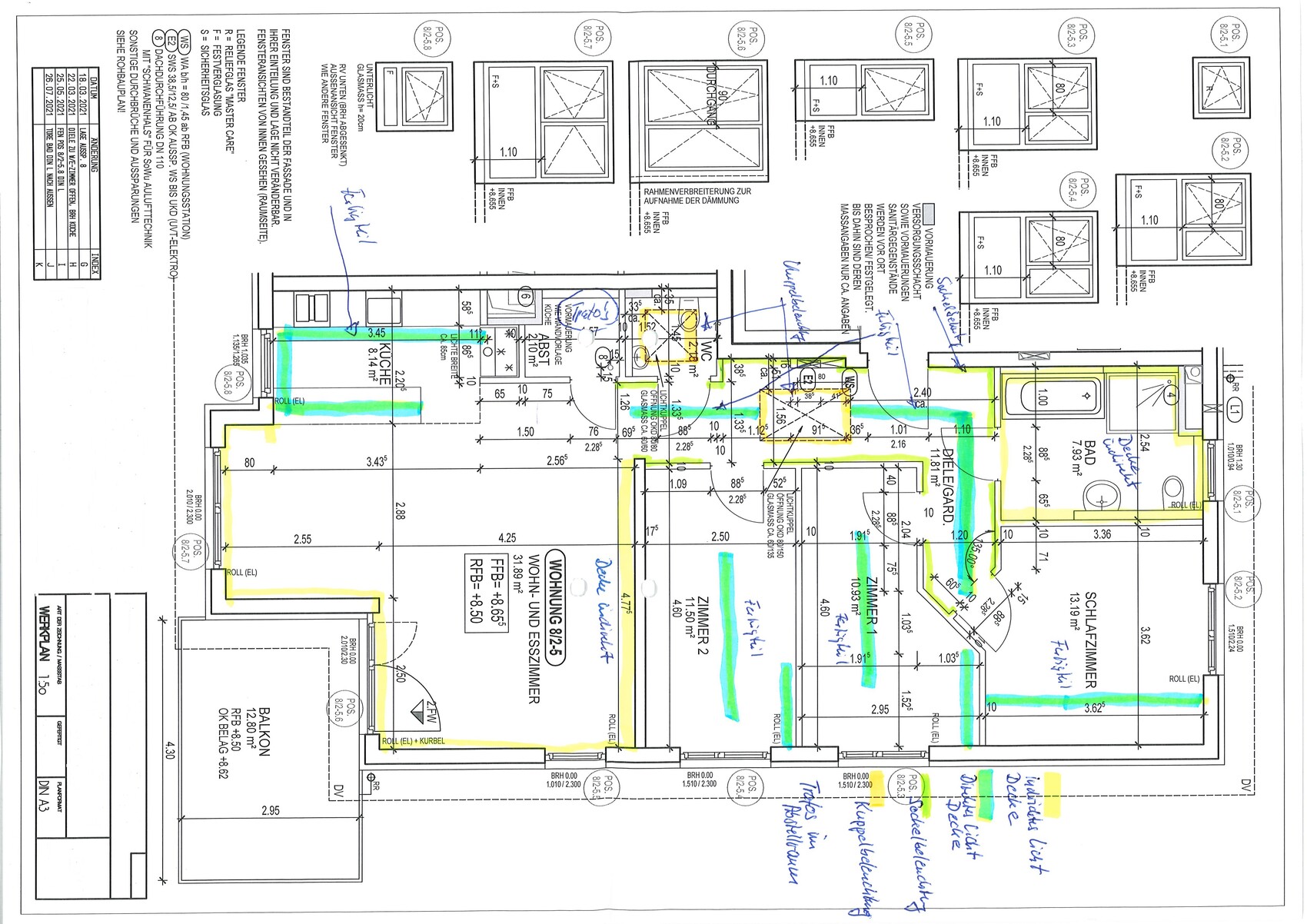

JürgenJosef21 Aug 2021 09:33Hello,
attached is the lighting plan.
In the dining area next to the kitchen, a pendant light will be added, and a ceiling light will be installed centrally in the living room. In the bedroom, reading lamps will be mounted on the bedside tables. The mirror in the bathroom is 1.20 m long (3.94 ft) and has integrated LED strips at the top and bottom. The mirror in the guest toilet also has LED strips. Along the balcony wall, an LED strip will be installed. This should complete the lighting setup.
The power supply cables will be routed centrally to the storage room into the suspended ceiling, where the power supplies will also be housed (inspection access).
It still needs to be decided which KNX system (Busch-Jäger or Jung) or which lighting control system will be used.

What is your assessment, especially regarding the lighting control: via DALI, DALI + KNX, DMX, or 1–10 V control?
Thank you in advance for your opinions.
LED Ceiling Installation in Drywall:
| Living Area Ceiling | 17.60 m (57.74 ft) |
| Kitchen Ceiling | 7.25 m (23.80 ft) |
| Hallway/Toilet Ceiling | 7.80 m (25.59 ft) |
| Hallway Ceiling | 6.00 m (19.69 ft) |
| Hallway Baseboard Lighting | 131.80 m (432.35 ft) |
| Bathroom Ceiling | 12.00 m (39.37 ft) |
| Bedroom Ceiling | 3.70 m (12.14 ft) |
| Room 1 Ceiling | 4.00 m (13.12 ft) |
| Room 2 Ceiling | 4.00 m (13.12 ft) |
Regarding technical details:
In the baseboard hallway
Mean Well power supply HLG
320 watts 24 volts 13.34 amps.
In the ceilings:
LED strip Dynamic White IP20 / 24 volts, 2500 – 6000 K, 850–900 lumens
23 watts per meter
The LED strip is the same throughout; only the power supply varies by wattage.
Jürgen

JürgenJosef21 Aug 2021 11:12The corridor baseboard lighting is not 131 m (429 ft) but 13.2 m (43 ft). Sorry.
