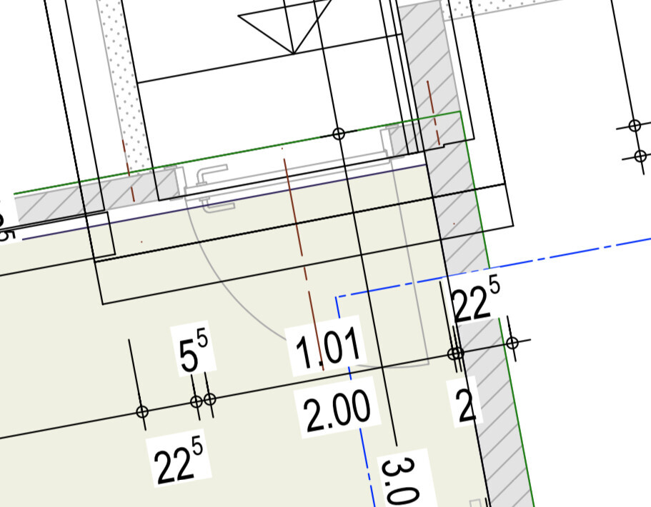

3. The patio door cannot be opened to 90°—or only with force. This is because the door’s hinge side is directly adjacent to a wall, and for the upper hinge, a recess was even milled into the wall to make space. So, I’m not sure whether the door or the wall was incorrectly installed. I have marked this area in the attached photo—you can clearly see that the gap between the bottom hinge and the wall is larger than at the top hinge, which is also why the door cannot open fully to 90°.

For picture 2, the entire opening seems a bit undersized... the window installer should have been more careful when measuring. Have you measured the opening yourself? What do the plans say about the width? Also, won’t the door handle hit the wall???Unfortunately, I didn’t measure on site. However, I just noticed that the door in the plans opens outward, not inward :-) Apart from that, there is enough space in the plans. (see attachment) — thanks again for the tip.

3. The patio door does not open 90°. Apart from the fact that the stair ramp leading to this exit does not look like new construction to me at all: it seems some fools ordered the window door at the external frame dimension identical to the rough opening. I don’t even want to imagine how much chipping had to be done to fit it. What does the planner do for a living?

Sure, picture will follow. Aha, that’s what I thought: segmental arch, not a semicircular arch. But even the close-up didn’t make that clear. Isn’t it also installed the “wrong way round”?
The marks from scraping when opening are probably also the result of incorrect order measurements. This happens quite often: the window manufacturer receives floor plans and then offers windows based on those. The “little helpers” regularly forget to subtract about 3 cm (1.2 inches) from the opening size (which only works if the rough opening—regarding size, plumb, and angle—is precisely true). During installation, this leads to a chisel mess that the plasterer then has to cover up.
