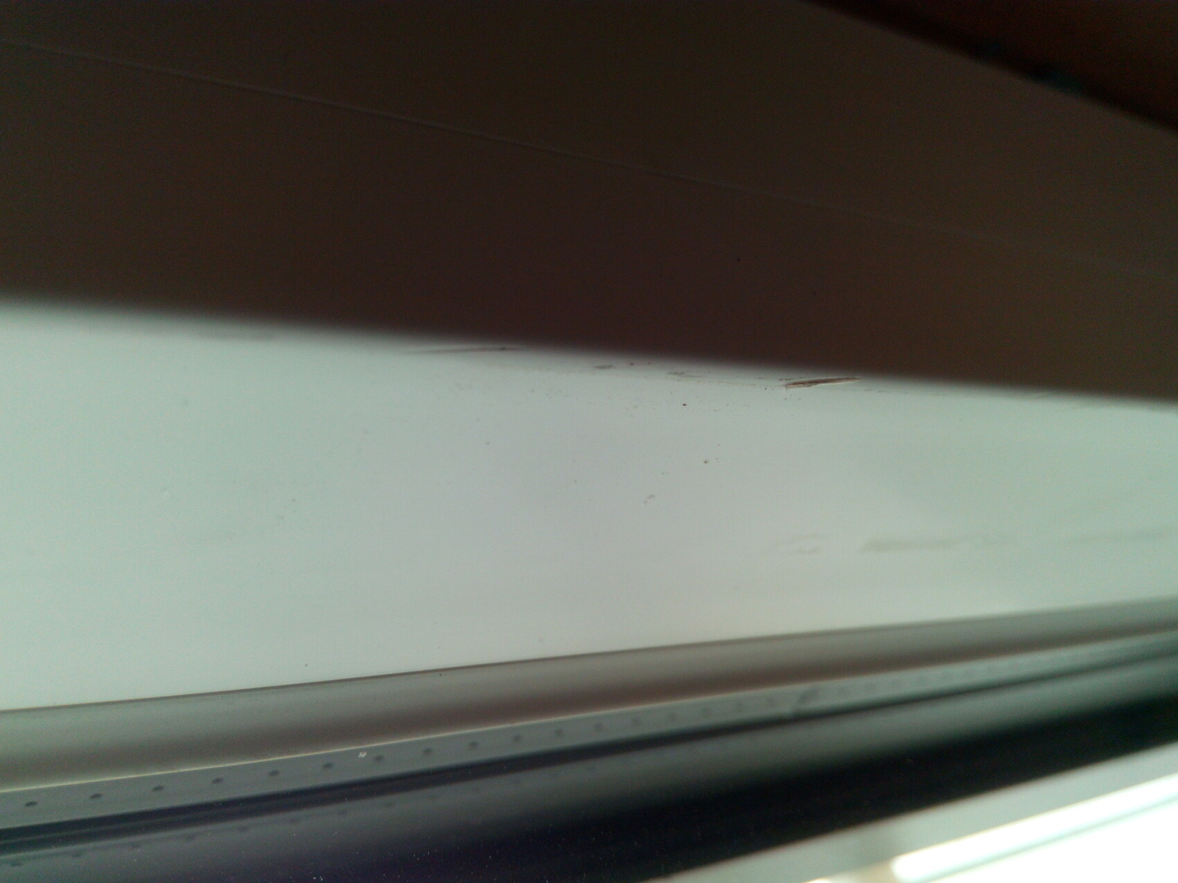

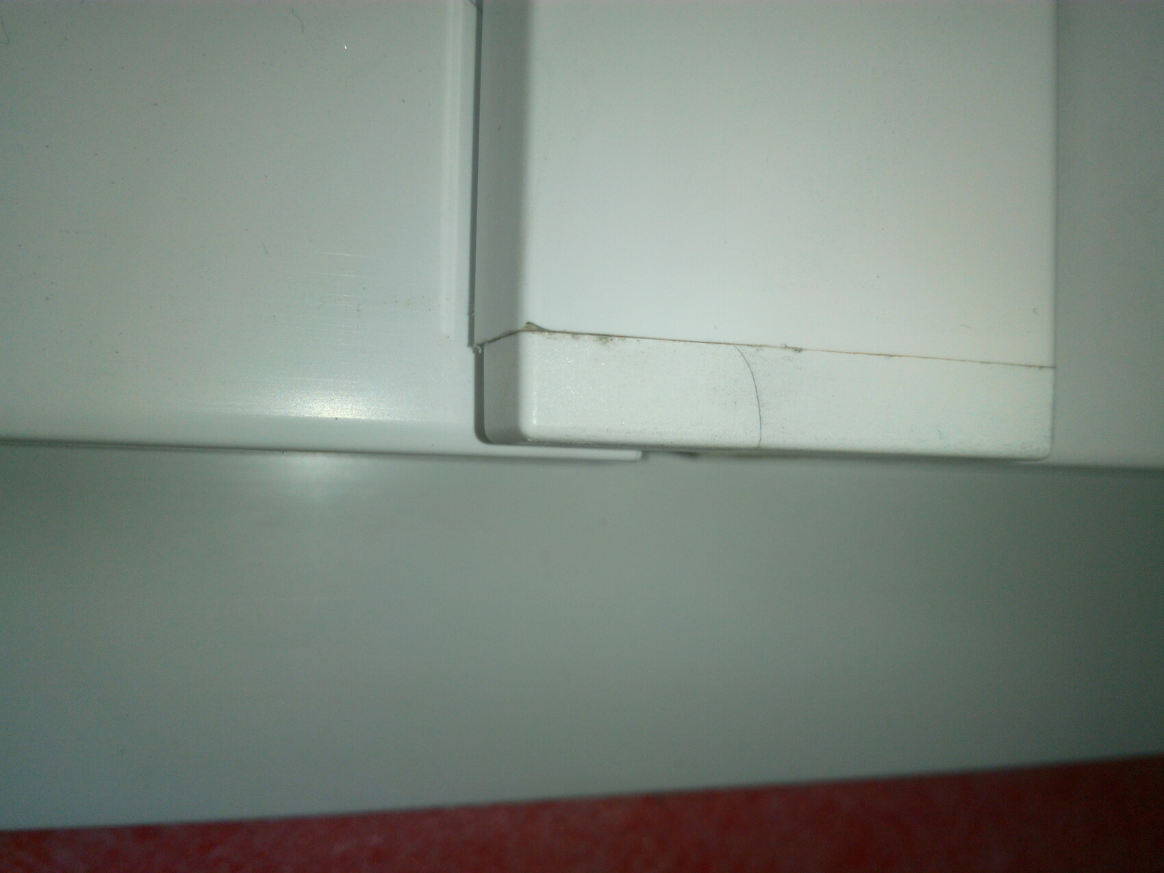

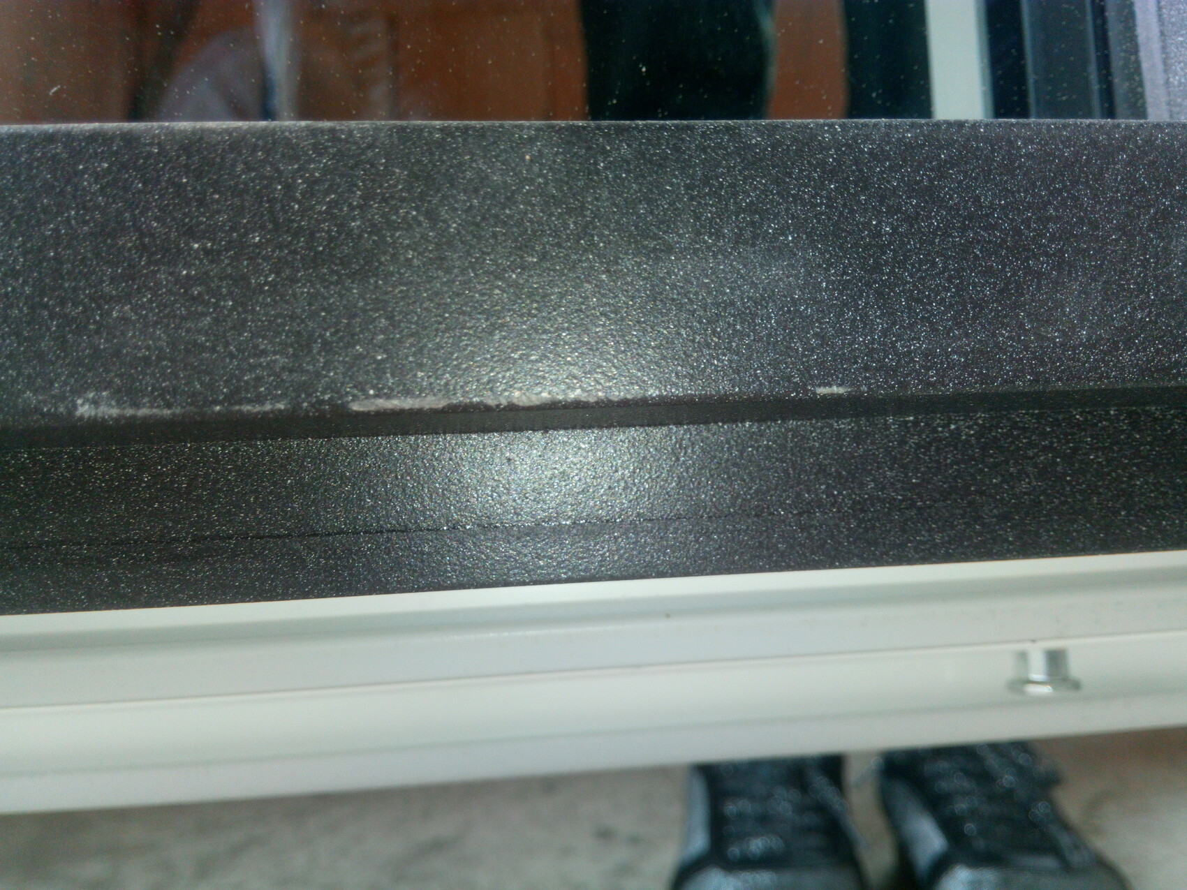

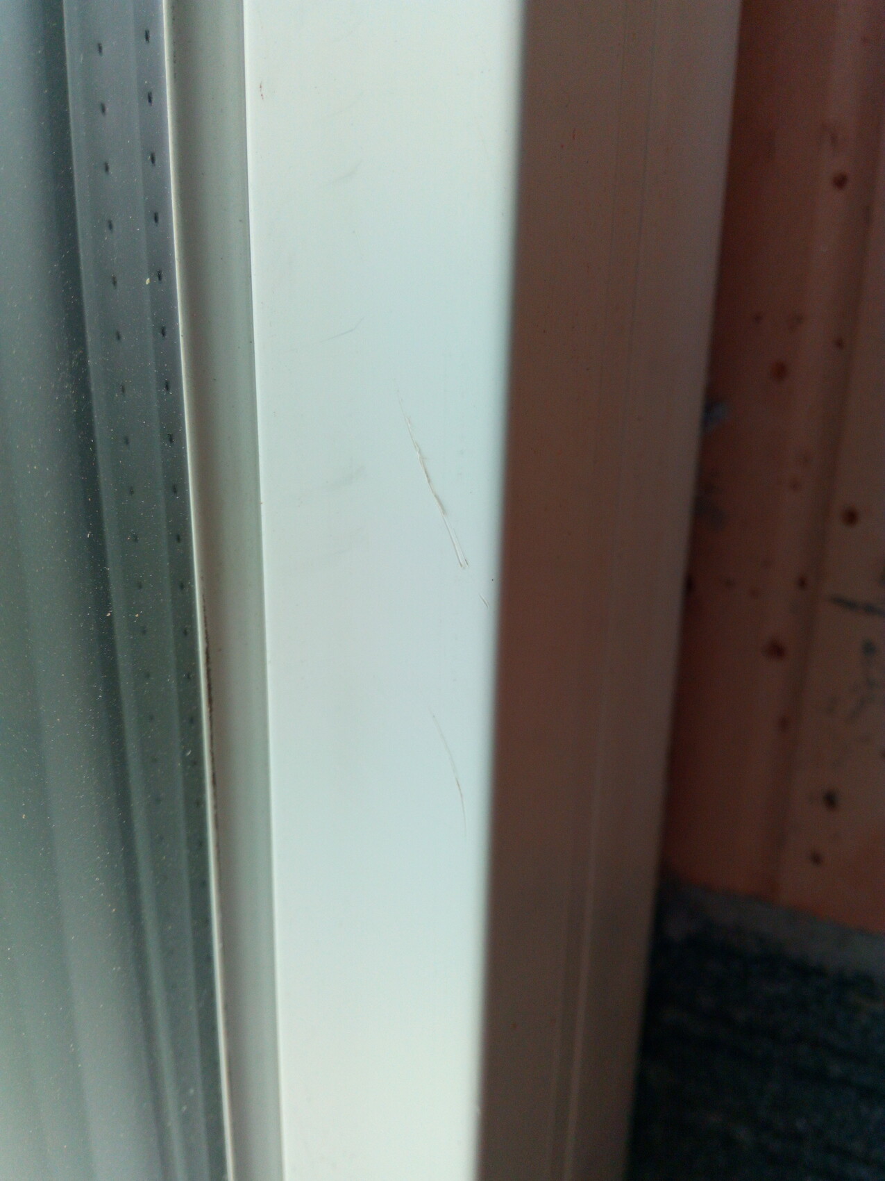

Unfortunately, during the inspection for the electrical installation, we noticed that nearly all the windows have mechanical damage both on the inside plastic and the exterior aluminum cladding, in the form of scratches and abrasions.

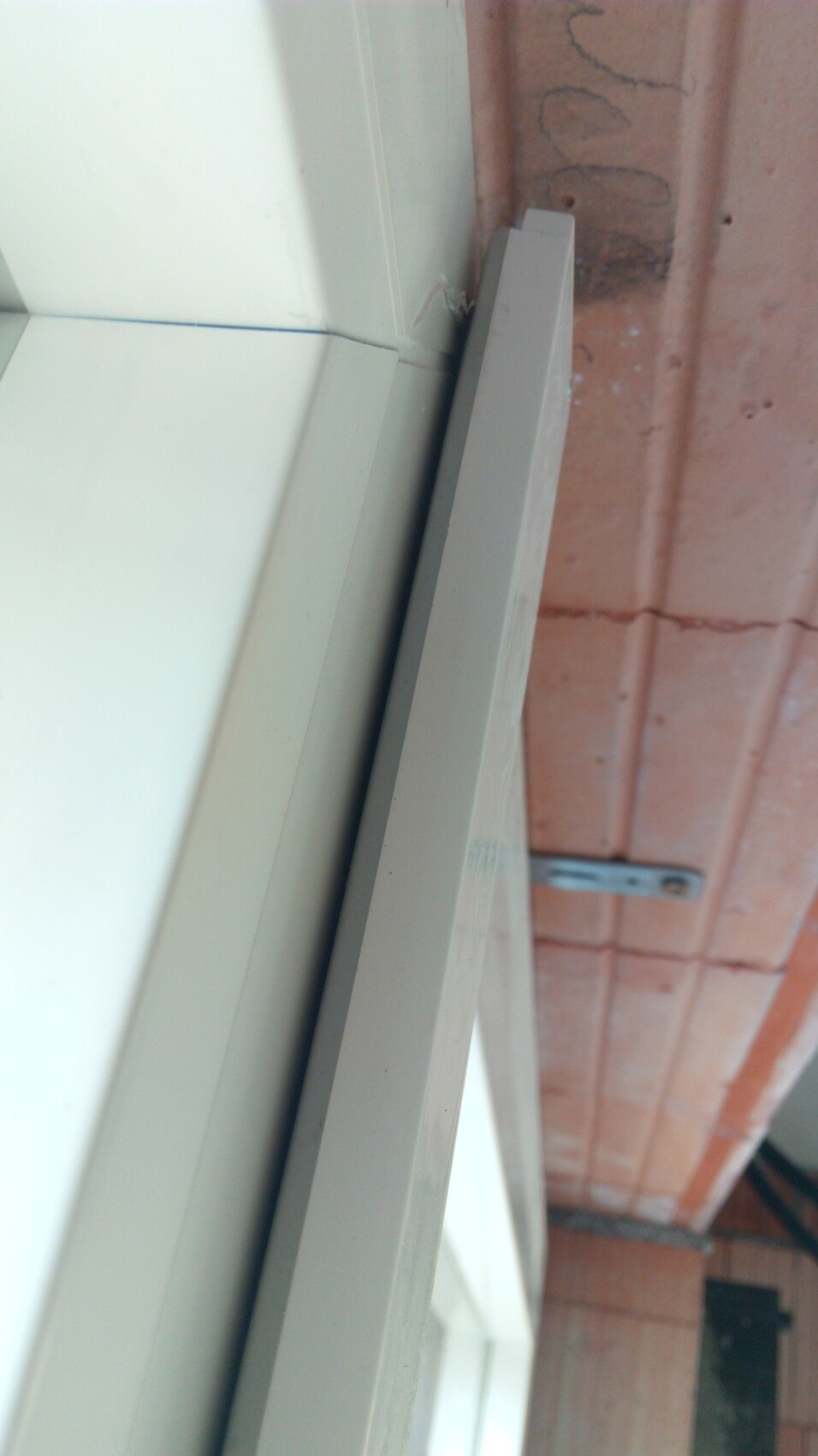

The construction company has unfortunately already removed the protective film inside – seemingly even before installation. At some window sills, it appears as if the window was placed directly on the bare brickwork. On one window, there are two drill holes in the frame that were started in the wrong position.
From various Google searches, I understand that "minor scratches" are generally not considered valid grounds for a complaint. On the other hand, I would say that for a new build, one should still expect new, undamaged materials, right?
Is there a standard or guideline regarding acceptable scratches? We noticed these scratches despite the dust and dirt typical of a building shell.

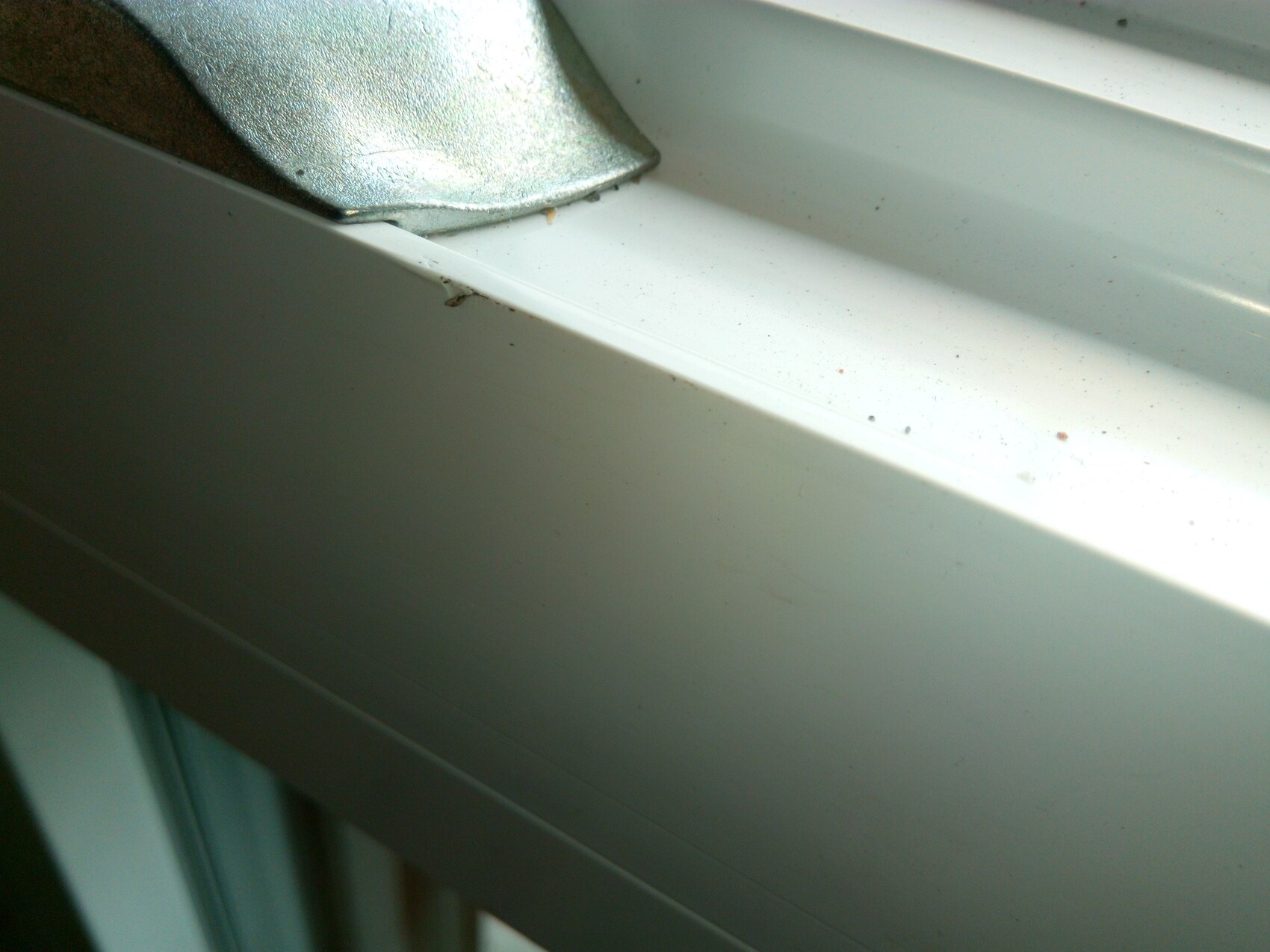

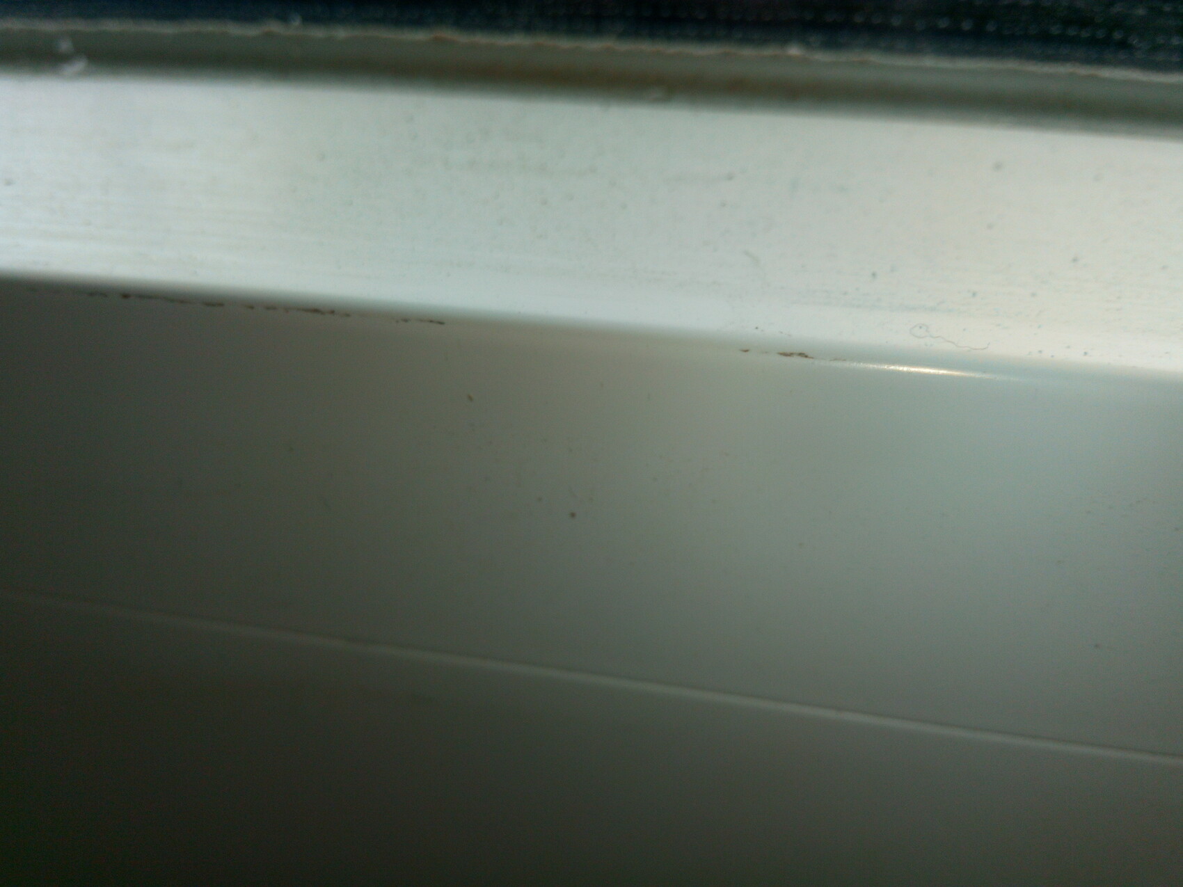

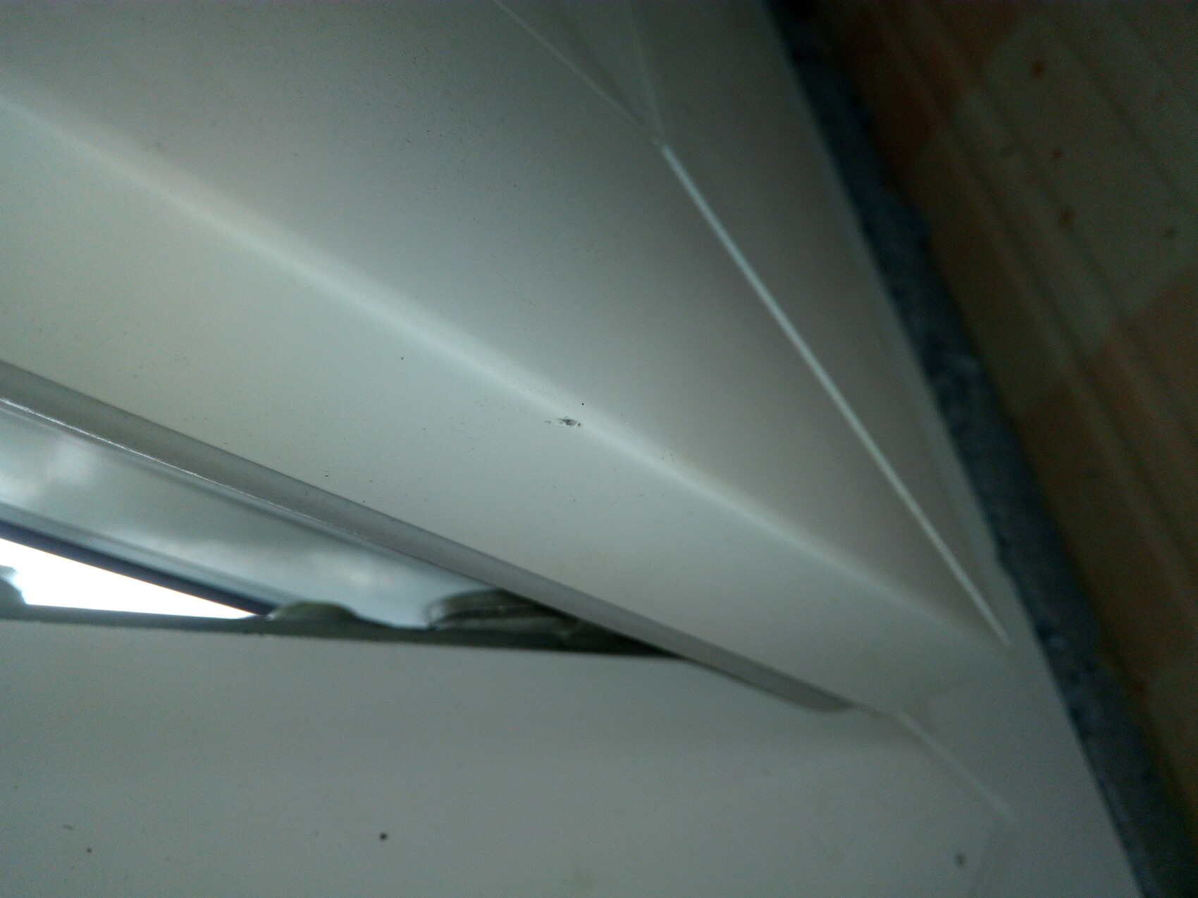

In our case, the installation team apparently handled the windows very roughly. There are scratches and damage to the plastic on many edges, the protective film was apparently removed in some spots using a screwdriver, leaving small indentations.

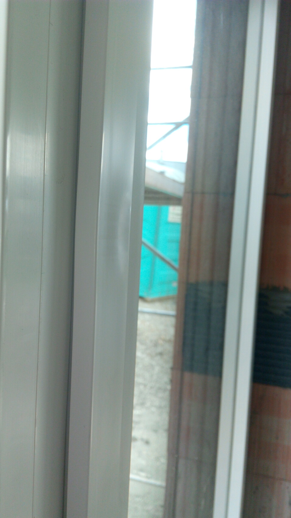

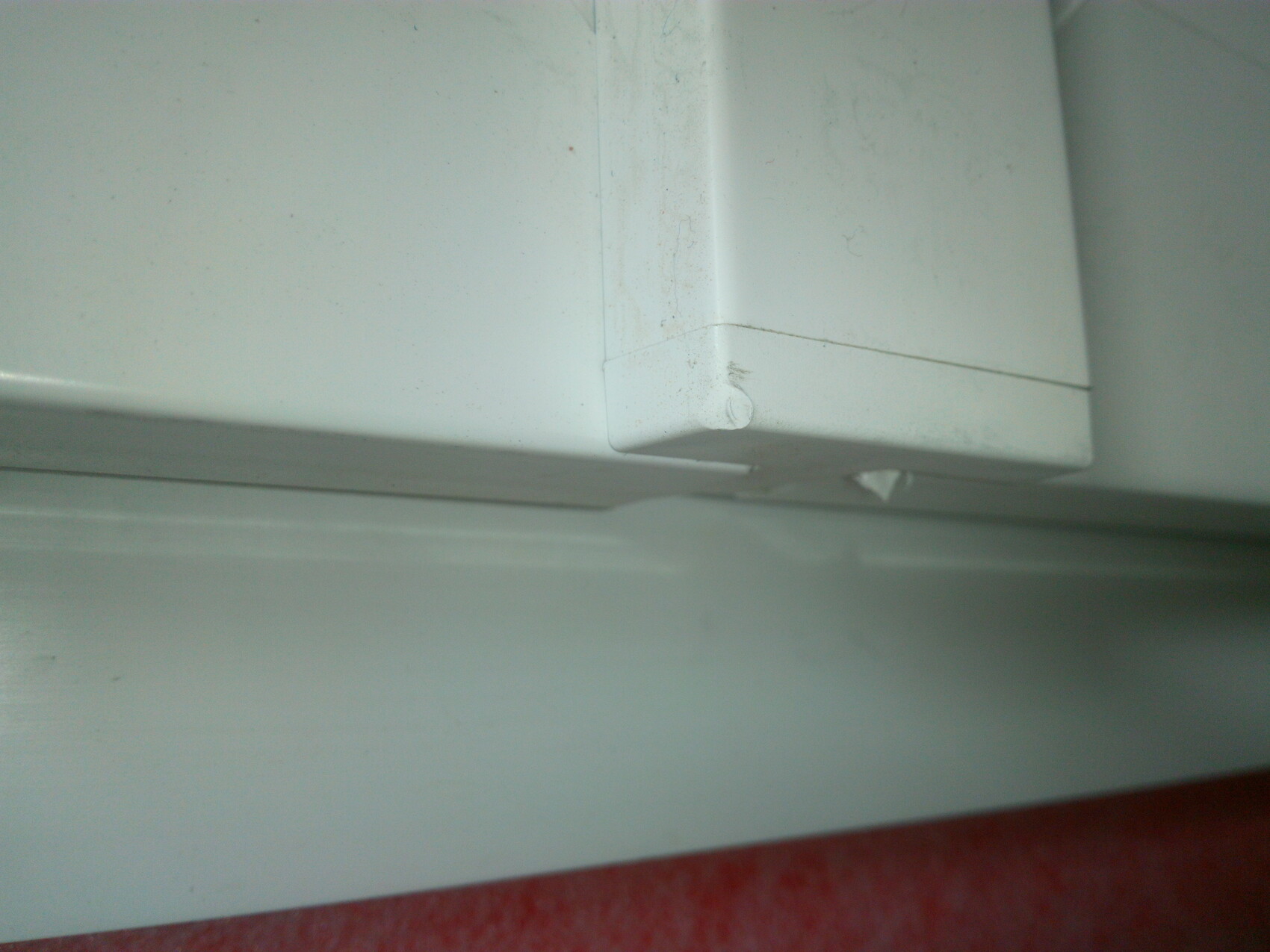

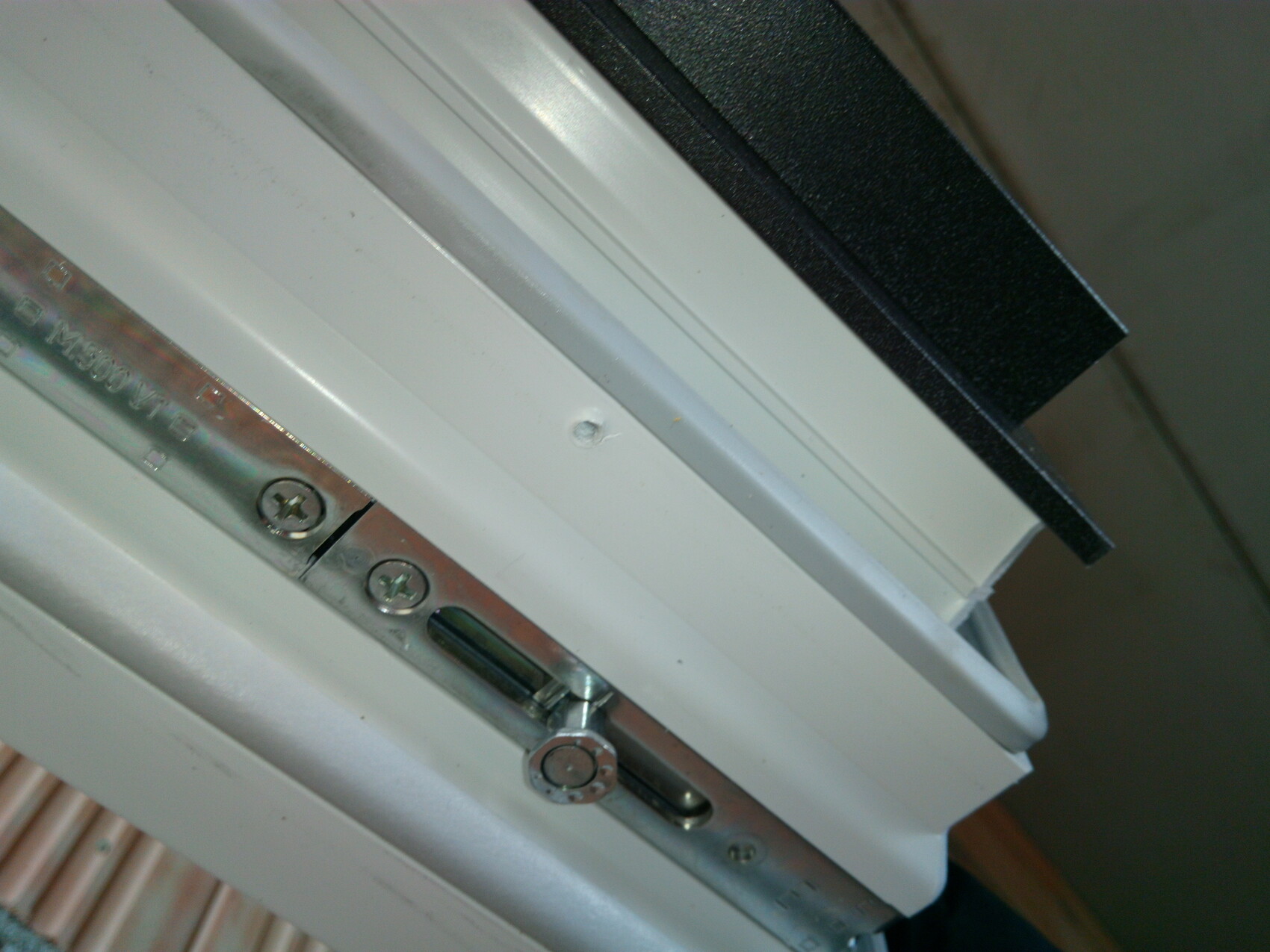

End caps of profiles are broken (which you obviously won’t see from 5 meters (16 feet) away under diffuse light – as the datasheet would like it – of course not…) and on two windows there are messy drill holes below where the glass is seated, supposedly for attaching a transport hook. But how is proper thermal insulation supposed to be achieved there if the air cavity is not sealed?
Does this look like a defect to you?

The question is, first, whether there are objectively any defects, and second, how you can assert your rights.
I dare say: your contracting party will not voluntarily remove all that, dispose of it, and have it reinstalled by a quality company. Keep us updated!
