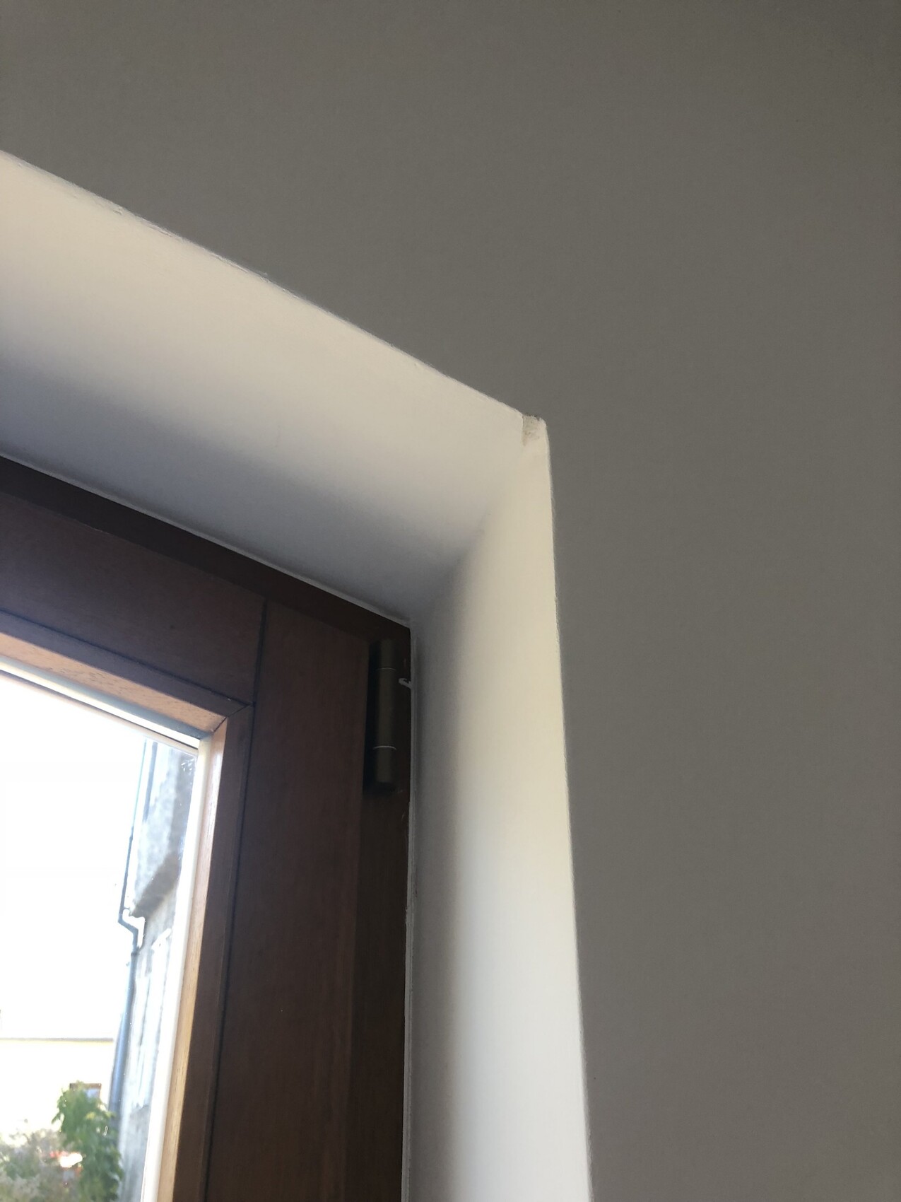

1. The lintel above the arched windows. It is designed so tightly that the windows can open exactly 90°, but the upper corners hit the edge of the lintel. In some places, the masonry is chipped, or there is a small dent in the window frame. I have also added a photo showing the edge of the masonry.

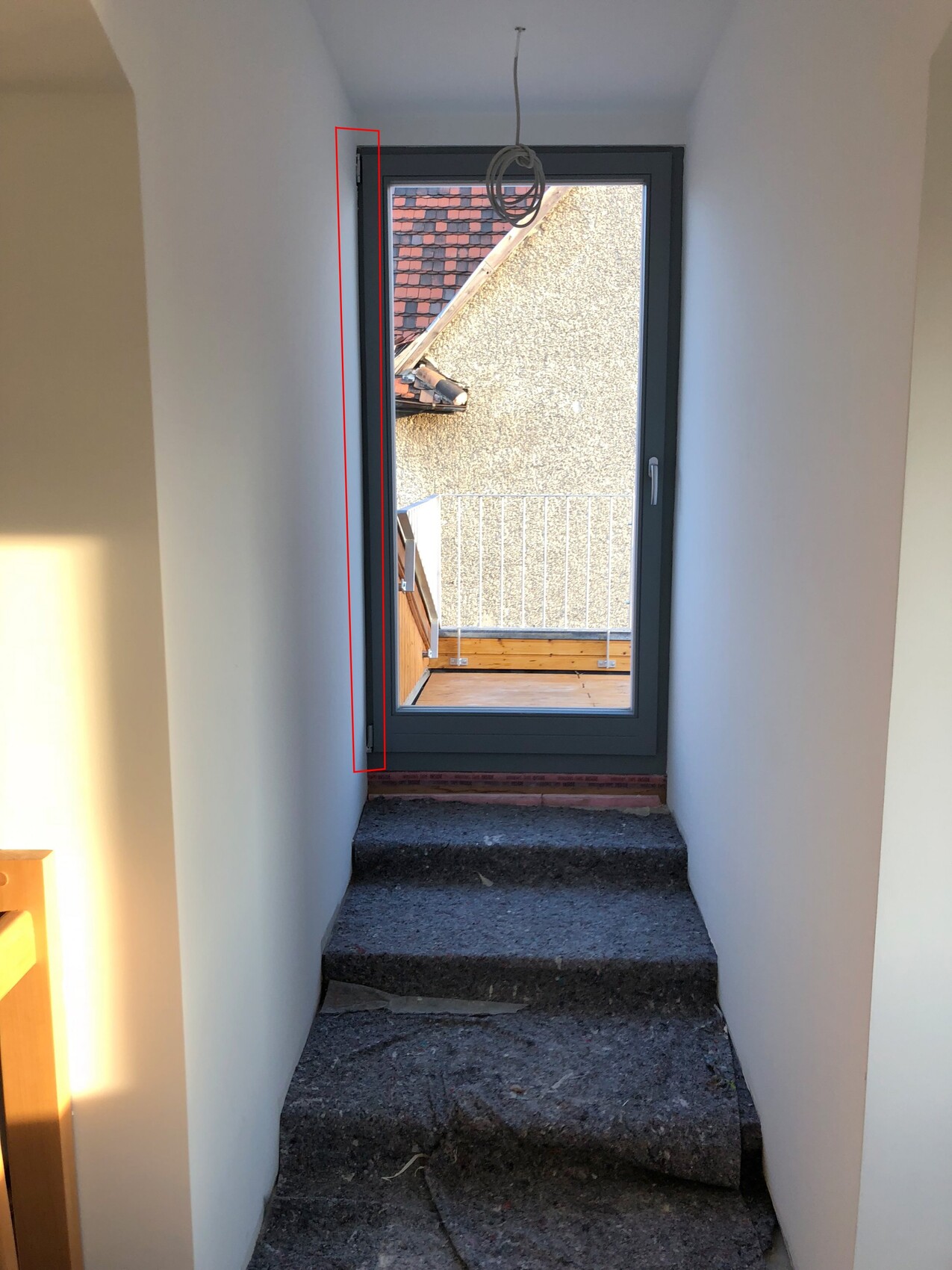

3. The patio door cannot be opened to 90°—or only with force. This is because the door’s hinge side is directly adjacent to a wall, and for the upper hinge, a recess was even milled into the wall to make space. So, I’m not sure whether the door or the wall was incorrectly installed. I have marked this area in the attached photo—you can clearly see that the gap between the bottom hinge and the wall is larger than at the top hinge, which is also why the door cannot open fully to 90°.

In image 1, try placing a square or angle tool against it... then you should quickly see what’s off here... I would have guessed that the front is plastered thicker... but that would be a bit extreme.
In image 2, the entire opening seems a bit tight... the window installer should have been more careful when measuring. Have you re-measured the opening? What do the plans say about the width? Also, the door handle will hit the wall, won’t it???

Mottenhausen16 Oct 2018 17:32The lintel probably did not bend; it is likely gypsum plaster.
