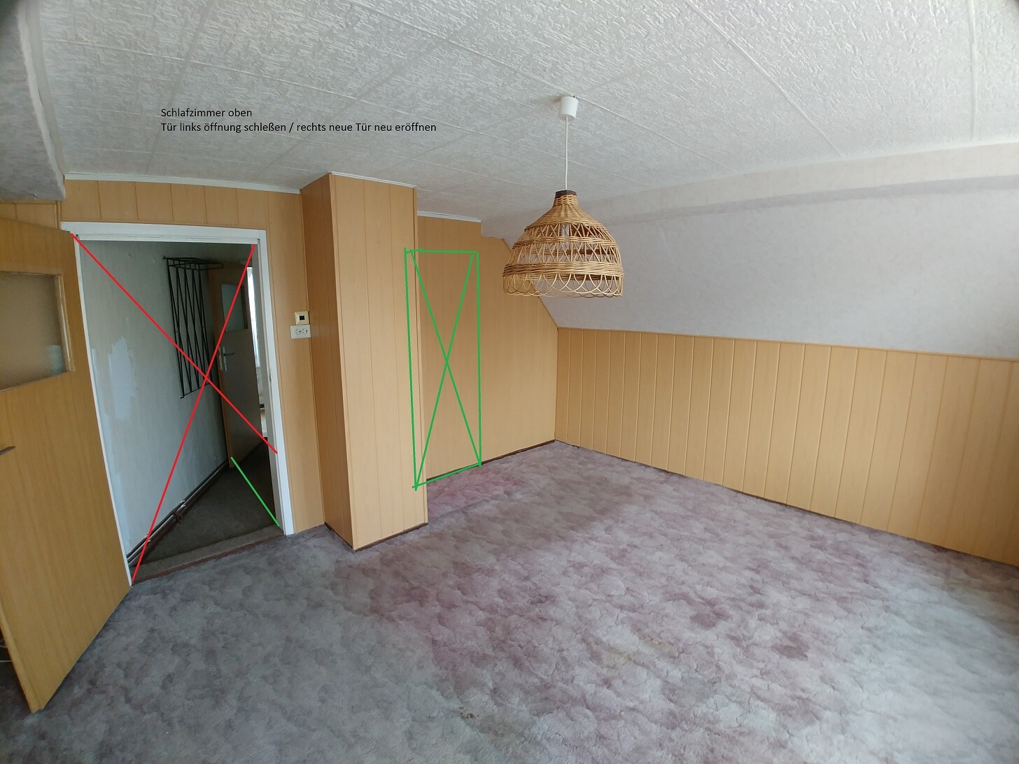

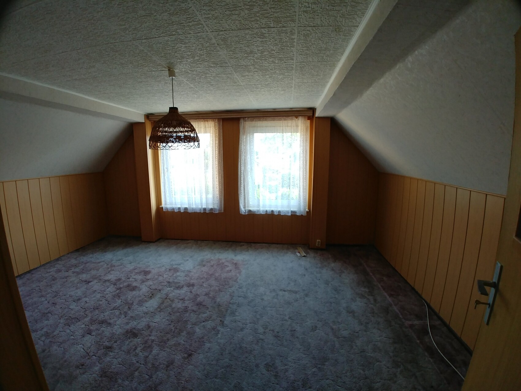

I have another question for the experts: the bedroom on the upper floor faces directly south with the current two windows. Do you think it would be beneficial to add a roof window (skylight) on the east or west side as well?
I am also considering incorporating the floor above into the room and exposing the ceiling beams within the space.
SebastianDr schrieb:
Do you think it makes sense to install an additional skylight facing east or west?

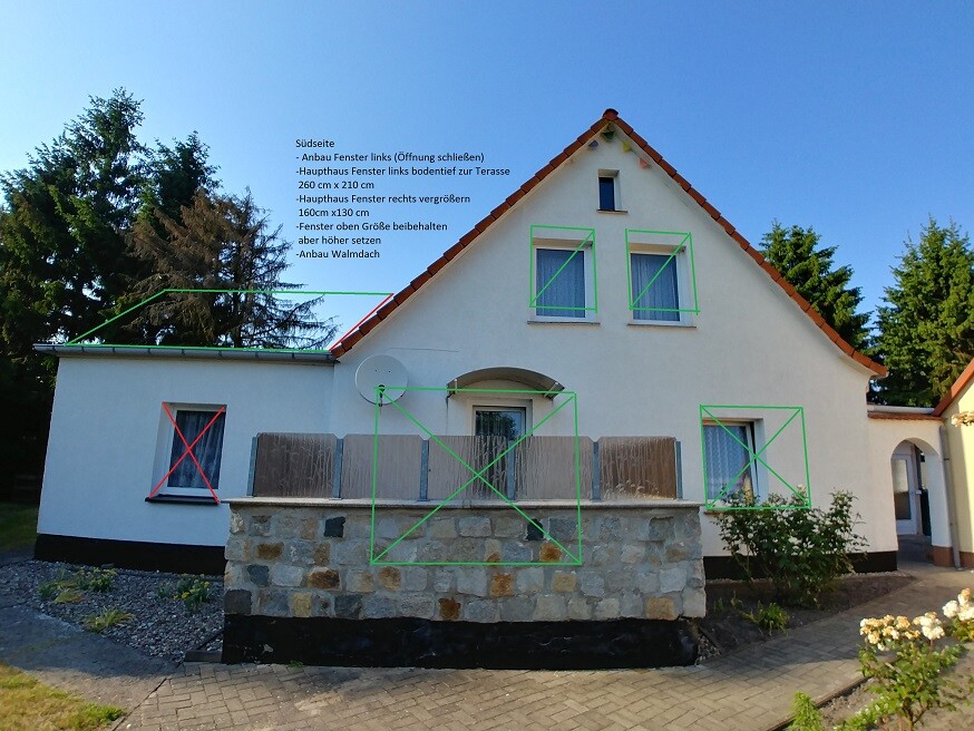

I am more inclined to incorporate the floor above into the room and expose the ceiling beams. Then leave it at that, and while you’re at it, make use of the top window as well. Otherwise, based on my assessment of the house’s structure, raising the gable windows as shown in the facade photo does not appear to be feasible without considerable effort.There is still quite a bit of investigation needed to clarify the evolved as-built condition; this will likely result in several adjustments to the original plans. It will become a beautiful and very unique home for the family, but in several respects quite different from what was initially expected.
